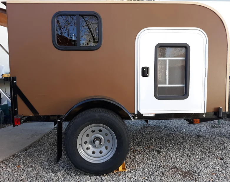

The curved front is 1/8" Baltic Birch that comes in 5'x5' sheets. It was perfect for a 5' wide trailer and it's the only thing I could find that I could bend around that 18" radius. I did two layers, though, with lots of glue between them. It's super strong and stiff.
That white panel on the front is a piece of 1/8" fiberglass reinforced panel. It's there to act as a rock guard, although, once I had attached the cargo box I wasn't sure that I really needed to have added that.
I don't know what it weighs now. I'm hoping to put it on a scale once it's finished.

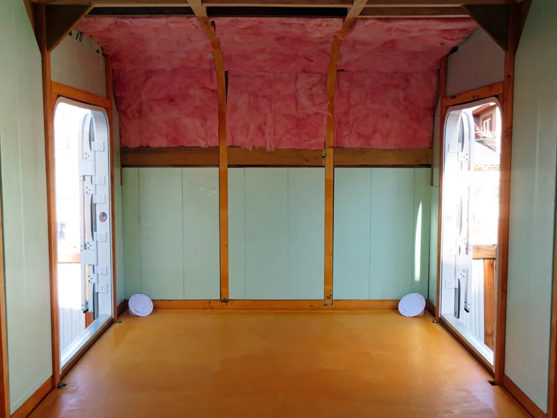

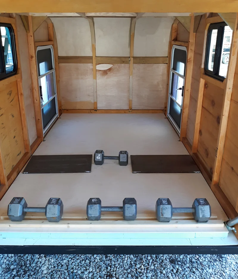

Mud flaps trimmed to size and installed. Wood floor installed; seams glued and curing. Final layer on the floor will be a low pile indoor/outdoor carpet of some kind. I'll also put deck sealer on the wood floor before I put down the carpet.

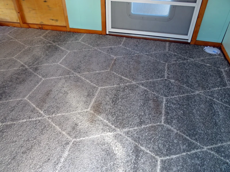

Installed the carpet:

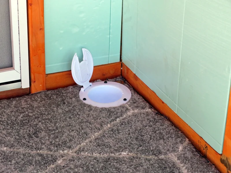

Finished the floor vents. There is one in each front corner. This will allow us to get fresh air right by our heads when we're sleeping, and also give us a way to bring in an electrical cord or a propane hose for a Mr. Buddy heater:

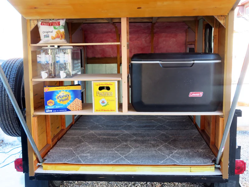

And I finished the shelves in the back. My wife laughed at me when she came out and caught me measuring the height of a beer bottle:

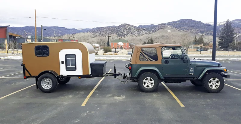

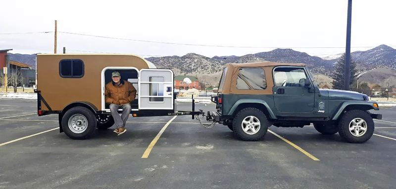

Hitched it to the TJ for the first time today and took it to a level parking lot to adjust the hitch height.
The camper is the exact same height and width as the TJ and has the same ground clearance under the axle as the TJ.
My son and I are planning to pull it up into the mountains and camp for three days and two nights at the end of January (next weekend). We'll be at about 9,000' elevation. Lots of little details left to do this week to make it comfortable and functional.
