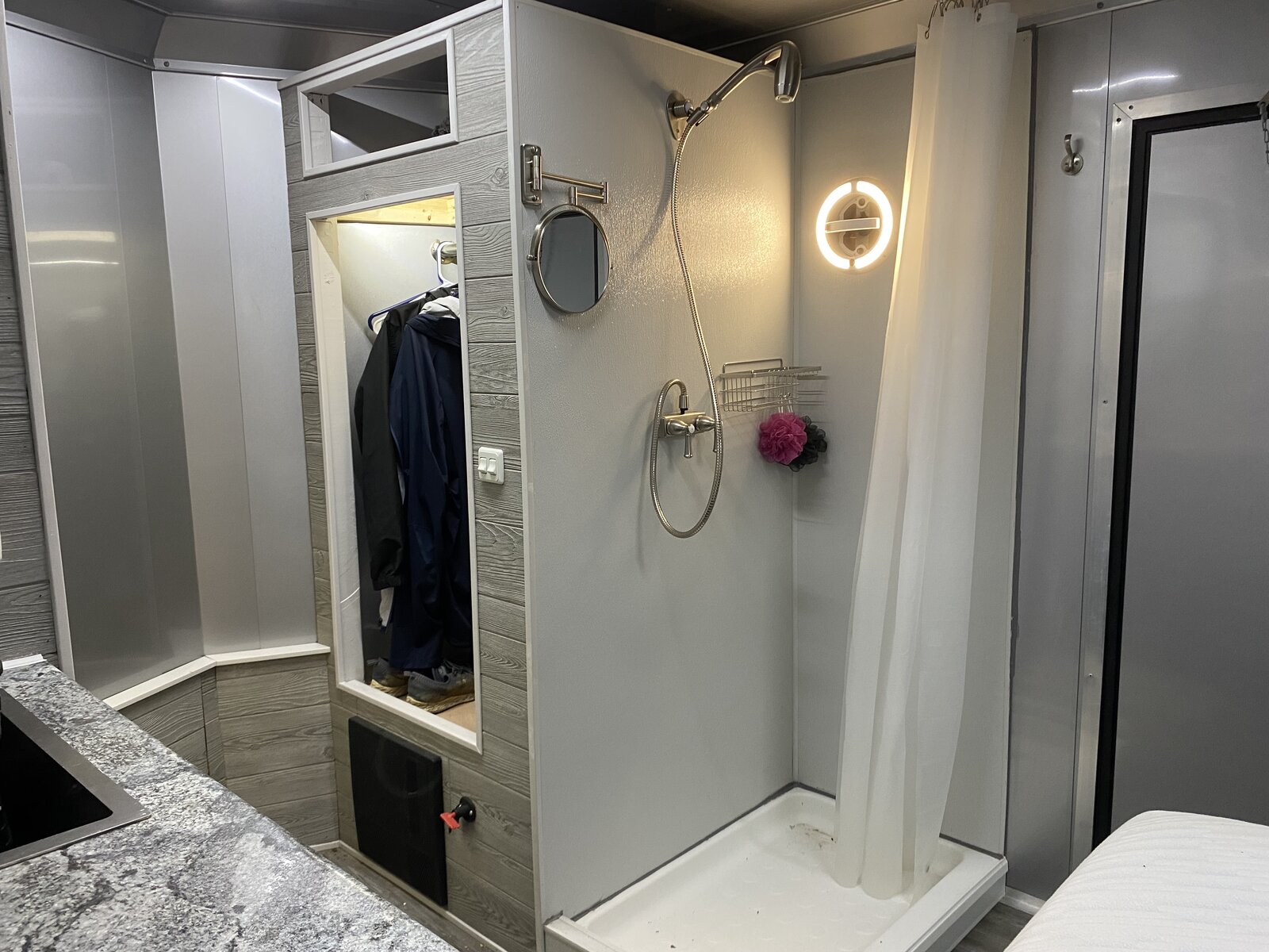

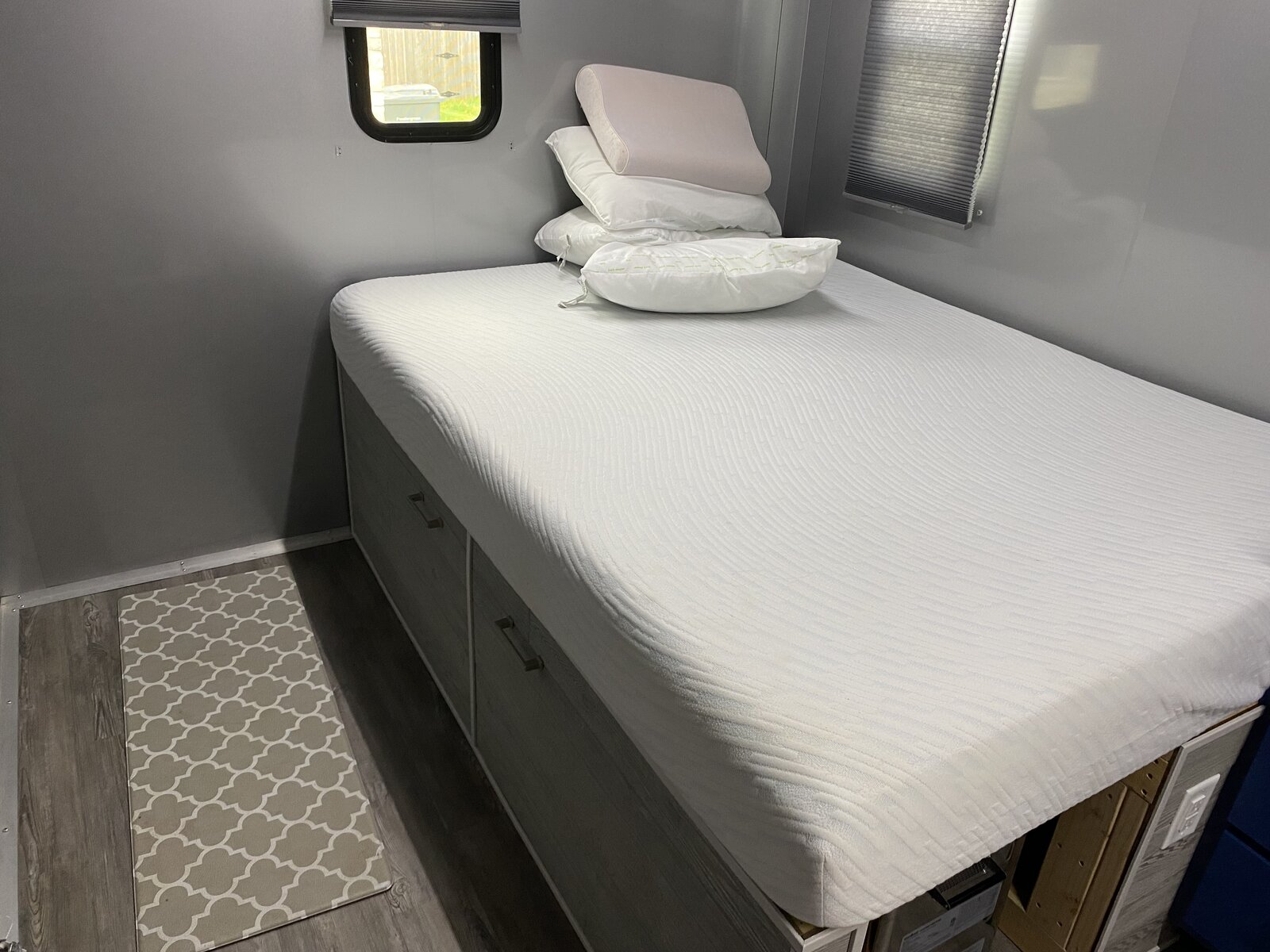

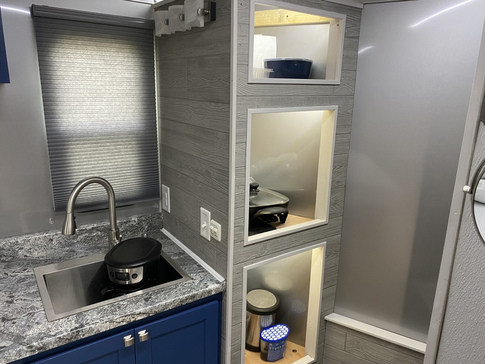

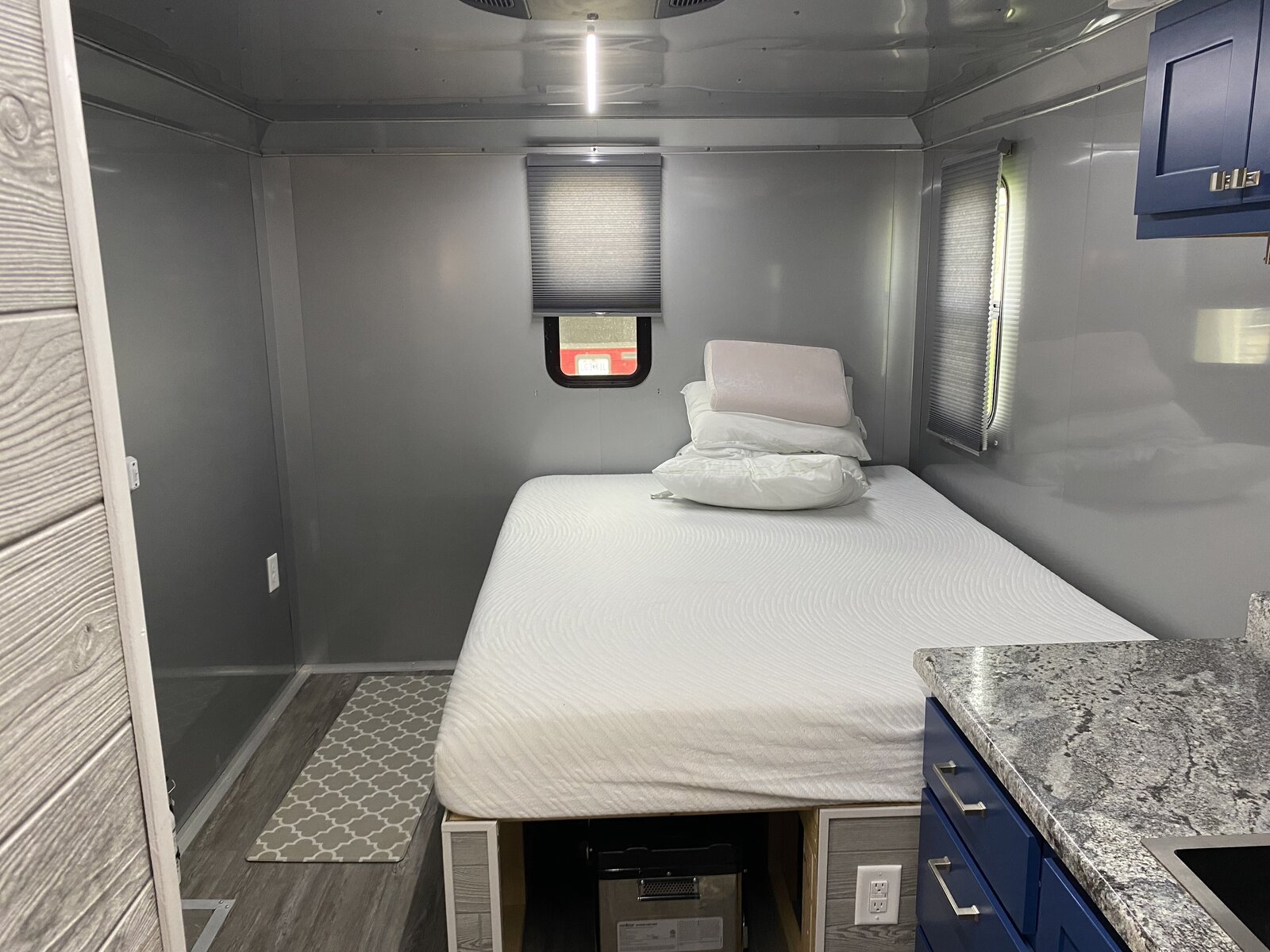

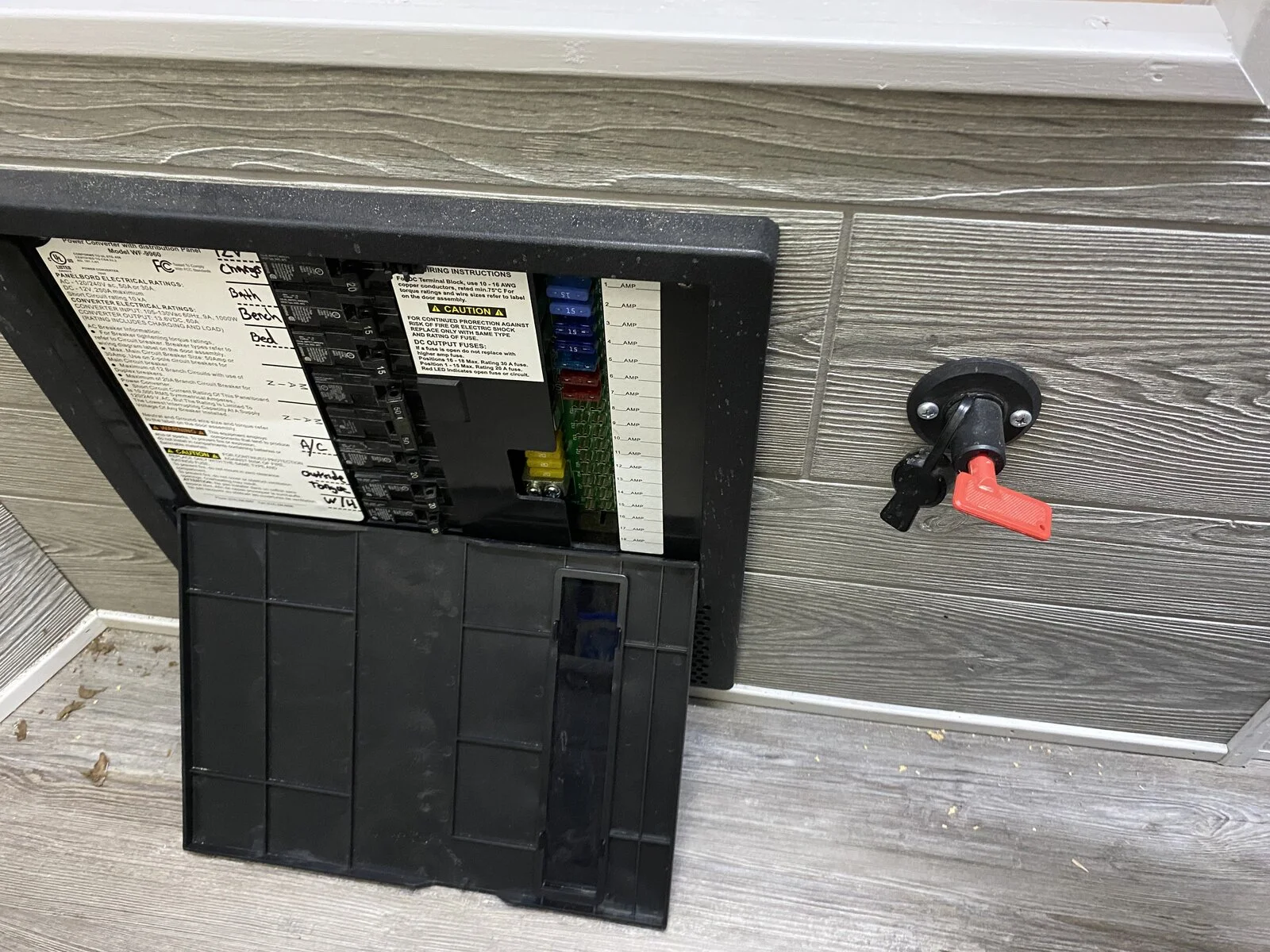

Well, I think its finished. Got the last trim cut and installed. Little filler in the nail holes and some touch up paint. Added a towel hook and a swivel mirror to keep the wife happy. 50 amp 110/12v panel with a main disconnect so I can shut everything off when stored and not draw down the battery. Also disables the electric jack. Long project, but being out of it sick delayed things, that and I like to use it more than work on it. Portable toilet not shown. I remove it when we are not camping. Just need to clean it up before we head out for the weekend.
So far it works great for us. Future project and modification will come. I want to add a cell signal booster, and will need to add tube or heavier steel fenders once the Jeep gets wider. I also want to paint the deck boards now that they have some age. Will wait until its hot and dry and hit them with a couple coats of textured paint for traction and to make the wood last longer.
Its been a fun project, and way cheaper than the other options I could find. I need to take it to the scales now that its complete.
So far it works great for us. Future project and modification will come. I want to add a cell signal booster, and will need to add tube or heavier steel fenders once the Jeep gets wider. Its been a fun project, and way cheaper than the other options I could find. I need to take it to the scales now that its complete.

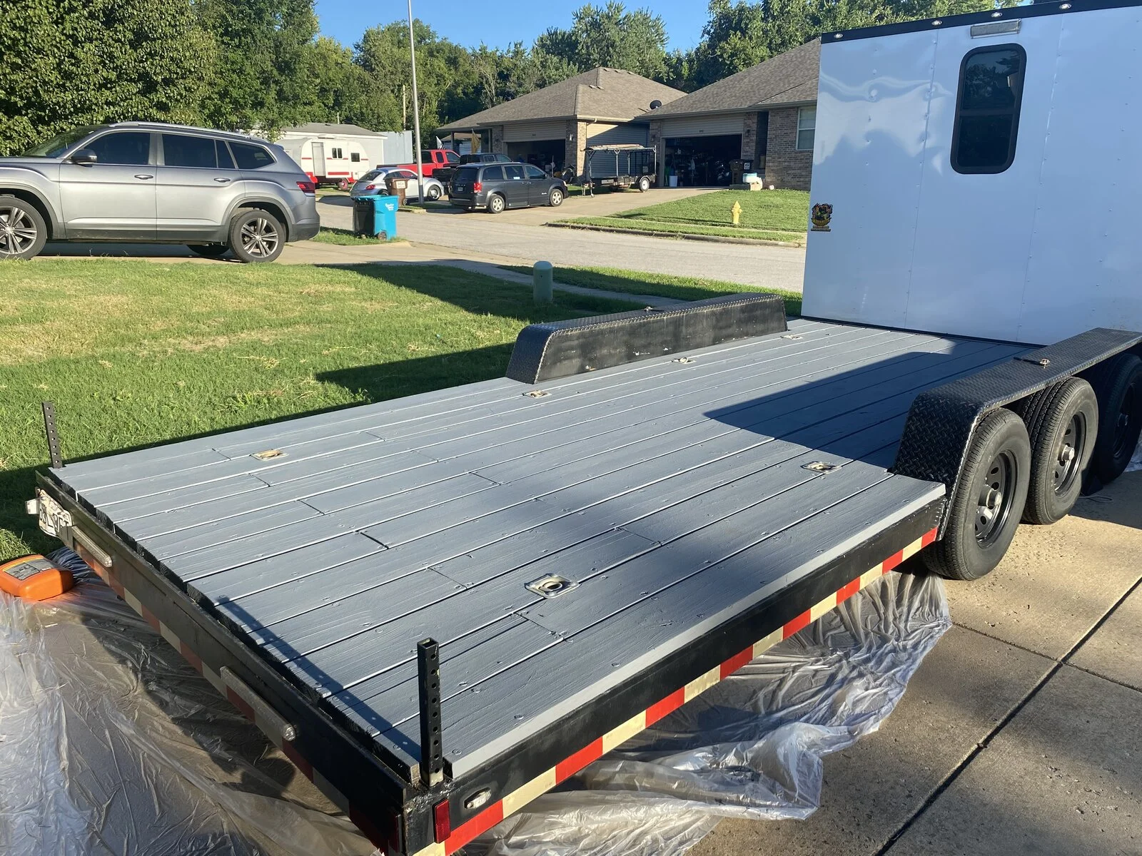

Finally got around to getting a few coats of paint on the trailer deck. Valspar premium with sand in it for traction. Looks at least $120 better to me. Need to give it 24 hours to dry and bolt the box back on.

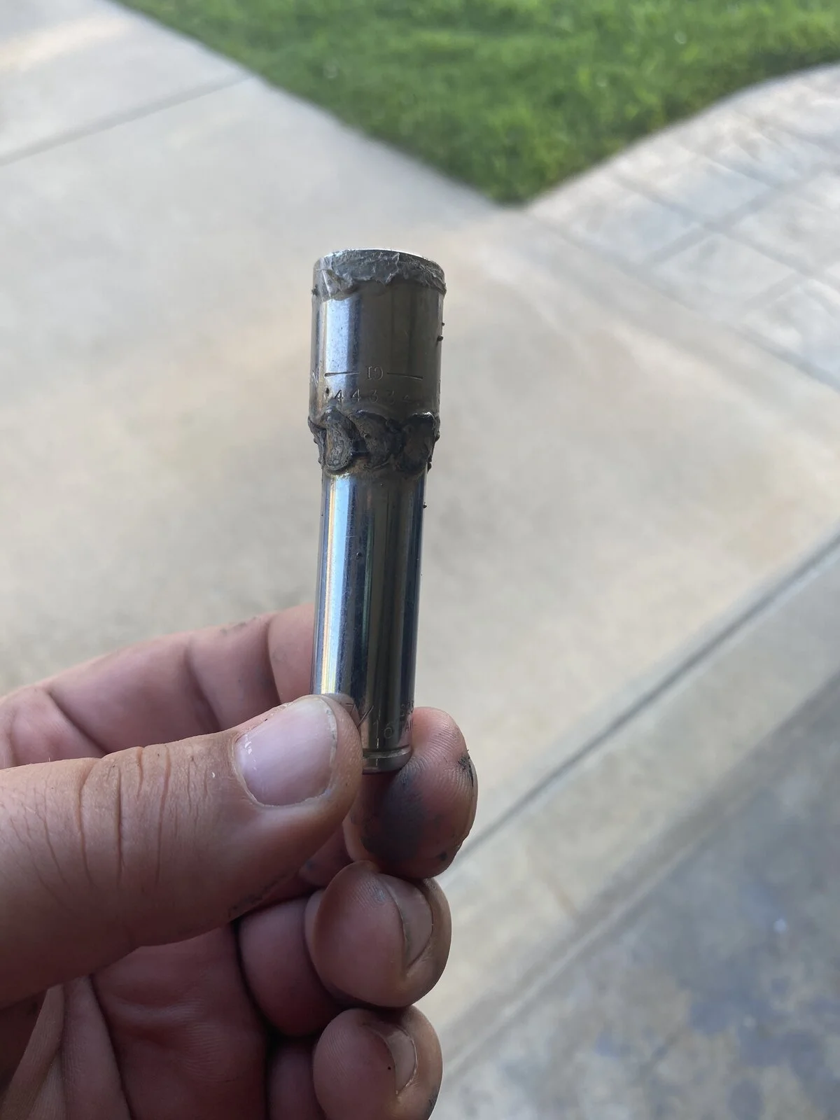

Carriage bolts I used to hold down the box were way to long and it took forever to tighten them with a wrench when I installed it. Wasn’t doing that today so I made a tool. Super deep socket, lol.
