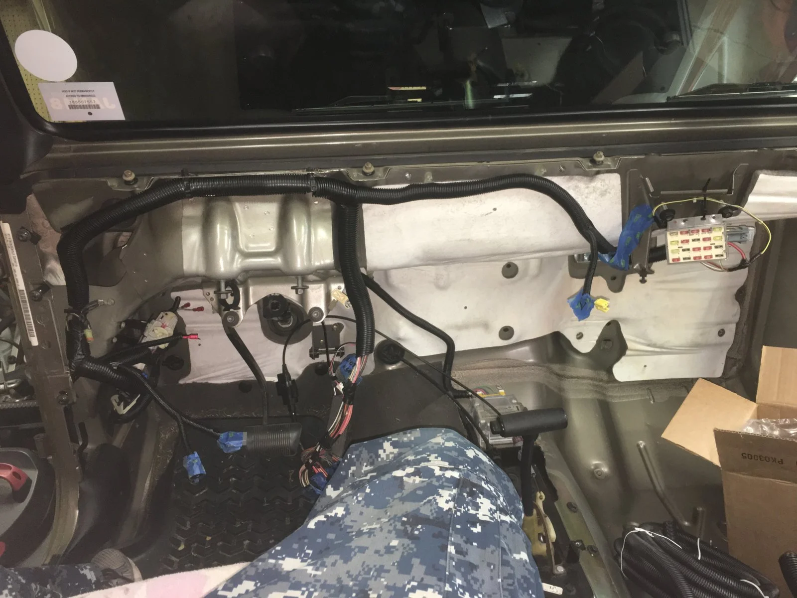

Should I remove the steering column, or just suspend the dash with rope to get the HVAC box out? Don't want to create more work than I have to.
I debated over that too for a bit before I did mine. I ended up removing the dash and it wasn't too bad. I don't recall if your Jeep is and auto or manual, but if it's an auto the brake transmission shift interlock cable threw me off at first. I've got a little info on it in this thread. https://wranglertjforum.com/threads/another-heater-core-replacement-and-a-c-evap-core.15568/
Having the dash off made it easy to access stuff. I added some plastic wire loom to the wiring harness while I had easy access.
This is one of those jobs that can really develop scope bloat on ya. "I'm in there and its a pain in the ass to do, so I might as well do _______."
Good Luck, I don't envy you!
That's the truth.
That cleaned up nicely. Knowing me, I'll probably try to do some wiring clean up as well if time permits. Did you lock the column before removing it so you wouldn't risk effing up the clock spring? Mine is a 5 speed btw, so I hope the shifter won't be in the way.
I did lock it. You shouldn't have the brake transmission shift interlock cable to worry about.
I'd recommend losening the pinch bolt on the steering shaft before rotating the wheel and locking it. It was a pain to access when the head to the bolt was pointing up.
