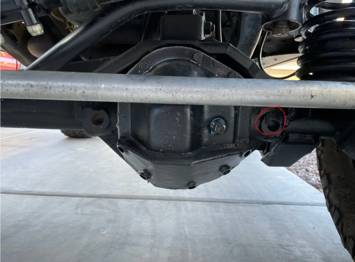

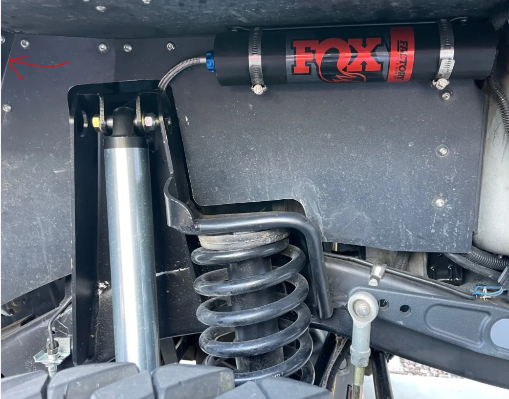

Here's photos of some of the work done.
Front shocks:
Rear shocks:

Barnett diff cover (the old Currie one was getting in the way of things):

Flipped tie-rod and raised saw bar mounts:
For those following along, the clearancing on the diff casting is for the JJ on the track bar. The front of the spring perch was also trimmed to allow the tie rod to clear.
Front shocks:
Rear shocks:

The problem when you do relatively clean work is there isn't much to see. If you parked it across the street when it got here and then when he picked it up, there are very little visual differences. In other words, it doesn't look like we touched it.

Chris told me that he wasn't afraid to throw it around corners but I could tell by the sound of the exhaust that he wasn't fully exploring that option and likely due to unfamiliarity with the roads. So, I had him hop in the passenger seat. It was very entertaining when I was doing 65 on the curvy road and then hung the right side tires off the pavement into the rough dirt. He'll have to explain his reaction.

We can fix the body roll it does have, soon I think. Mainly though I would look for you to explain that initial reaction that I sensed when I hung it off in the dirt at that speed.
I am curious how much of a difference that SwayLoc will make. It’s already amazing to drive now, but I’m definitely curious.
My initial reaction to that little off road bit was, “wow, apparently this thing isn’t a terrible Baja racer”. I was surprised at how well it was taking those hits, especially at that speed and with street tire pressure.

At the second little hill climb we did, I almost rolled a TJ on 35's and short arms about 1/3 the way up where the first little small ledge is (you didn't even notice it). We were driving up it like in yours, back started spinning out and moving over to the low side, pushed in the clutch and grabbed 4 high, still was sliding over, had to get it into 4 low and lock it to pull out of it. Yours didn't even spin a tire.
On mine, it's maybe a quarter to half the difference of yours with and without the Antirock. Meaning it is a quite noticable increase in stiffness.
