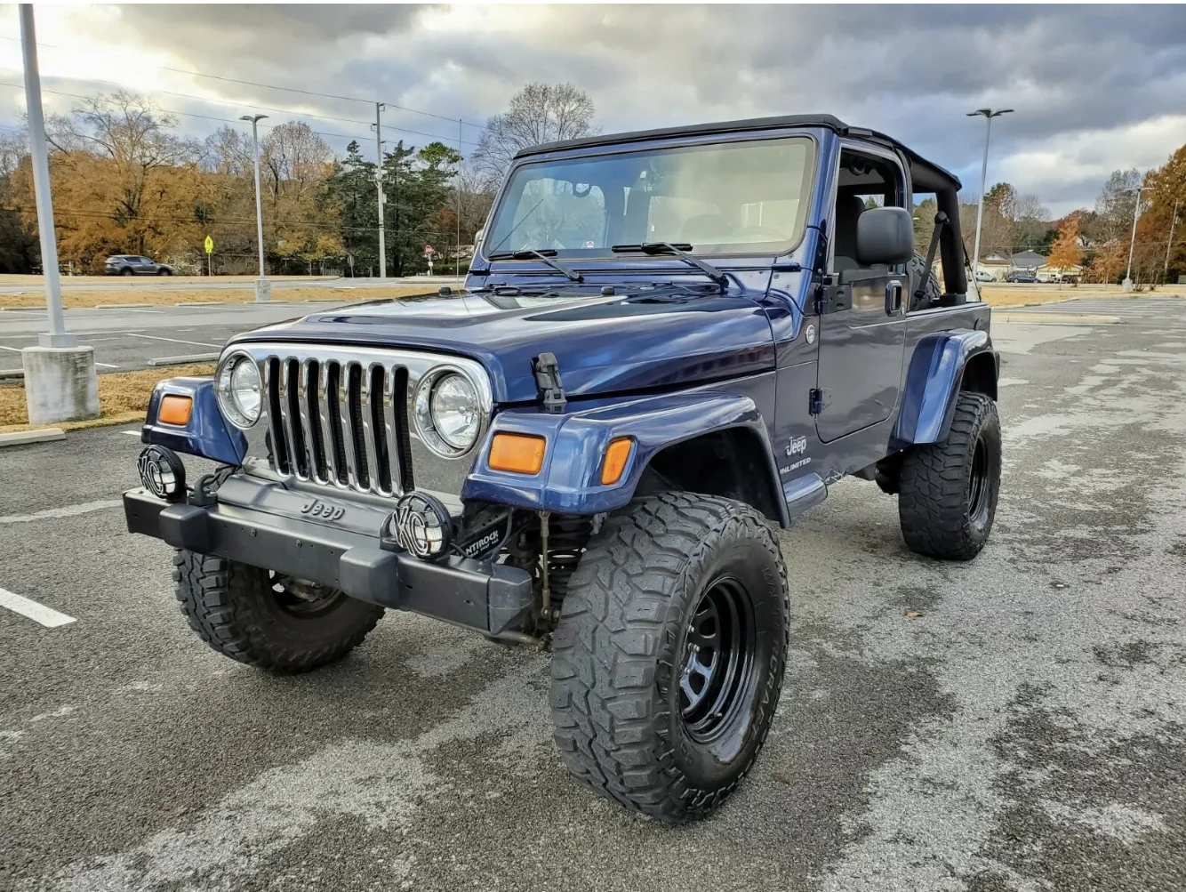

I sold it to @Alex01. I'm just going to run the stock front bumper as I'm going for the stock look. I also like the factory fog lights, but for some reason they never look right on any other bumper than the stock bumper (in my opinion at least).
Stock look works dude! Glad to see you doing a build just for you without any undo pressure. (Even if it's self inflicted)😆
are those factory fog lights or factory style? i also want to keep my stock front bumper, i have stock fogs but i have vision x headlights and it looks silly together, ive been looking for something to swap to that matches.
They are indeed factory fog lights. I have yet to find anything aftermarket that looks good for stock fog light replacements.
Reactions: FJQue
