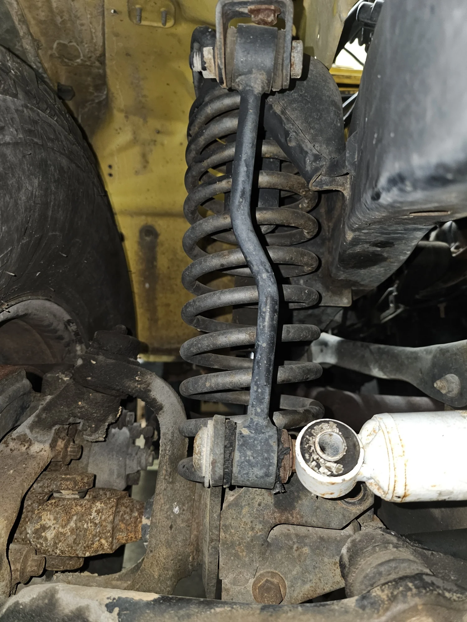

I got my steering stabilizer only to realize there was already one on it. So we took it off and checked it over. It seems to be in good shape. The bushings on the sway bar links, however, look like shit. I thought I could buy more bushings but apparently I need new links. Went to O’Riley’s but they didn’t have any for lifted vehicles. I’m not sure if I should just order some now or wait for the weekend when I plan on doing an assessment of all the steering and suspension components. If these are this bad I assume there’s a chance that something else will need to be replaced as well.

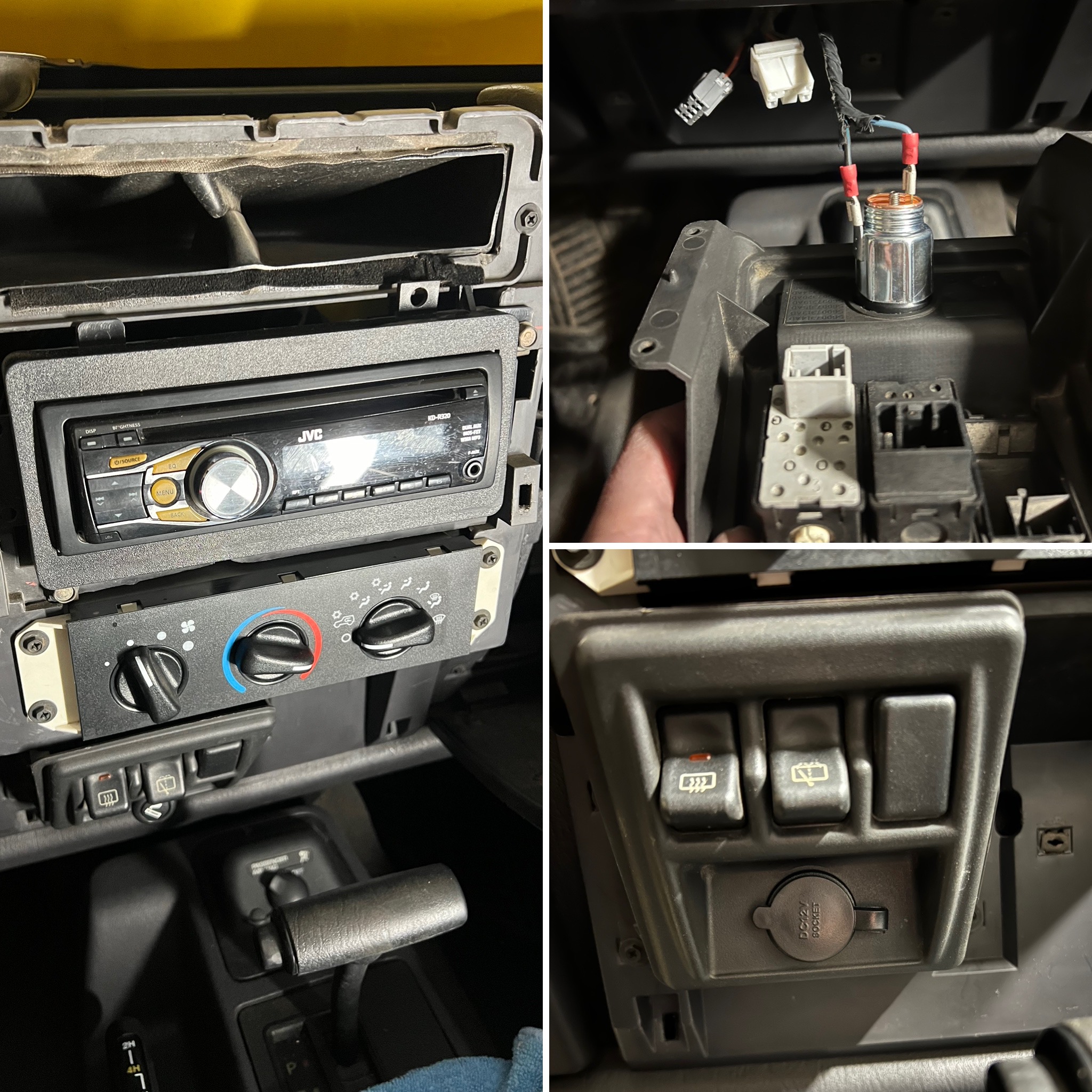

I attempted to put a 12v charging port where my cigarette lighter was and I am 99% sure I did it right! Though I have never done any electrical work in my life. Only to discover that there is no power going to those wires or my back window defrost and wiper switches. I’m putting that one on the back burner for the moment.

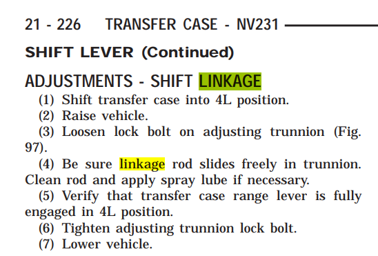

Our little ditch incident made us wonder if our 4WD is working. Guess what? It’s not! Hubs found a pin down there with the linkage (not too familiar with this yet so idk if I’m using the right terminology) that was out of place. He popped it back in and now the lever in the car is much stiffer. I can get it to 4H but it won’t go to N or 4L. Any good threads that will walk me through diagnosing and fixing? There are so many videos and things out there but I have zero background knowledge so its a little overwhelming. He has a video of it on his phone I’ll try and get it in the morning. Oh, I ready about the Savvy cable shifter kit - seems like it might be the best option to fix my problem? But is there anything else o should be looking at?
