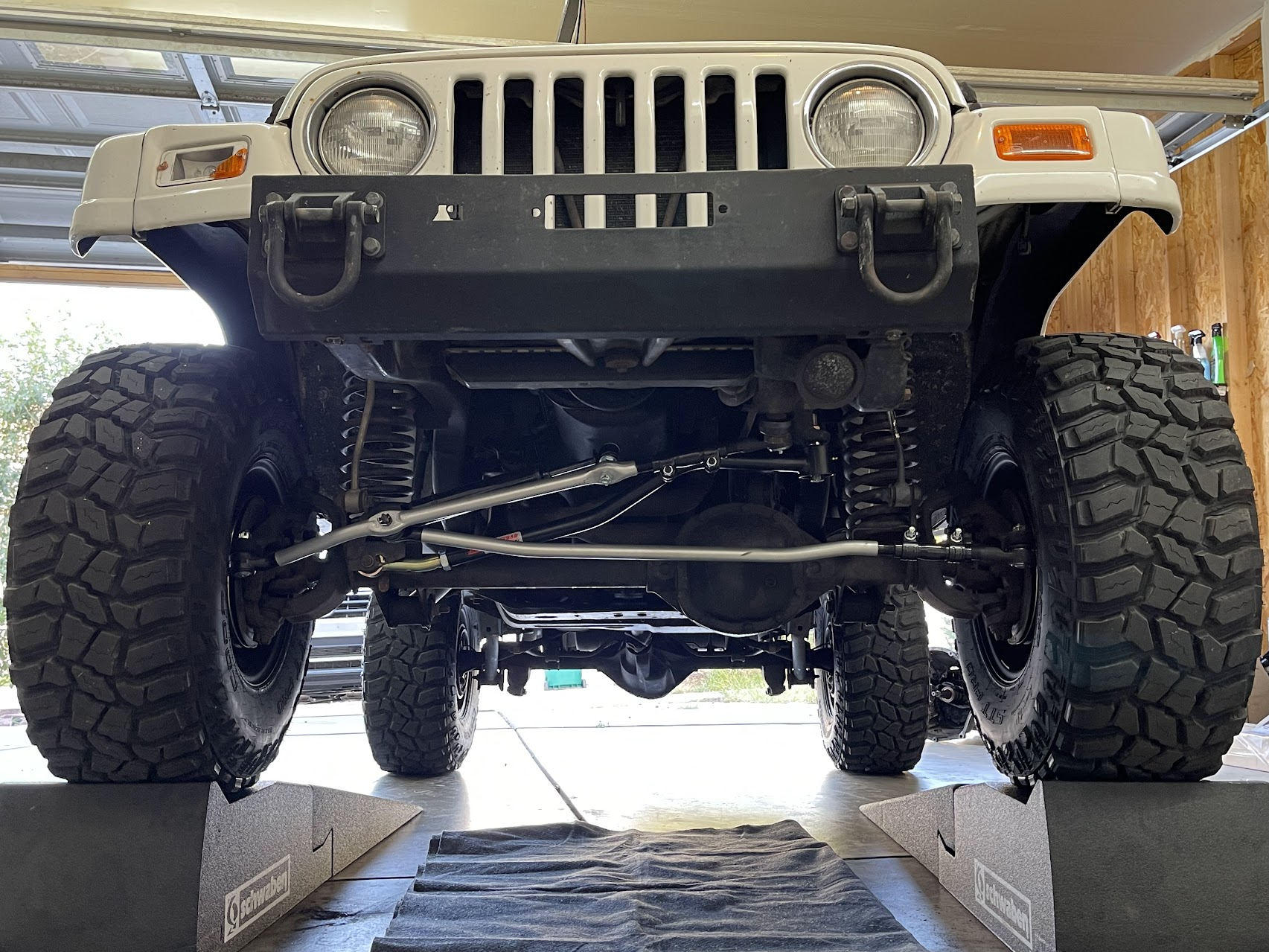

Here's a picture of when I did the same conversion on mine. You can save, to make sure everything is installed back properly.
