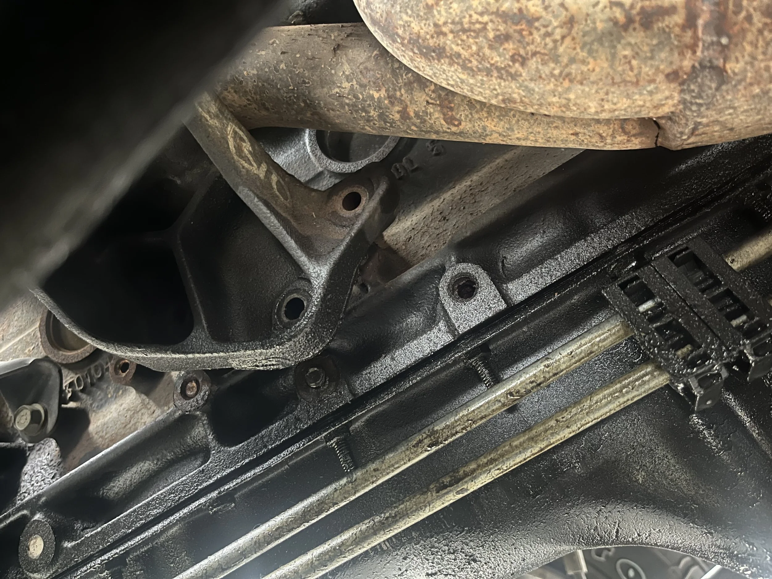

Well.. turns out my motor mount bracket is completely detached from the engine block on the driver’s side. Looks like two bolts sheered off. The third is missing. Doesn’t appear to be any damage to the block itself. If I’m able to remove those two sheered bolts and reinstall the bracket, does anyone know what size bolts I need?
View attachment 670501Well.. turns out my motor mount bracket is completely detached from the engine block on the driver’s side. Looks like two bolts sheered off. The third is missing. Doesn’t appear to be any damage to the block itself. If I’m able to remove those two sheered bolts and reinstall the bracket, does anyone know what size bolts I need?

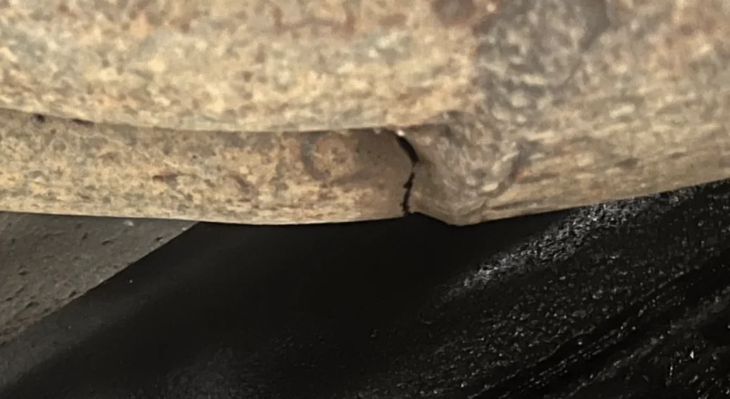

You have a pretty nasty crack in your exhaust manifold too.
