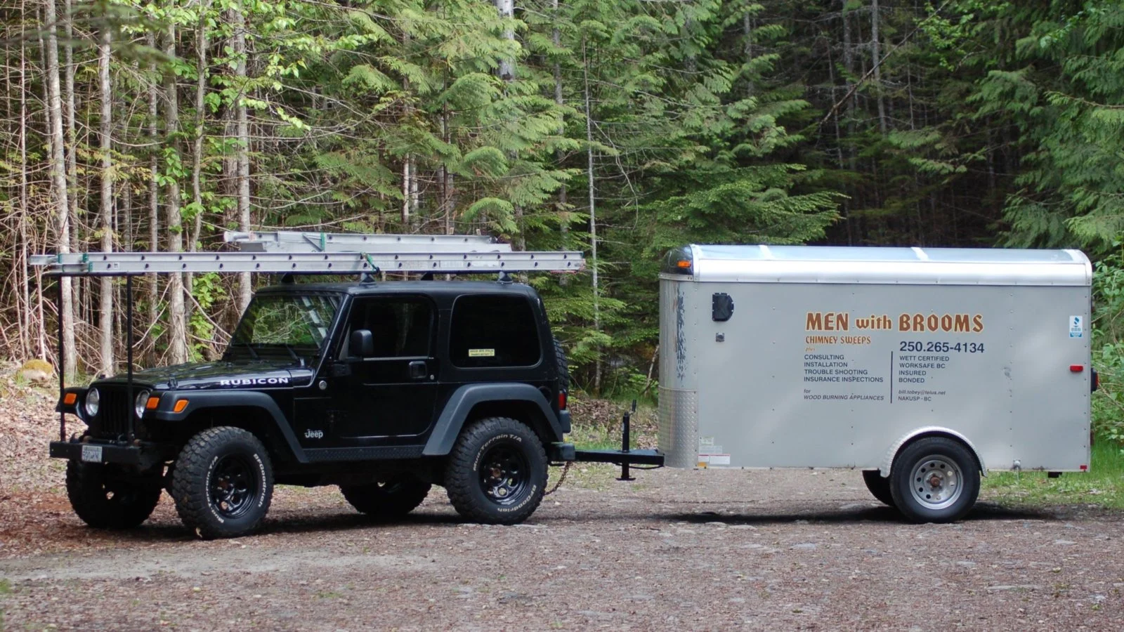

I tow a 2K# trailer daily in the mountains, TJR with 4.10s and 33s. I wish I had 3.73s. Never had a problem on steep mountain grades but I'm willing to down shift. Often as low as 3rd, 4500rpm to maintain 60mph on the hills, or to pull out and pass.
I really wish I could run the flats and downhills at less than 2000rpm. I know my gas mileage would be better with 3.73s.

I put 24,000 miles on it last year, towing for at least 12,000 of that.

I'm not quite sure what mountains you are running through, but they must not be that steep. I've run my Jeep through mountains with 33's, 4.56's, and no trailer and it struggles to pull 50 up some grades. I'm in 3rd with the pedal to the floor at around 3500 rpm. I don't know how on earth you can run 60mph up a steep grade with a 2000 pound trailer on the back. You must have an extra 4.0 hiding under that hood somewhere.
I'm not quite sure what mountains you are running through, but they must not be that steep. I've run my Jeep through mountains with 33's, 4.56's, and no trailer and it struggles to pull 50 up some grades. I'm in 3rd with the pedal to the floor at 4000 rpm. I don't know how on earth you can run 60mph up a steep grade with a 2000 pound trailer on the back. You must have an extra 4.0 hiding under that hood somewhere.

Mostly 10%, a few 12%, lots of 8%. Barely notice the 8% in 3rd at 4500rpm, The 10% and 12% are noticeable but it will still pull 4000rpm in 3rd.
We're talking about the same grades then. 3rd gear floored, I can run 50 mph max up Teton pass, which has a maximum grade of 10%. The physics don't really work out on this. How can you go faster up a steeper grade (12%) with a 2000 pound trailer on the back? Have you been hiding an engine swap from us all this time? Either that, or my engine has some serious issues.
