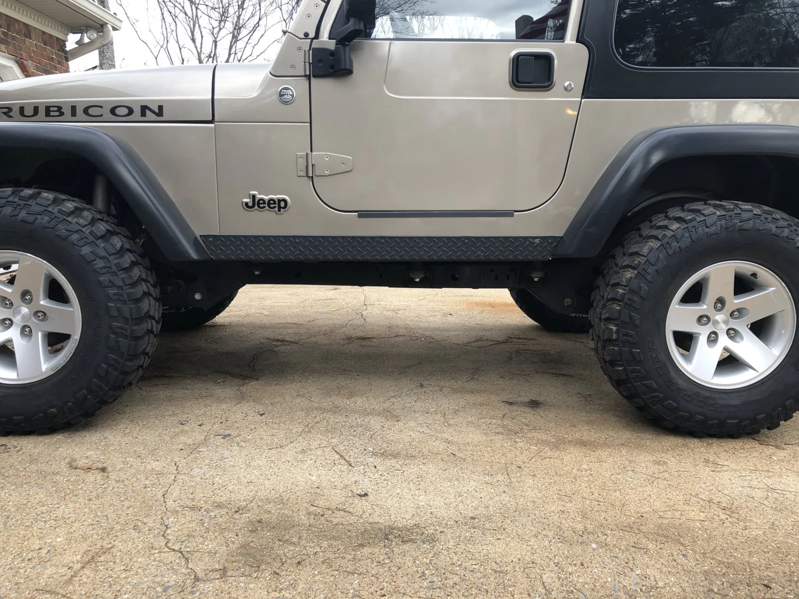

Savvy tummy tuck / under armor install
Do you need to relocate the rear axle shock mounts to rotate the pinion up like this?
I used Currie relocation brackets. This isn't to rotate the pinion as your question implies. The brackets are necessary in order to get the shock body away from the lower spring bucket due to the pinion angle changing.

I finally got around to installing the engine skid after it sat in the garage floor for nearly two months.
Just to clarify, I am replacing the pan with a new oem unit along with the rear main seal next oil change. It never leaked prior to the rock gardens but now I will not have it happen again!

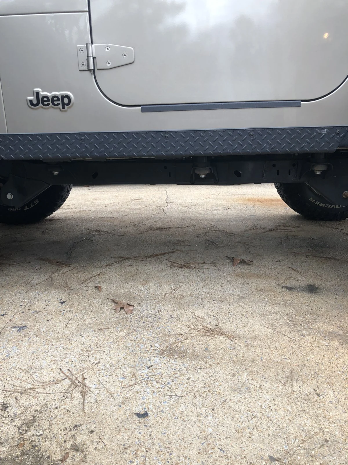

I'm in the same boat on that. Did you have to drill holes where it looks like it mounts to the other skid? Don't remember seeing any on that side. Unless I put it on backwards haha 😂 also I didn't mash the tub up in and I'm pretty sure the TCase is against the tub. It sounds good aweful inside! I need to fix that. I hope that's all it is. Adjusted pinion angles pretty close I think.

Honestly I'm not sure. I read where you basically just set the rear pinion in line or just a degree or so below the top double cardan ujoint and then the same with the front only a little higher and so far it drives fine with no vibes up to about 60mph. Also little update. I was able to mash the tub some and get a little clearance there and it's night and day for sound in the Jeep driving. Pretty sure it fixed the sound issue. Just did it Sunday.
