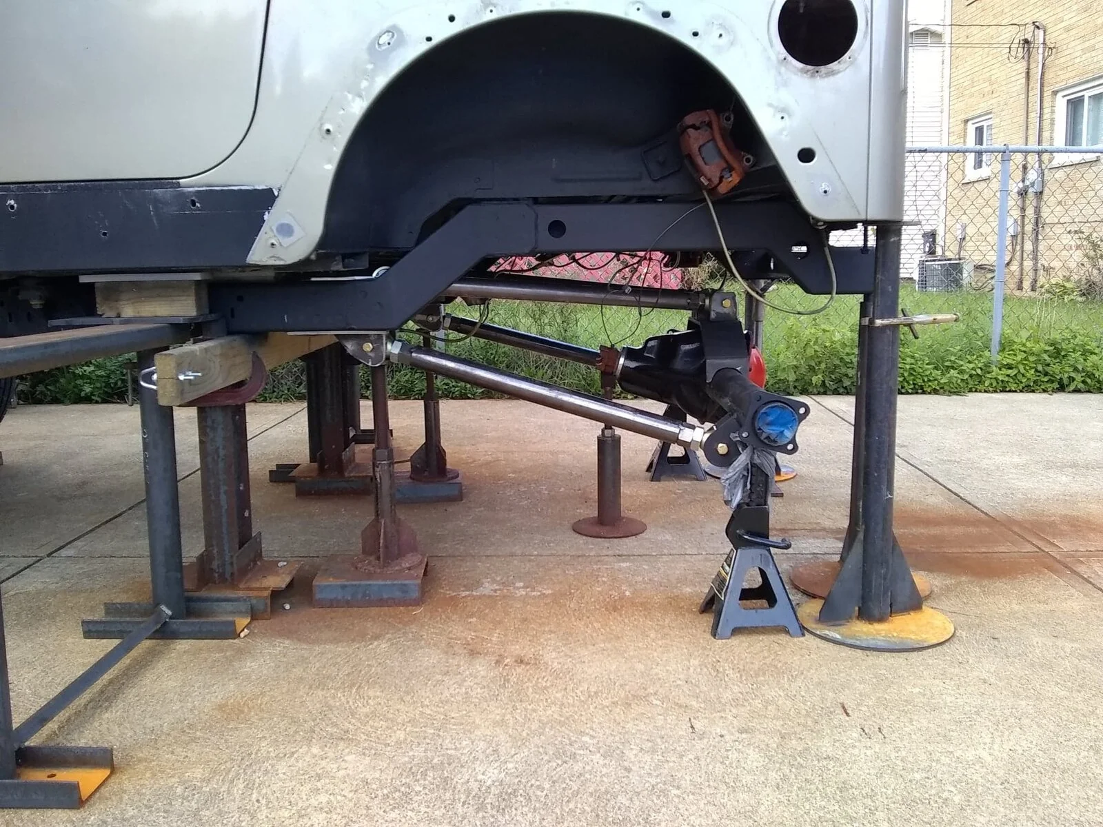

i've considered dropping it through the floor some, getting it lower would make a remote fill tube easier to place.
if i had a local i could afford i'd go for just about any design i could keep underneath, but i really cant see it and it'd be the oddest shaped cell ever built.
i think inside is ok if done right. part of that is a quality vessel (RCI would not be 1st choice for me), another part is fuel slosh control. slosh control is gonna ensure long life and less mess.
here's a pic from a preliminary set up, the axle has since come forward about 1.5". still not enough room for any type of tank behind it.

You have WAY less room than I have back there. I'm still just looking at getting the 20 gallon fuel cell from GR and going with it. But I'll do some measuring and see if I can fit a GR tank under mine before I pull the trigger one way or the other.
