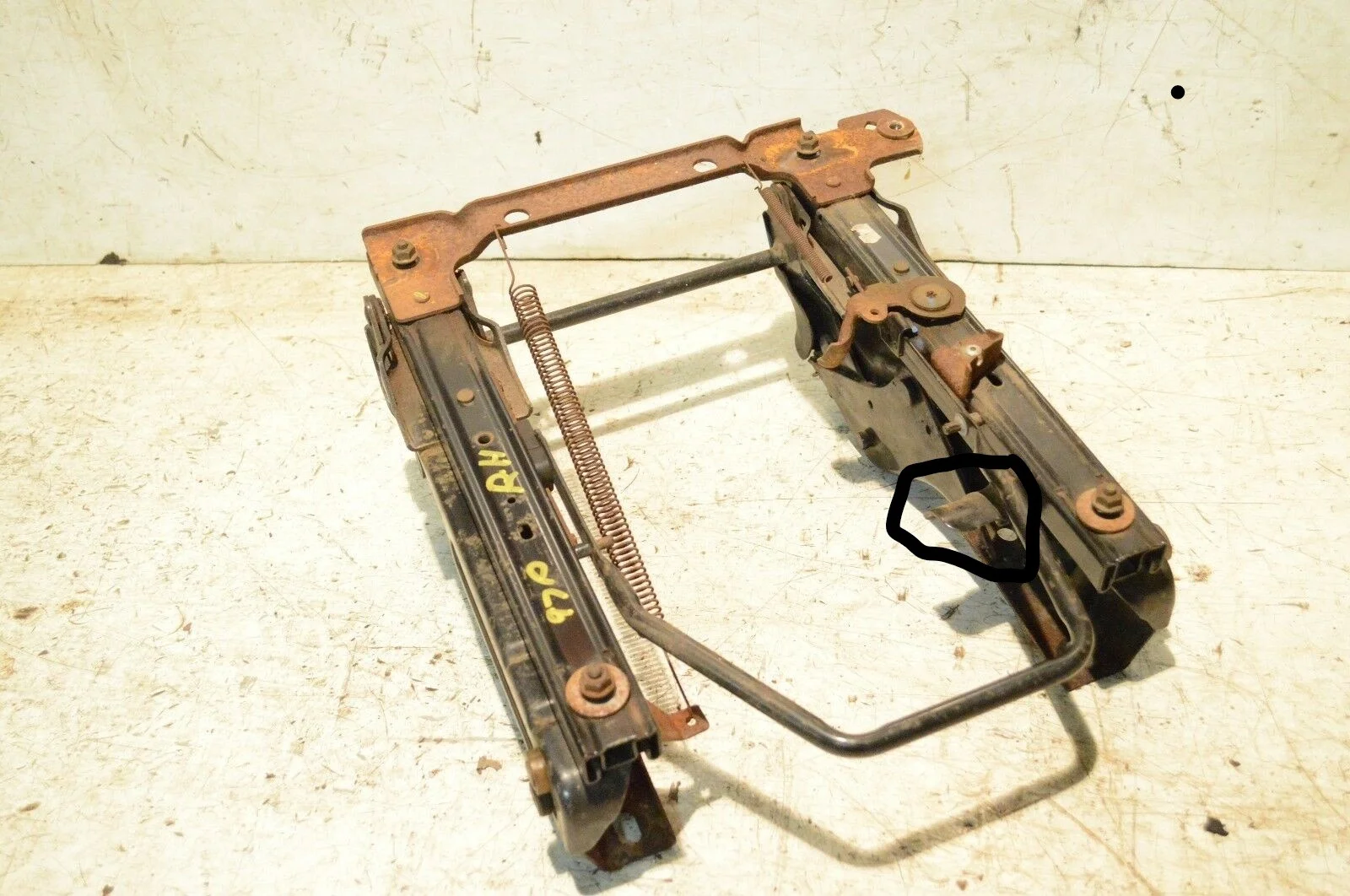

I feel sorry for you because going up is easy but making it come down may not be. Hopefully others will have a better idea but I'd say go to a local welder and have a conversation with him. Possibly cutting the "foot", where the bolt goes through, off and then cutting a piece of metal out to reduce the height and then welding the foot back on.

That lever is the release for the tumble forward of the entire seat. If you push it down carefully with the seat on the base in the vehicle, it will release the seat so that the whole seat raises in the back and pivots up a bit and then all the way forward. It is the lever that is moved when you move the lever on the side of the seat up near the shoulder. Late model has a lever, early has a loop of webbing.

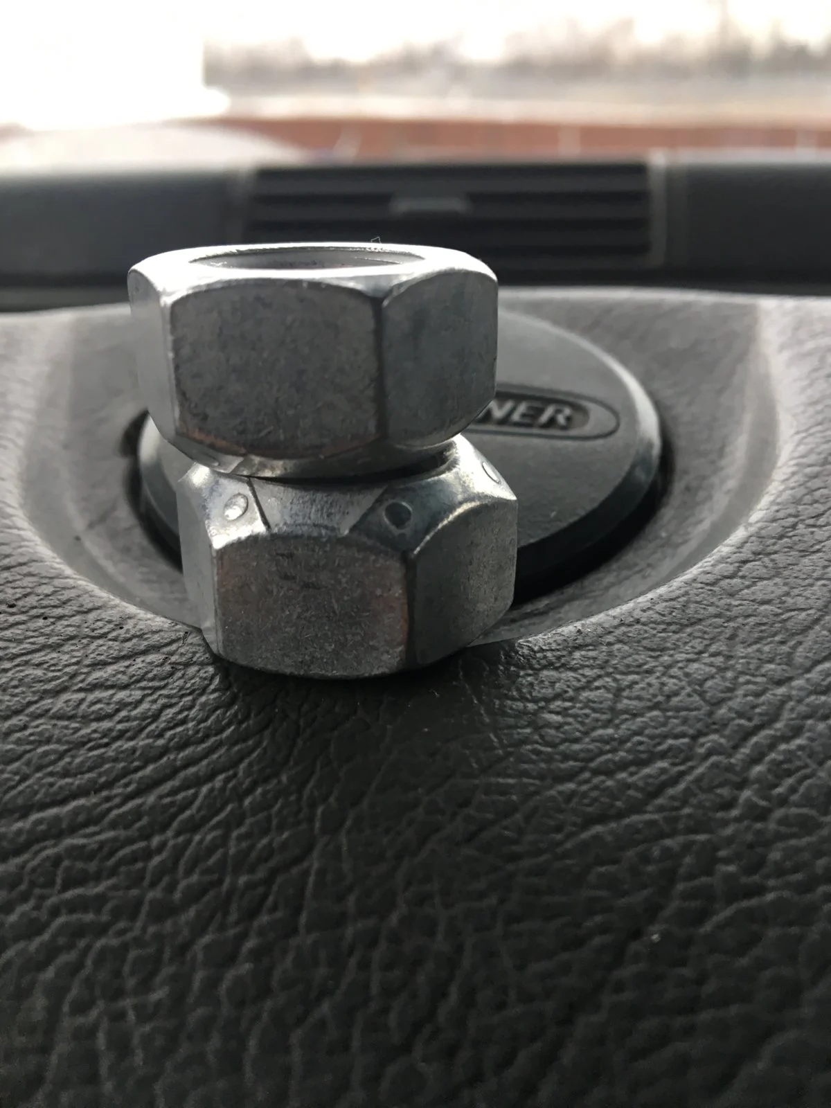

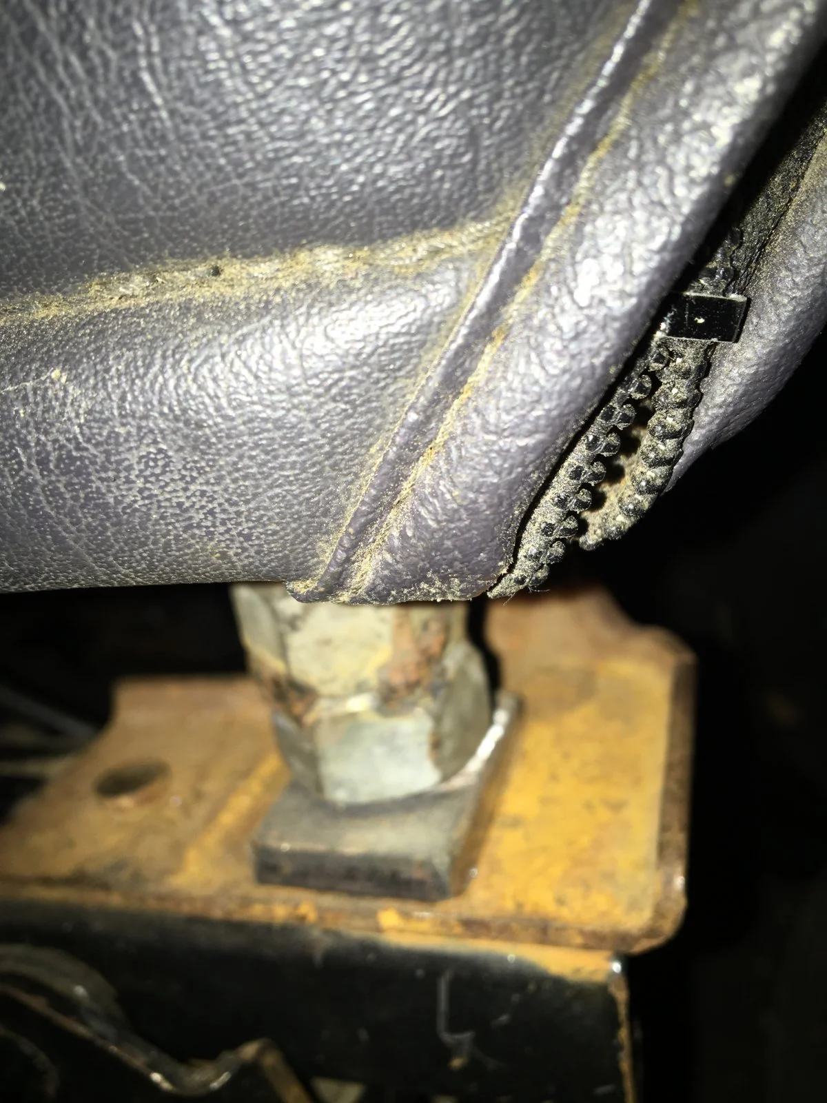

If you switched to newer 03-06 seats. They sit 1.5" lower. Probably run about $500 shipped. Maybe $600. Less if you can find local. And from what I've read they are very comfortable. I'm a big guy too. And need the extra room. From what I have read they are bigger seats and at least just as comfortable if not more comfortable than the 97-02 seats. You need the seat and all brackets that mount directly to the tub.

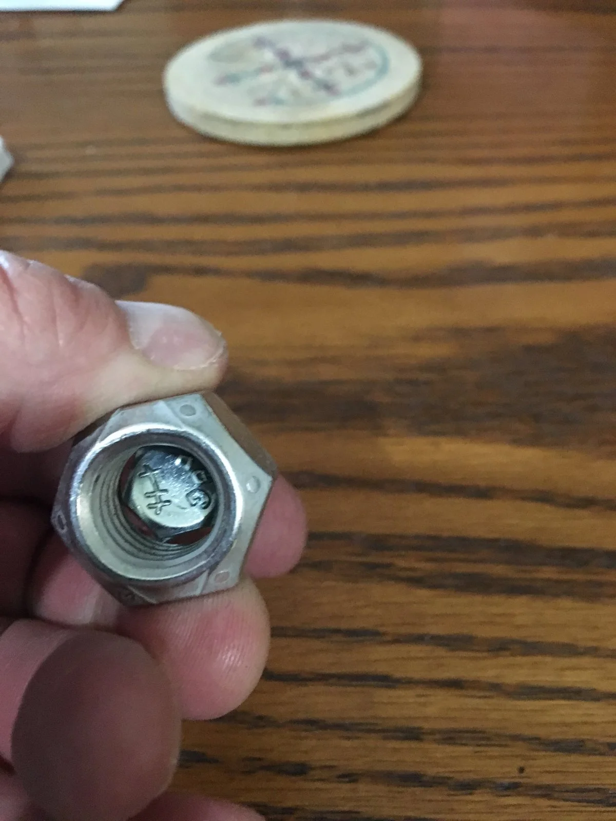

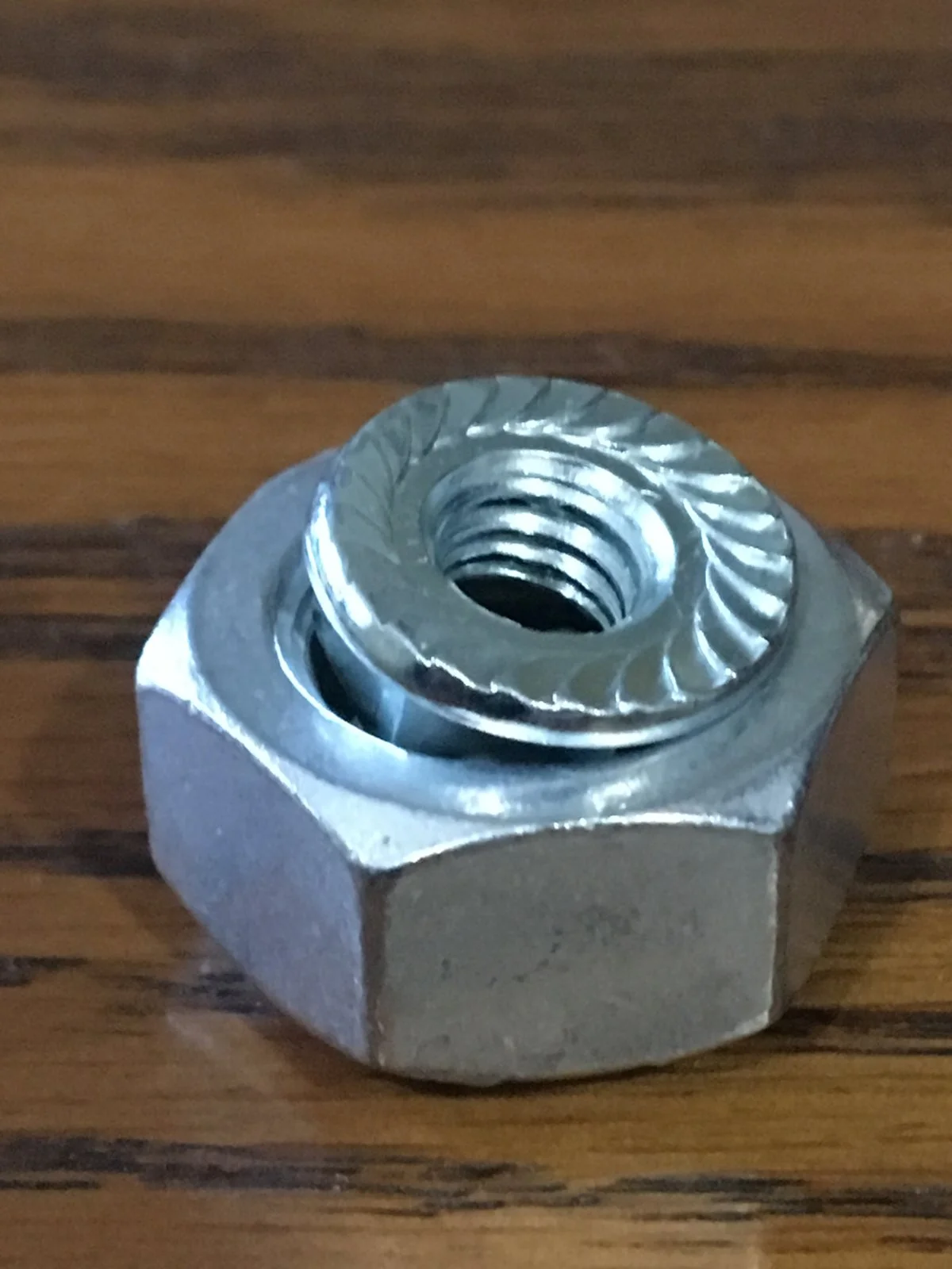

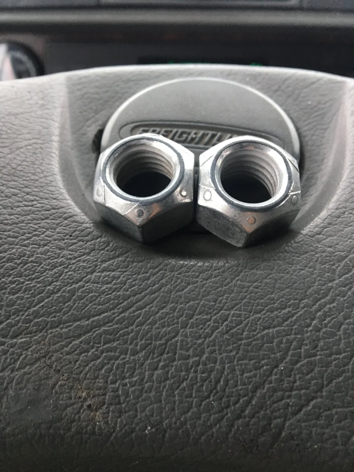

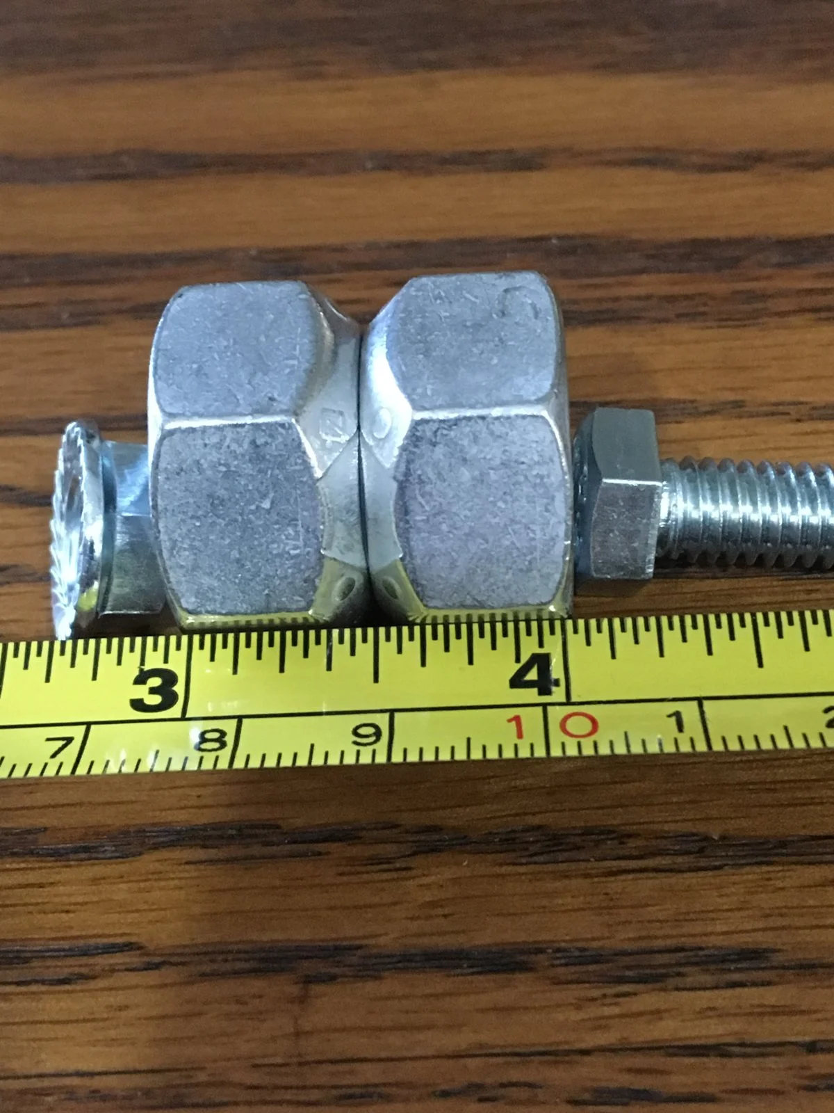

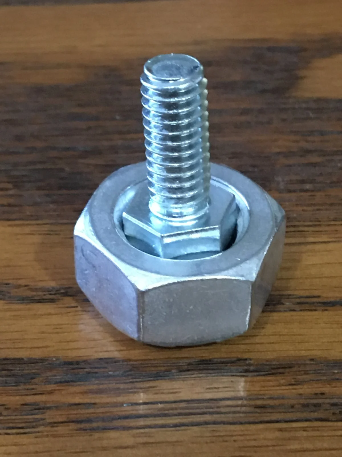

Next I weld the two large nuts together netting an inch in height. 6BEE1E8D-0D96-4B96-9F28-DA2E1D207589.webp
My seats have metric studs and nuts on the sliders. I bought 5/16 x18 bolts and nuts because when at store couldn’t remember the metric thread pitch.
