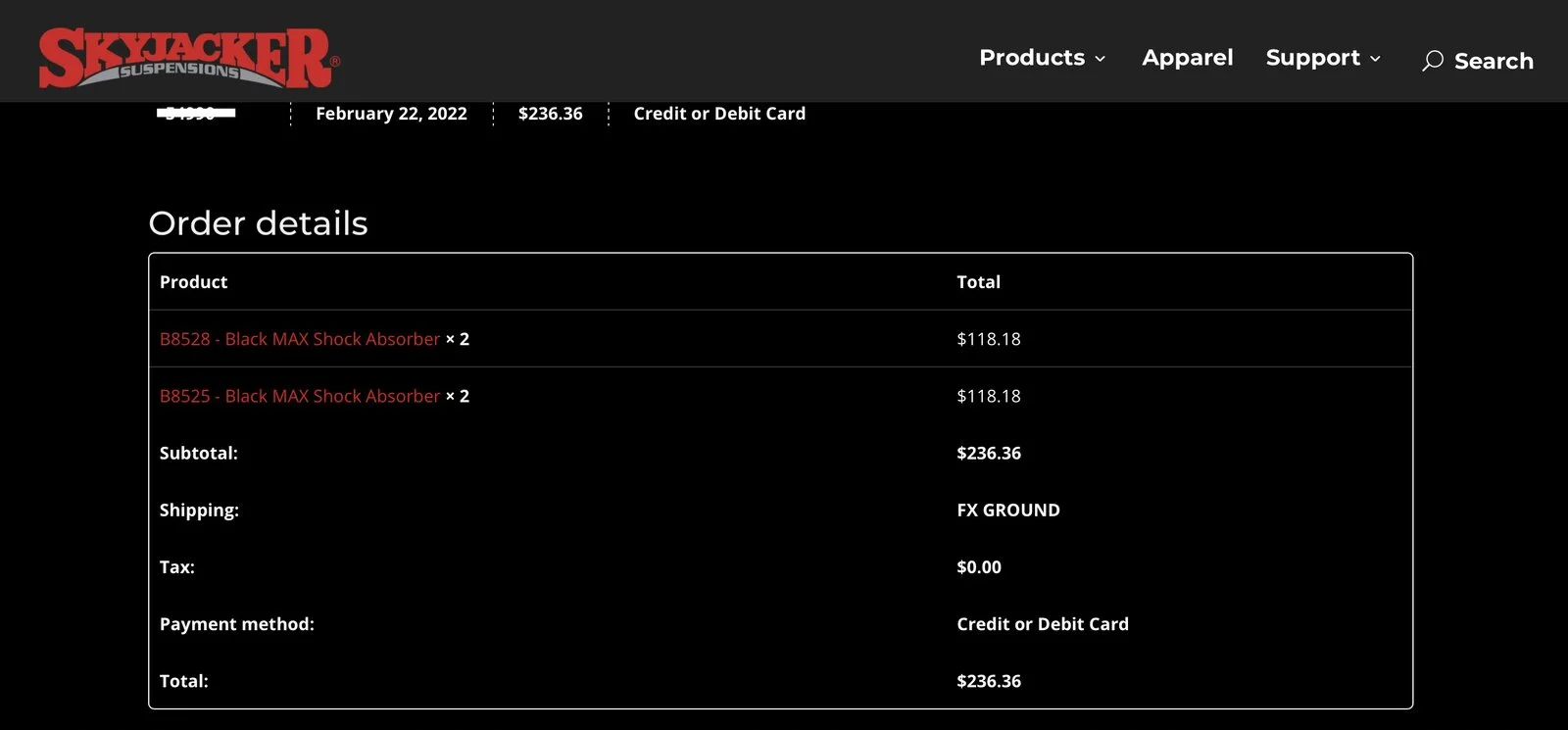

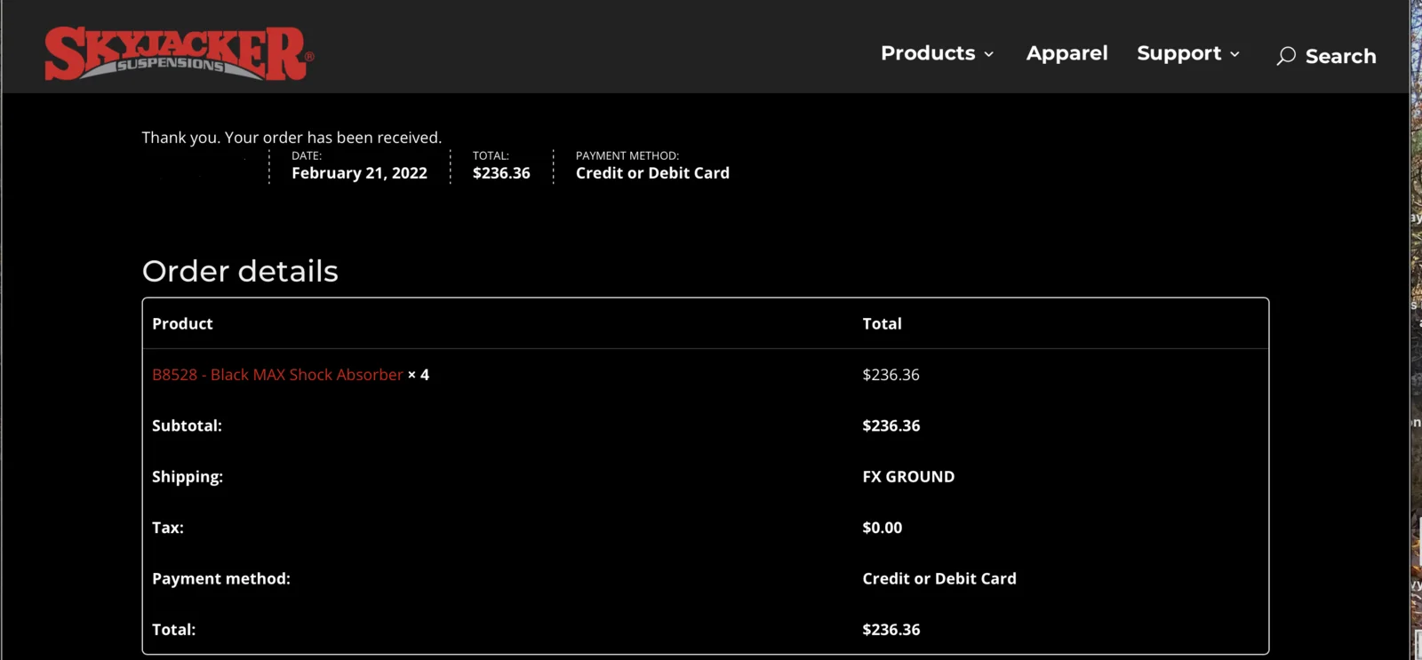

Just got my blackmax shocks installed today. I’ve only driven about 10 miles on them and I’m quite pleased with them especially the rears. I no longer feel every ripple and small cracks in the road and the bigger bumps are not nearly as harsh as they were with my rancho 5000x fronts and rancho rs9000s in the rear. I have Currie 4 inch springs front and rear. I used part numbers B8525 in the front and B8528 in the rear. They fit great. I had no issues with length whatsoever. Hope this helps anyone on the fence about ordering them.
