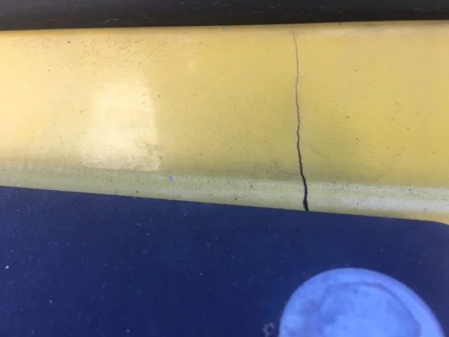

This is what happened to mine with a 33 inch tire hanging on the OEM carrier

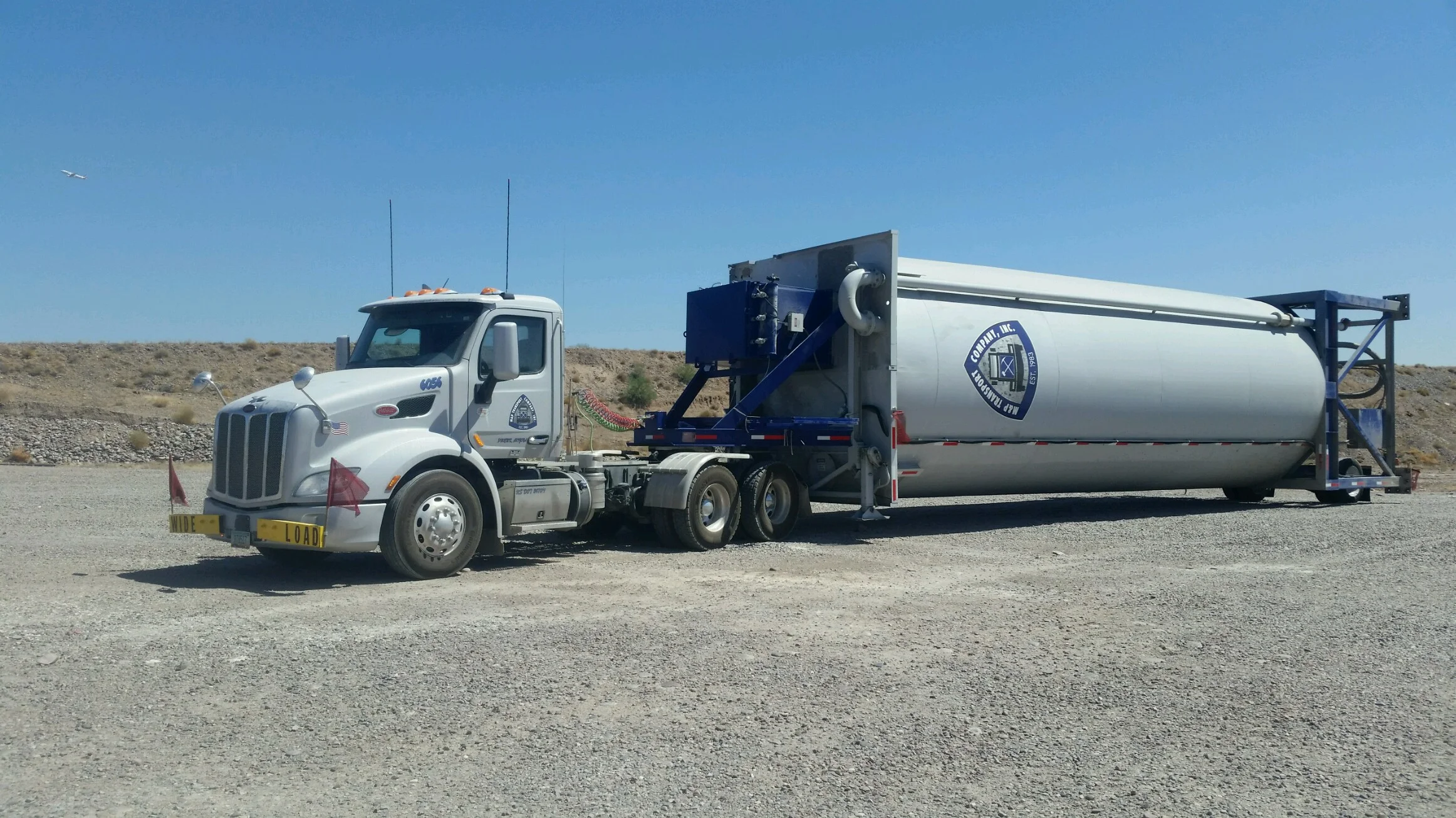

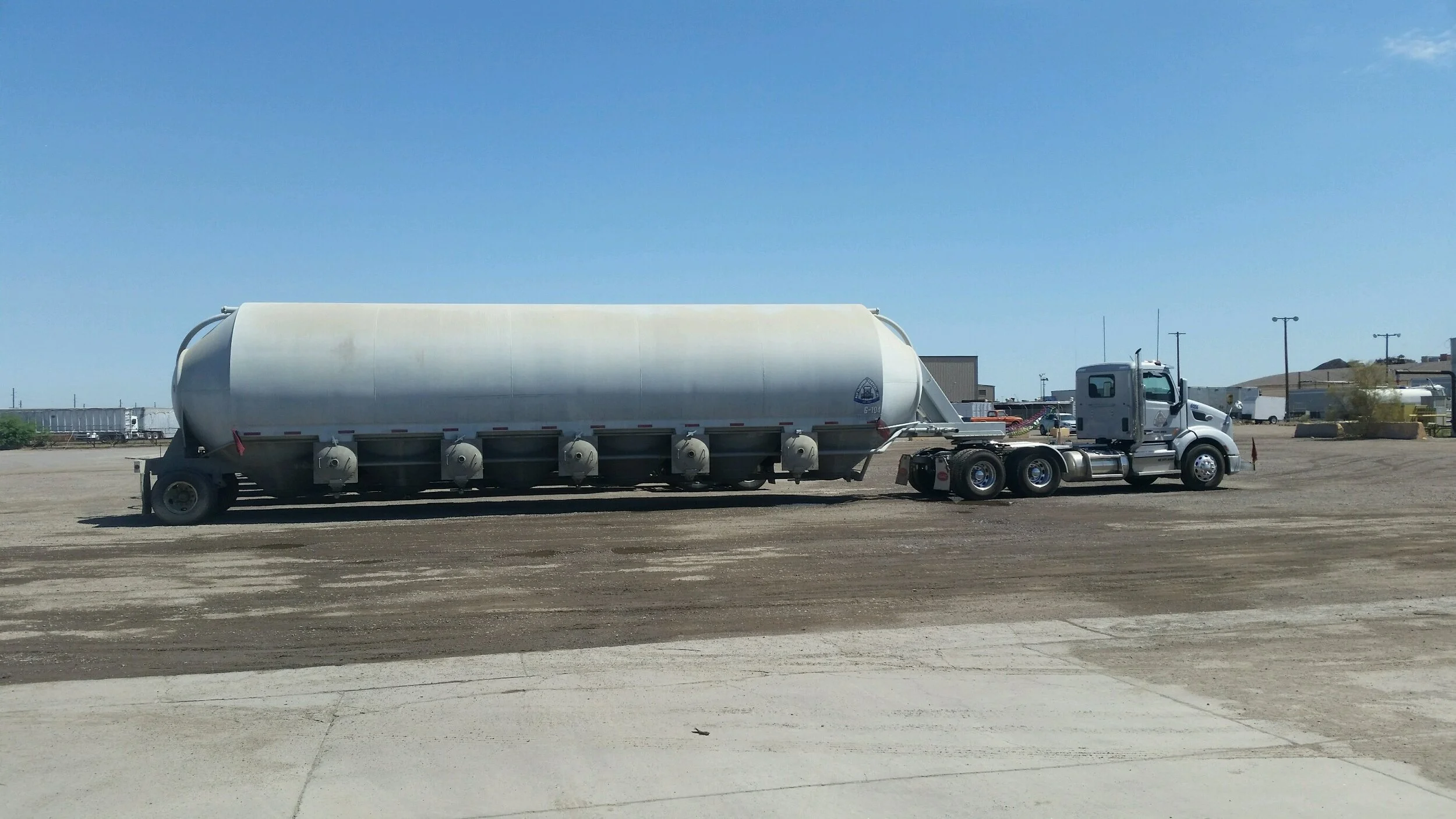

Big bois. What is in those tanks? I've never seen one like those before
The 2nd pic is a Guppy. Size is larger and longer than a train car. Used on site as a storage tank for either Cement powder of Flyash powder at concrete batch plants. I had hauled 9 of them between 3 plants for the computer chip plant being built in north Phoenix. Basically, they are larger versions of the trailers we pulled.

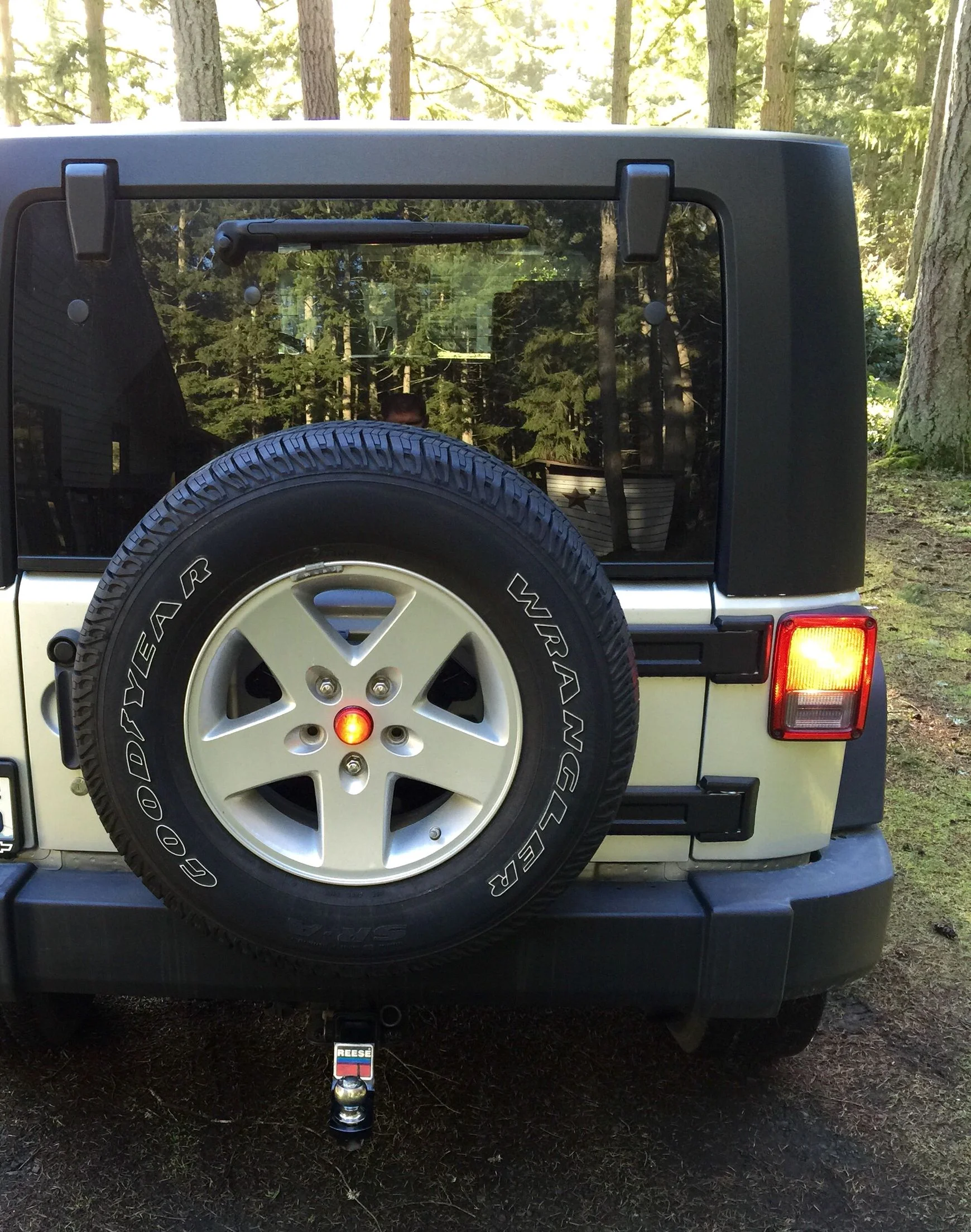

I also wasn't a fan of extending the stock 3rd brake light up and taking up more of the already obstructed view thru my rear window. Picked up this $23 KC Cyclone and wired directly to the stock 3rd brake light wiring. Little less flashy than the Ring of Fire and does a great job.

one safety note to removing the 3rd brake light. if you have your hazards on, the tail lights flash and the 3rd brake light is the one that indicates braking. no 3rd brake light means no brake lights at all when hazards are on.
