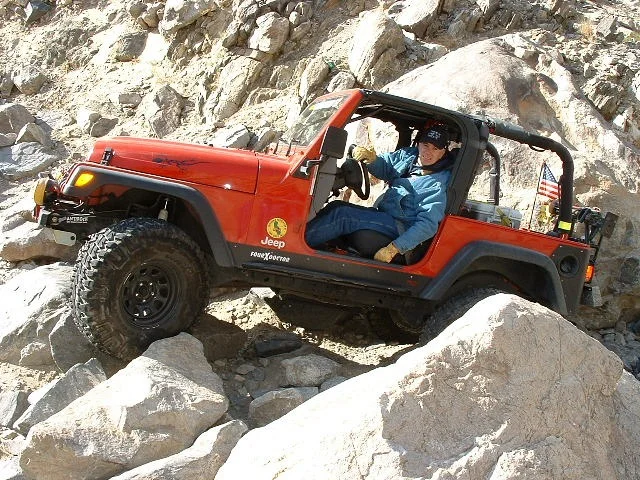

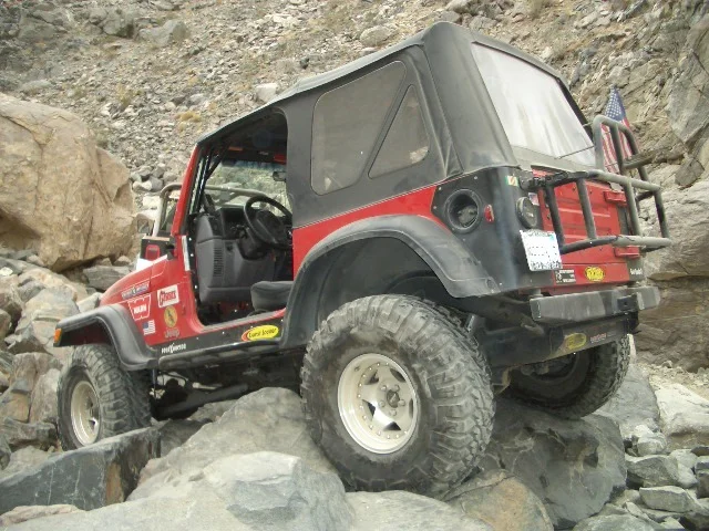

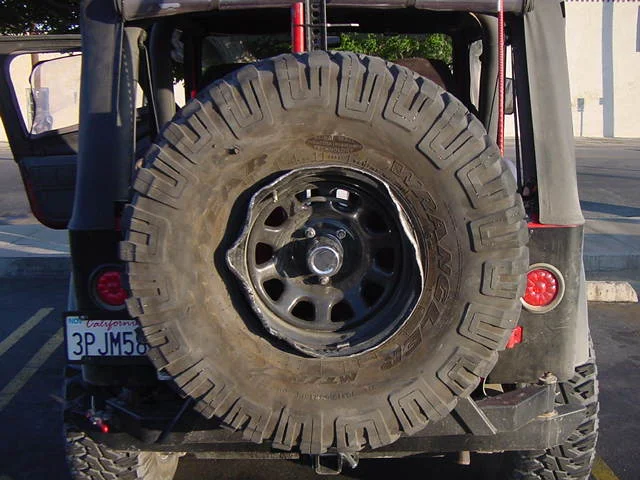

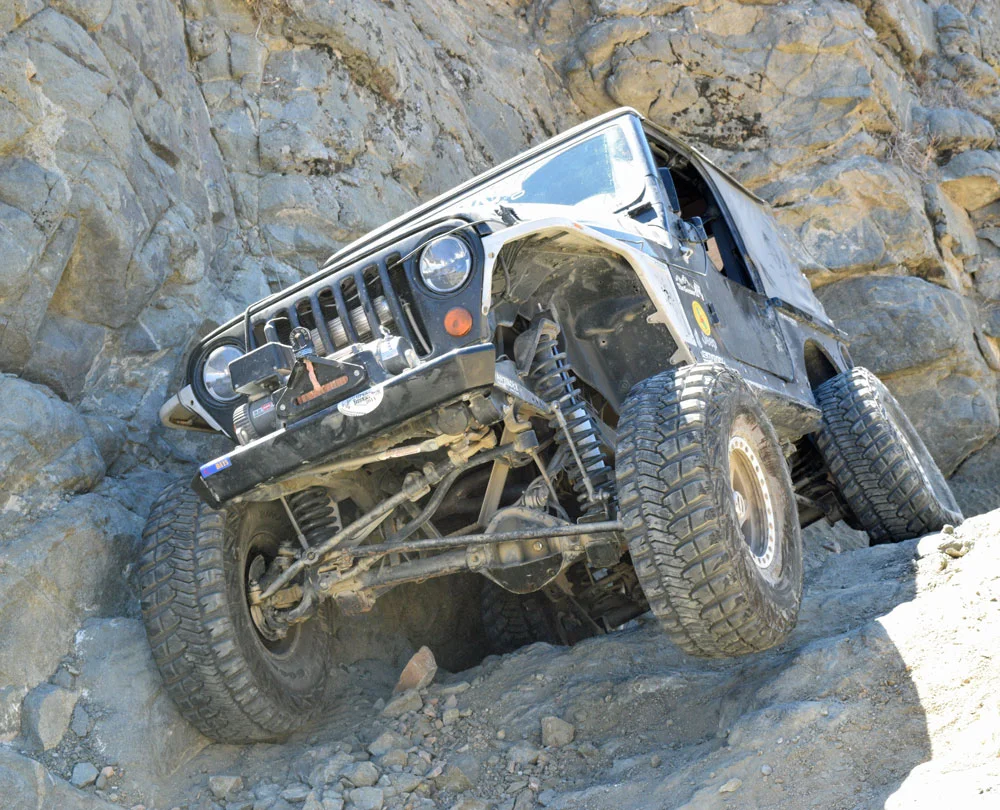

You are correct. Having run steel wheels on some very tough rock crawling trails for a couple years, I switched back to aluminum and I'll NEVER go back to steel. My steel wheels couldn't take the pounding on the rocks, they were always getting dented enough they couldn't hold air, and they would bend and no longer spin true. That was maybe 14 years ago, I'm done with steel wheels.
Here's a couple photos to show my previous rig on steel then aluminum wheels, and my present rig on forged aluminum beadlocks. And lastly, a friend's bent up steel wheel after a weekend on the rocks in Johnson Valley California.
My above red TJ was stolen, both of those pics are from the same trail, Sledgehammer in Johnson Valley Calif. The below pic shows my current black TJ near Death Valley Calif.

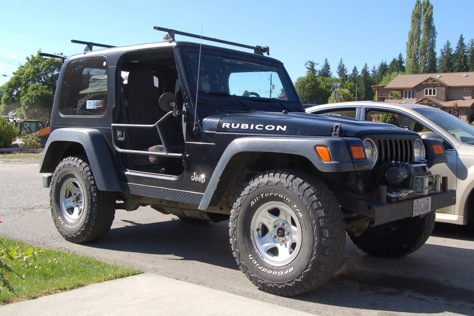

I just went from steel to aluminum just this weekend. I kept the same tires since they were brand new.
Tire Store Said:
Steel wheels are heavier and harder to balance since they have hard and soft spots and tend to warp.
Aluminum are lighter and don't warp and are easier to balance.
What I've noticed:
They did balance out a lot better (but I blame Discount Tire for the crappy balance)
I seem to feel the road more, like all of the bumps I feel in the steering wheel more new wheels don't absorb as much.
I can steer considerably easier. I am assuming because if the lighter weight.
I will most likely stay with the aluminum for my whole TJ career.
