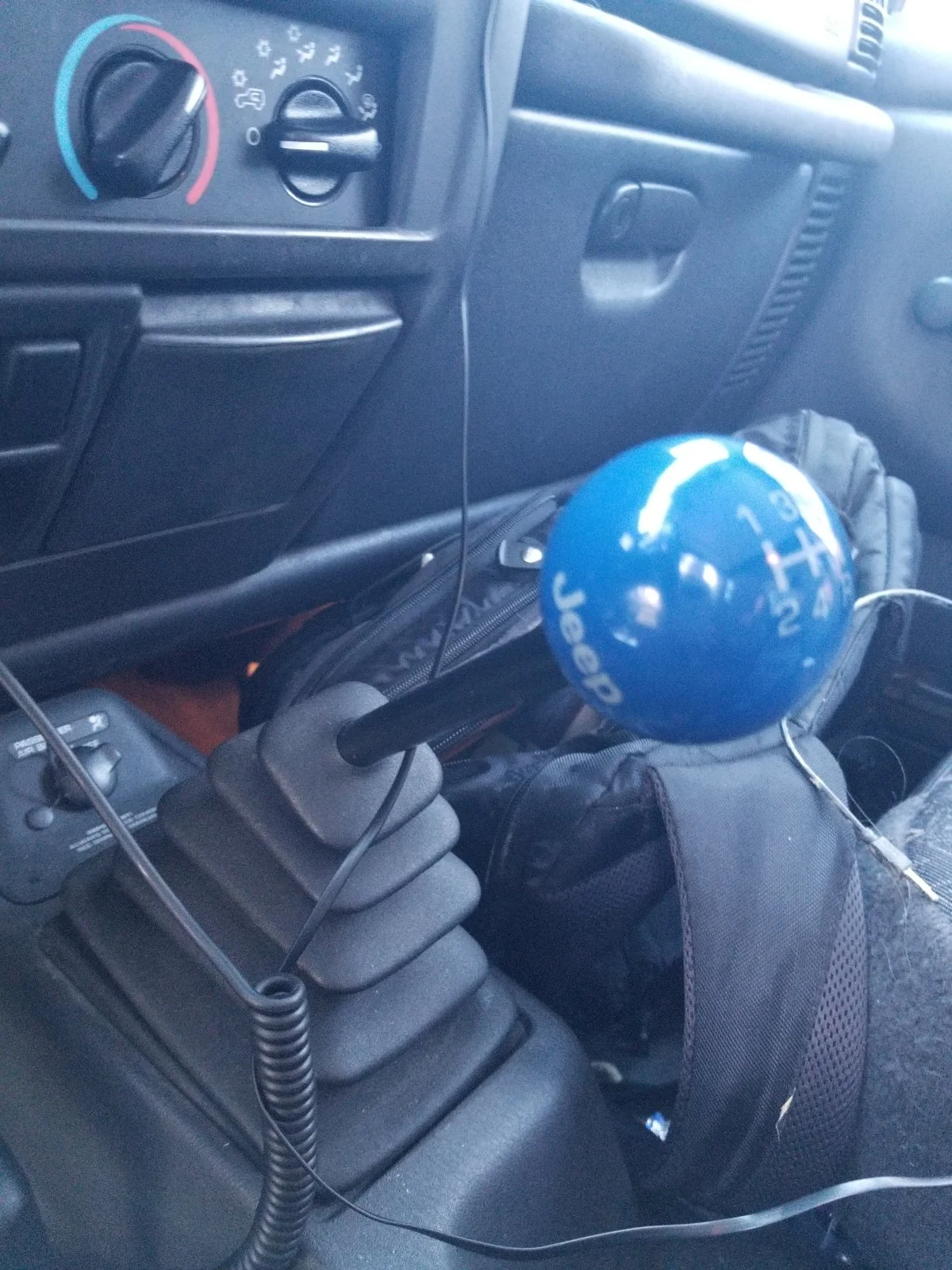

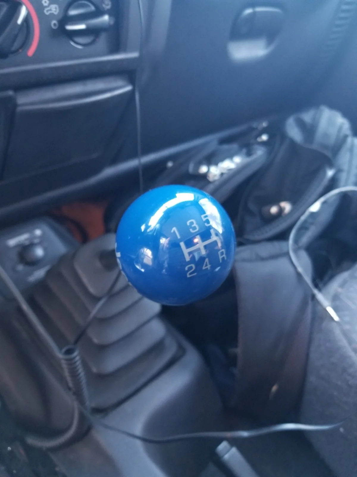

One of the first mods I did to my daughters TJ was a new shift knob.
It always struck me as a silly mod when I bought cars that someone had changed out the knob. But I’ve got to admit that I prefer using the pool ball over the stock gear shifter. Next up is a new rear bumper.

New TRE arrives tomorrow. Had an oops while shortening the drag link. Had to cut off TRE and order a new one. Will update as soon as it’s driving. BTW, nice shifter knob. I like the gear pattern cut in.

It was the first part I bought for her Jeep. The stock one was shot and the shifter pattern missing. Being a new driver she needed that help plus as you said it just feels better in your hand.
