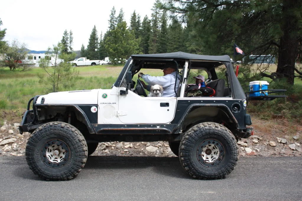

Love your rig man! That is scary close to how I would like to set mine up. How's it do on city/highway with that setup?
It's fine on the street and highway. I can keep it at 70mph most of the time. Some struggle going up steep grades, but that's probably more because of the 42RLE. I have no complaints. Though I wouldn't mind upgrading the front to a 60 someday.
I don't go wheeling as much as I'd like, but I am still using the original ball joints. I think it's been 4 or 5 years.
