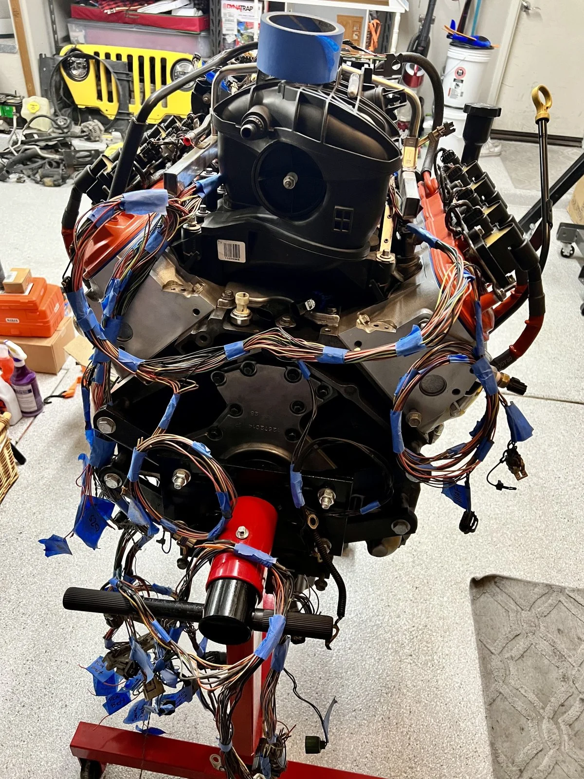

Today I dug in to the Jeep wiring harness to get everything labeled, and to document the connections here. I'd also like to get a sanity check on it before I start cutting - not that I can't put a wire back in, but I'd rather cut once and be done.
2004 Jeep Wrangler Rubicon 4.0 Wiring Harness Clean-Up for LS Swap​
Here are the connections that I've got on the main wiring harness for the engine. I've marked the connections I'm going to remove with a strikethrough. Let me know if I've got this wrong:

I've also got to go back and watch my favorite Canadian (BSK Garage) go through his Jeep harness for like the 9th time so far to make sure I've got my ducks in a row.
Altogether, that is just about half of the wires gone. I'm going to give this sanity check some time to simmer here on the forum, and then I'm going to go Edward Scissor Hands on it. And since a post is no good without pictures...here are 2...one of the engine made to look like I've made more progress with the heads than I really have (they sure clean up nice tho!), and the other is of my swap binder (research and service manual print outs) with my notebook of random thoughts, findings, and calculations.

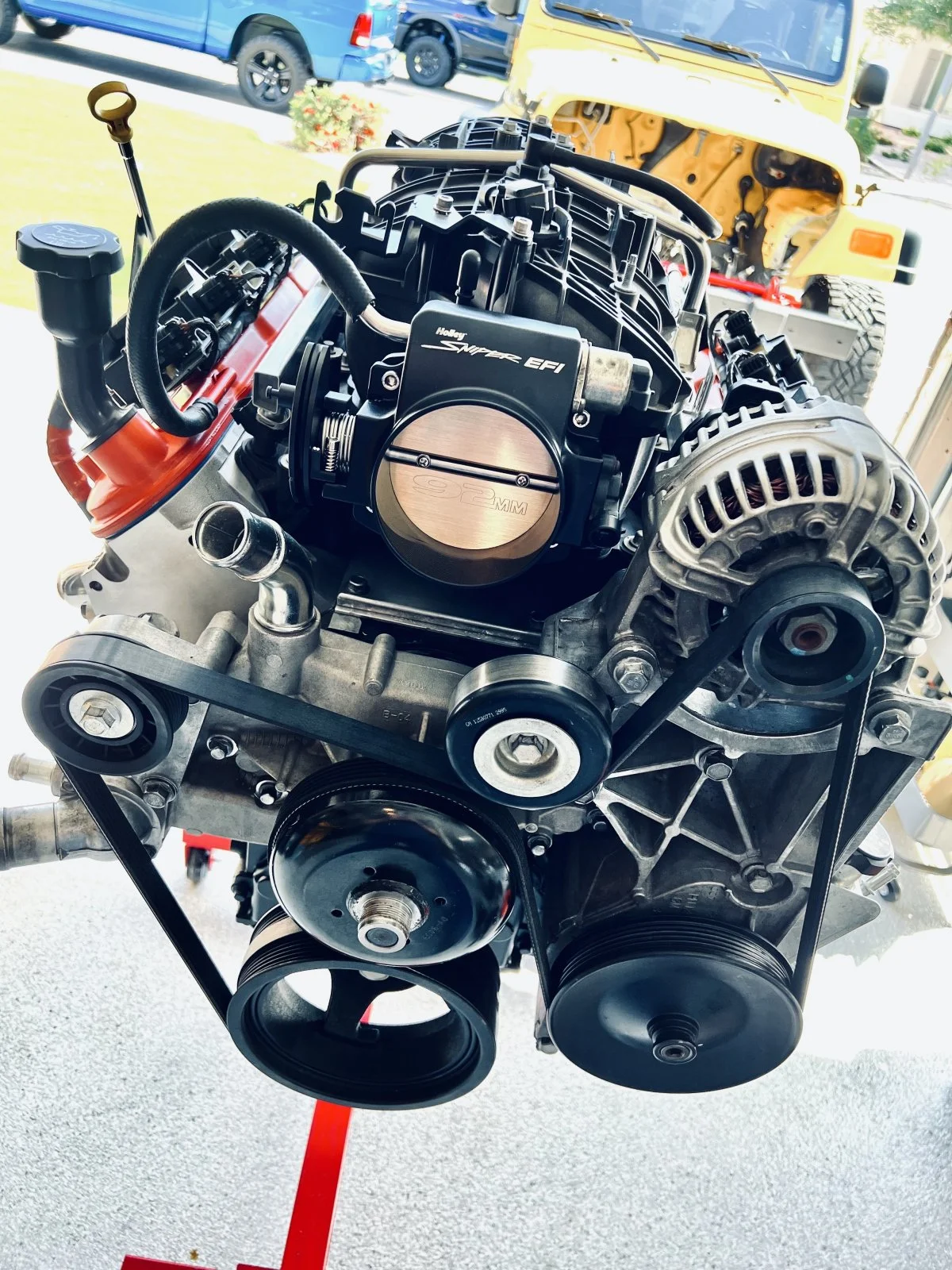

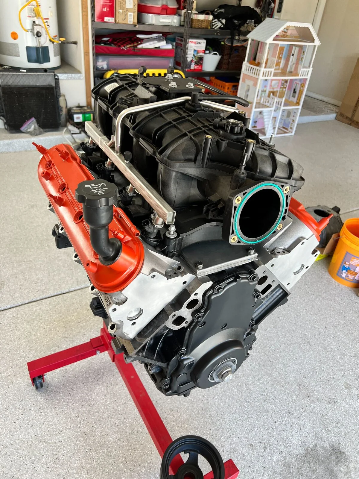

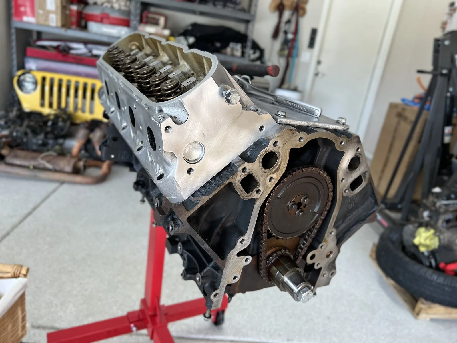

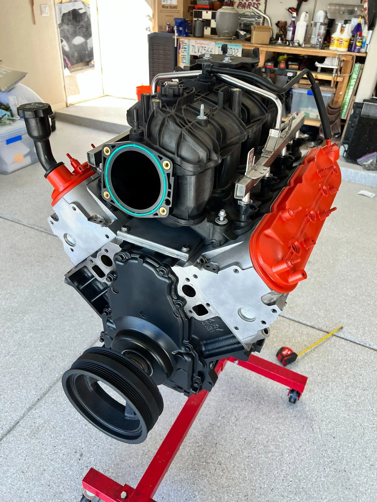

I've got the motor nearly 100% assembled, however, I do need to swap out the alternator I've got with a 4-pin version. I ended up with a 2006 Tahoe 4x4 version (2-pin) that has voltage regulated via the ECM, however, I decided to go with my 1999 Silverado wiring harness and ECM, and that feature did not exist for that harness/ECM. I realize that I could probably just throw a 2-pin pigtail on the harness and go with it, but I won't be getting all the juice out of the alternator...soooo...I'll just go with swapping it out.
Also, I discovered that some time in the early/mid 2000s GM moved away from vacuum-based brake boosters to this lovely thing called "hydroboost". From what I've read, this is a hydraulic system that supports both the power steering and braking, and has a cooler mated to the system somewhere along the way. Instead of having 1 return port on the pump reservoir, it has 2. Now...given that these are low-pressure return ports...I'm thinking I can simply insert a T-fitting into main return from the steering box and have it dump to the second port as well - I mean, it's all going to the same place...right?
I'm still going back and forth and doing research on the steam/coolant crossover lines. I don't see why they are entirely necessary if you evacuate all the air out of the system. I see the point if you do have air that is trapped in the heads, but if you use something like that bucket thing that connects to the radiator fill port...and turn your engine on with radiator fluid in the bucket...shouldn't it create a completely sealed system and you don't need the crossover and "steam port" on the radiator?
I've decided (and accepted) that I'm going to complete the A/C install after I get the motor in & running. I realize I'm running up against the blistering heat of AZ summer...so, that will be a great motivator to get it done quickly. Installing A/C was also one of the reasons why I decided to utilize the 1999 Silverado harness/ECM due to some research I did that explained it was easier to implement AC with that version ECM than the other that I had.
Still...waiting...on...parts...from Novak. Transmission adapter, fuel pressure regulator bypass, return line bung, hydraulic clutch retro kit, and brake booster insert. I've got almost everything else ordered and/or delivered, so that's good.
Budget creep has set in ever so slightly, but it's not that far over, so that's actually surprising - I expected budget creep.

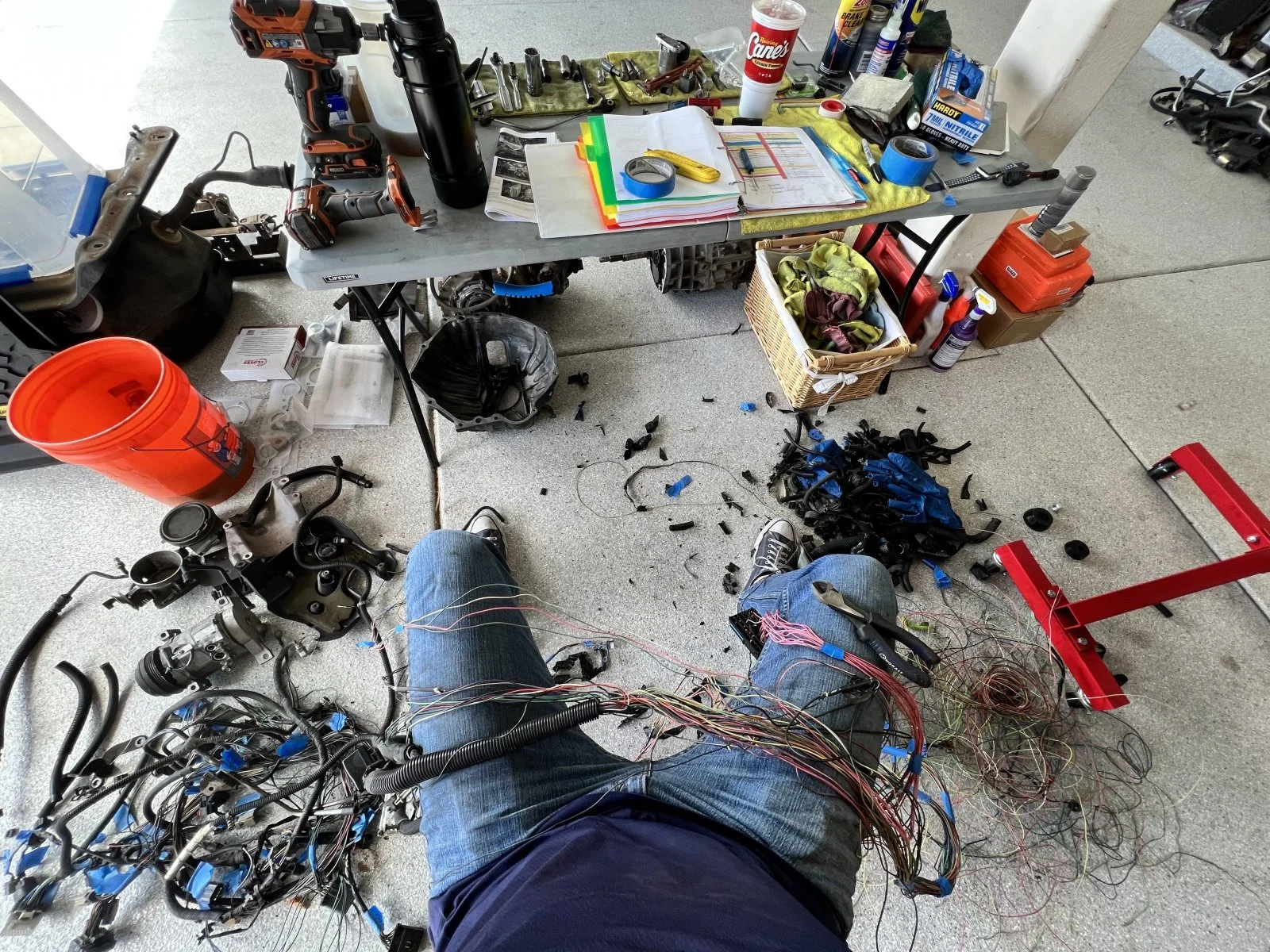

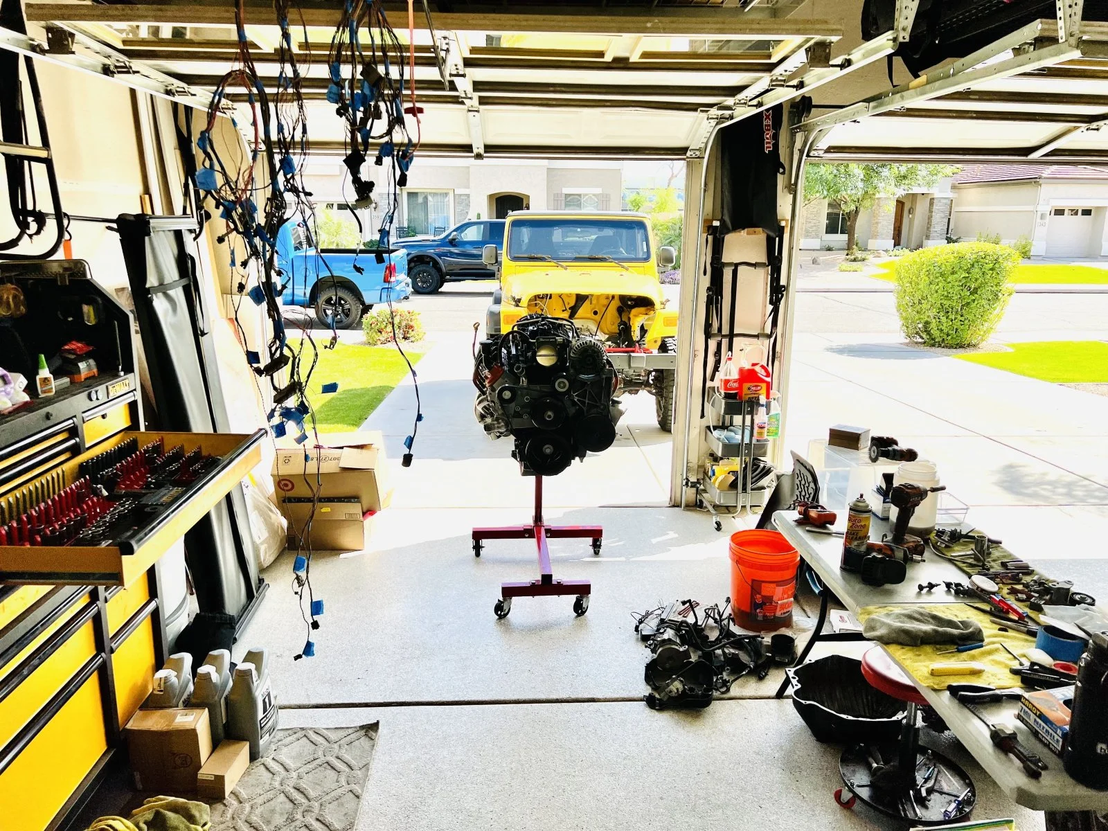

Next up - finish routing the wiring harnesses (the mating of the two takes place at the firewall), shorten wires, install fuse box, determine ECM mounting placement, cut/solder upgraded fuel injector pigtails, replace evap plug back to the TJ harness (literally just realized I snipped that off yesterday damn it), continue with clean/prep/paint engine bay, and I think I'll swing the motor over and set it down to test fit on the mounts and look for clearance issues.
Lunch time office space. Not bad at all.
My son about lost his mind when he came home and walked through the garage and saw me thinning out the GM harness. LOL
It's cleaning up quite nicely...

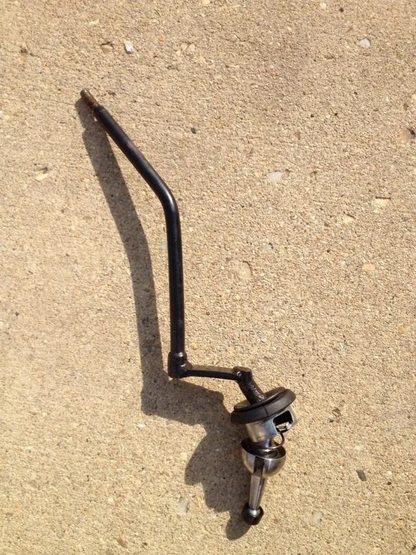

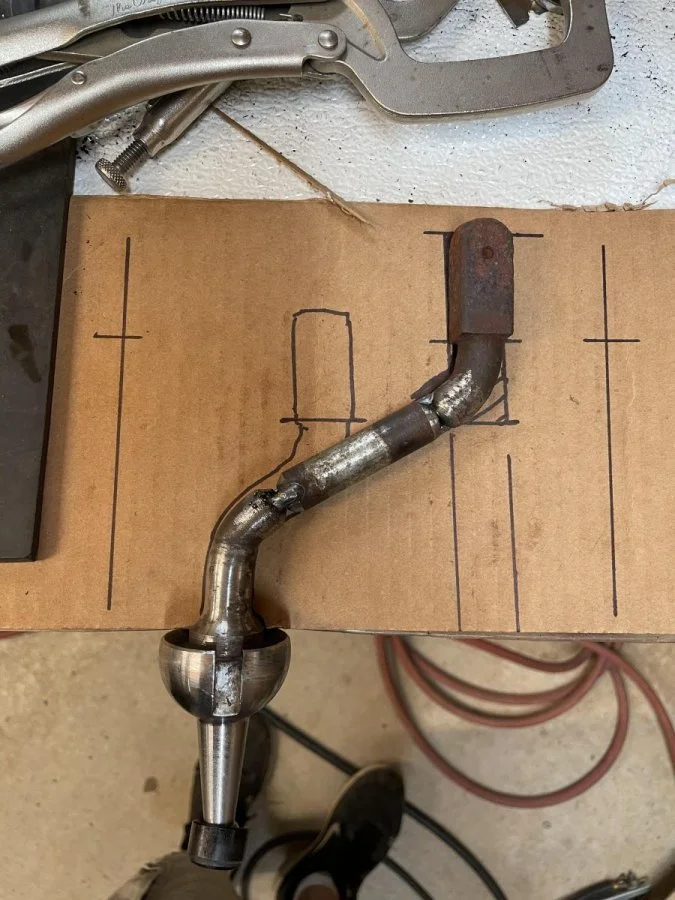

I do have a question. The shifter from the shift tower is hitting the firewall side of the tunnel cut out. I can shift in to 2/4/R and can stay in neutral. Can move it up for 1/3/5. What are my options? Do I just cut the tunnel shield? That’s easy enough. Or is there a different stick that’s offset that would work. Mine is literally straight up from the tower, but I’ve seen other NV3550 shift towers that the stick base is straight then goes to a 45 degree bend or something like that. I’m up for suggestions before I just cut it and move on. 🤣
Ok, I don’t have any pics to share, but after being idle for a few weeks waiting on parts, I’ve finally made some significant progress and will post pics later.
I’ve got a few buddies coming by this evening to help get me over the finish line and crank it up tonight. I’m beyond excited to hear it start up for the first time.
I’m not entirely confident that I’ll be able to drive it because I’m pretty sure the driveshafts are going to be off. Looks like my setup has moved me forward an inch or more. Won’t know definitively until I get the transfer case on and measure.
Something like this is what people do with a magnum swap.
This is the easier way.
