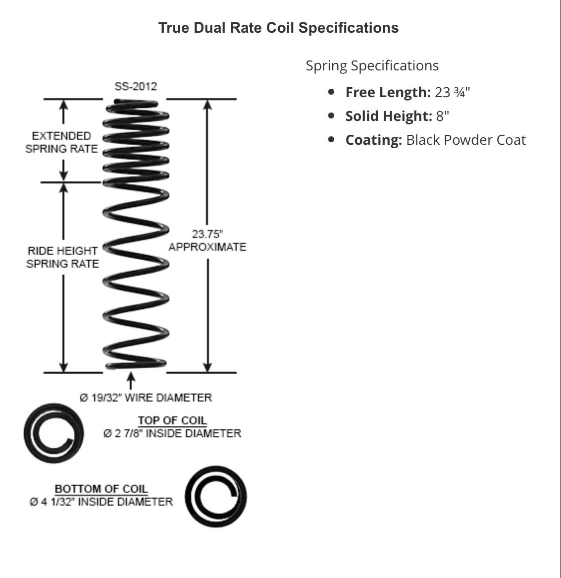

Those dumb MetalCloak 4.5” fronts go solid at 8” not 9.5”, also free length is 23.75“ not 24”

The 4.5" and 6" rear free lengths are off by a small fraction. And they never used to say approximate. The solid heights are correct and that is the primary reason I think MC springs are dumb.
So the solid height of 9.25” for the front 4.5” springs is your approximation? That’s dumb, where did you get that dim. from? Technical information should be objective or it’s trash.
Let's delete this whole thread since nothing can be trusted. Or @Chris can correct the mistake and we can all move on from this travesty.
