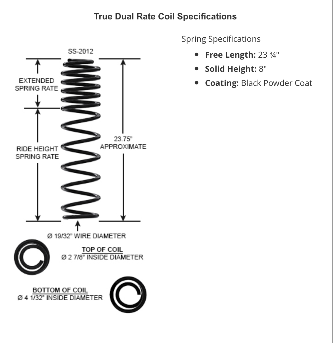

Those dumb MetalCloak 4.5” fronts go solid at 8” not 9.5”, also free length is 23.75“ not 24”

Anyone know the rate of the upper portion (extension spring) of the Metalcloak springs?
If I had to guess, the rate is the same as the rest of the spring. But because the windings are closer together, that section reaches bind before the rest of the spring. Currie rears do something similar for a couple wraps, just not as ridiculous as Metalcloak.

You will probably find it difficult to get spring rates for any of the dual rate spring manufacturers as they consider this proprietary information including Currie/RockJock.
