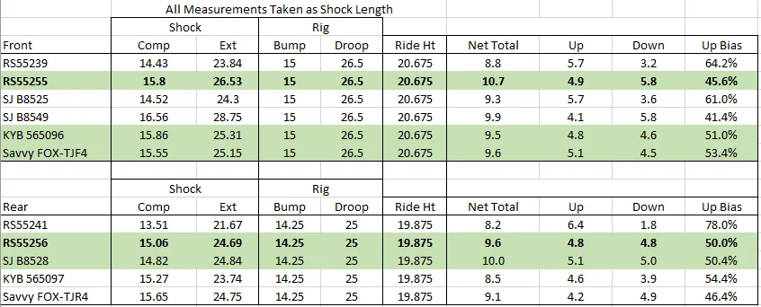

That rear one you listed would give me about 5" up, 3" down. Hmmm.
My other option would be about 4.25" up, 5.4" down (I would need to install a half inch spacer for the rear)
