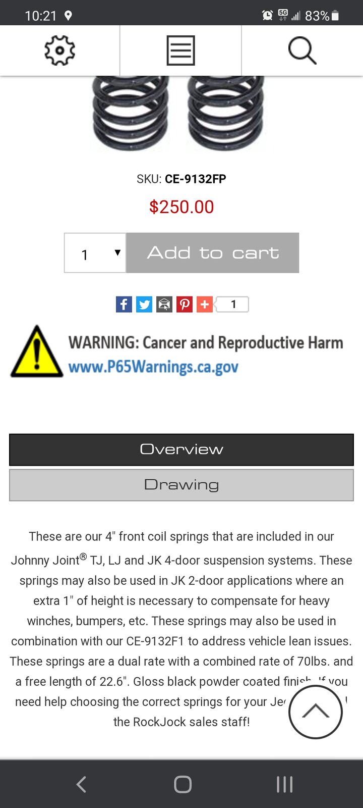

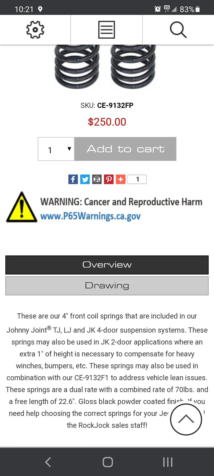

You will probably find it difficult to get spring rates for any of the dual rate spring manufacturers as they consider this proprietary information including Currie/RockJock.
https://www.rockjock4x4.com/CE-9132FP
Reactions: JMT
