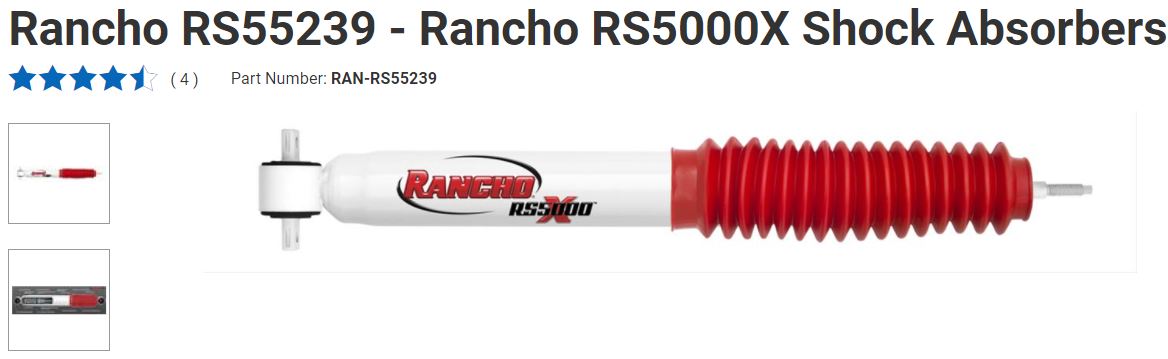

Great resource here. I'm looking for this Rancho rear shock, but it appears to only be available with stud and t-bar mount combo (front style). Maybe it's a mistake for this part number to be listed under "rear" in the chart?
Or is there a rear version available?
The RS55239 is the front shock. The rear is RS55241.
That rear one you listed would give me about 5" up, 3" down. Hmmm.
My other option would be about 4.25" up, 5.4" down (I would need to install a half inch spacer for the rear)
@Chris You might wanna edit the chart for rear shocks to remove that "Rancho RS55239 (rear)." It's on the rear list, but it's a front shock (also listed on the fronts chart).
Thanks, I took care of it!
