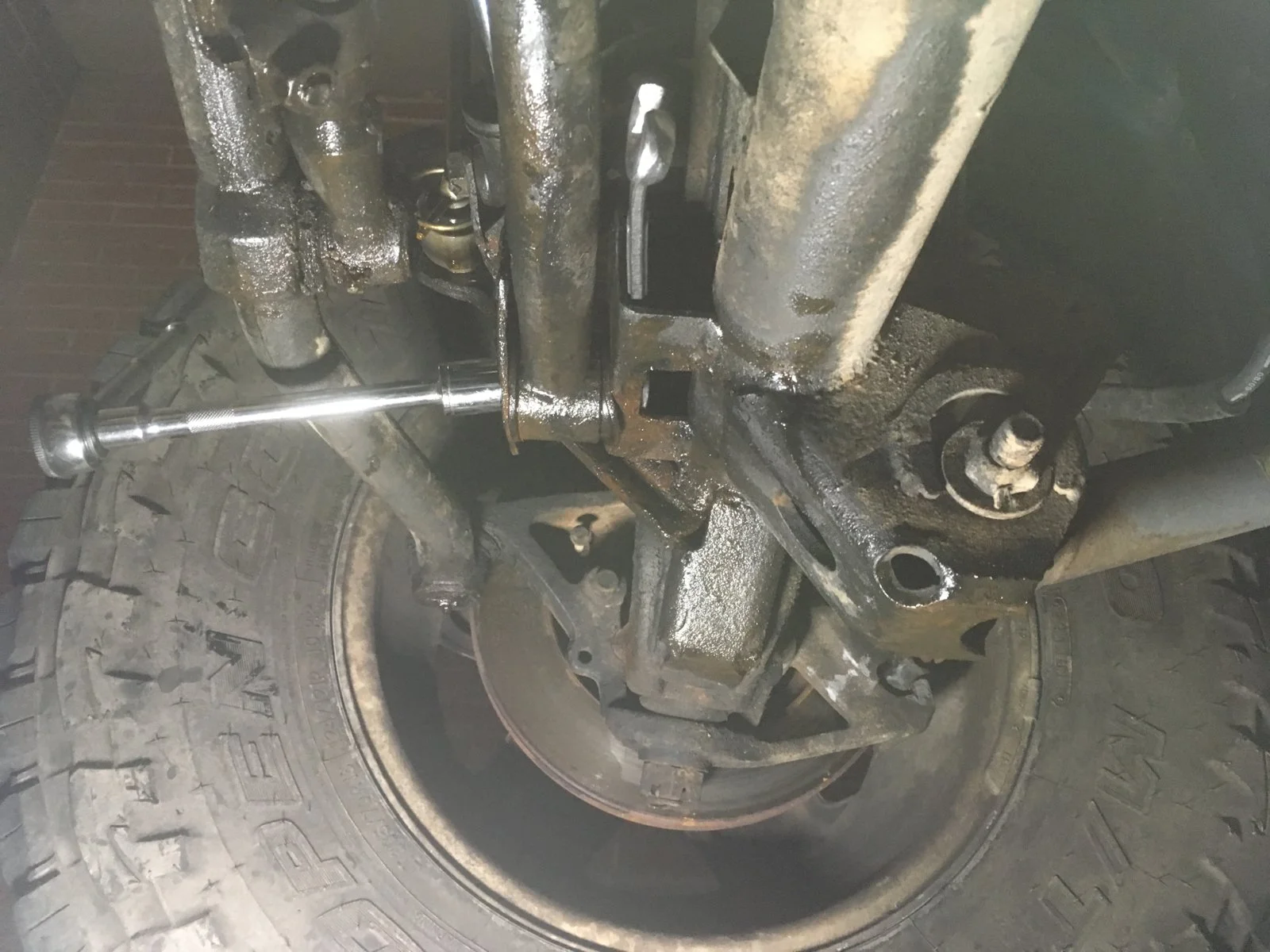

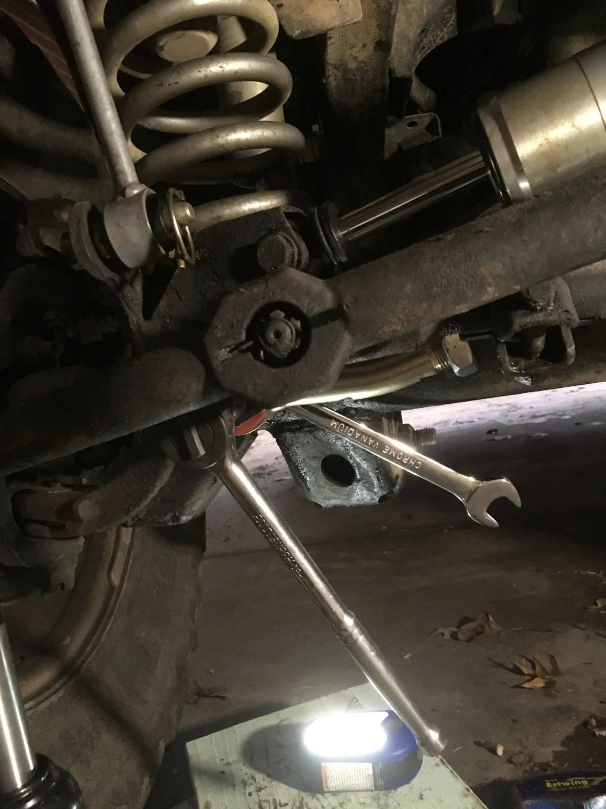

First I decided to try and get the Chassis nut/bolt out but I was not able to get it to budge at all even though I had been liberally applying PB over the course of a about 5 days. Even an impact had no effect on it so I gave up on that part for the time being and moved over to the axle bolt.

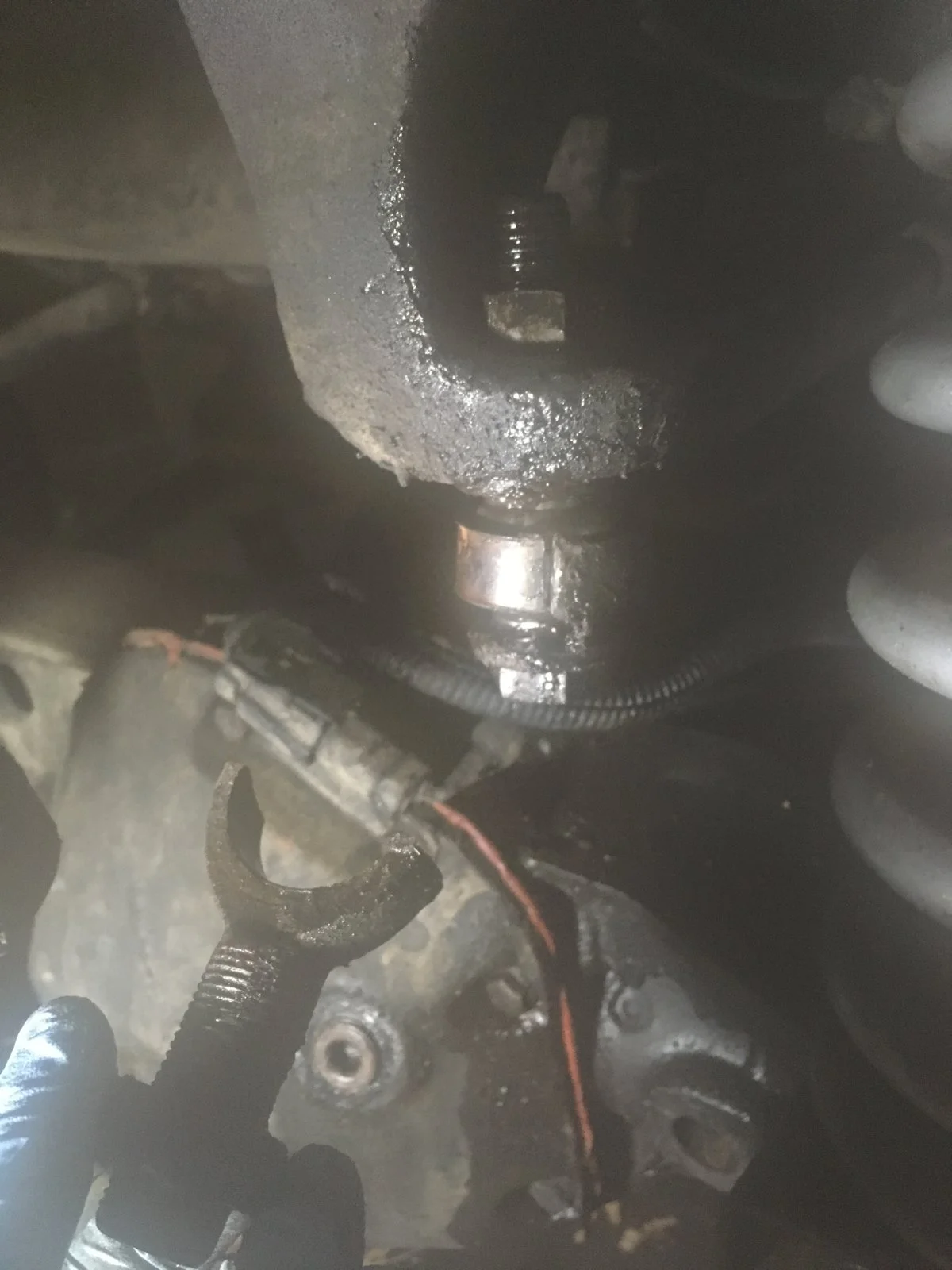

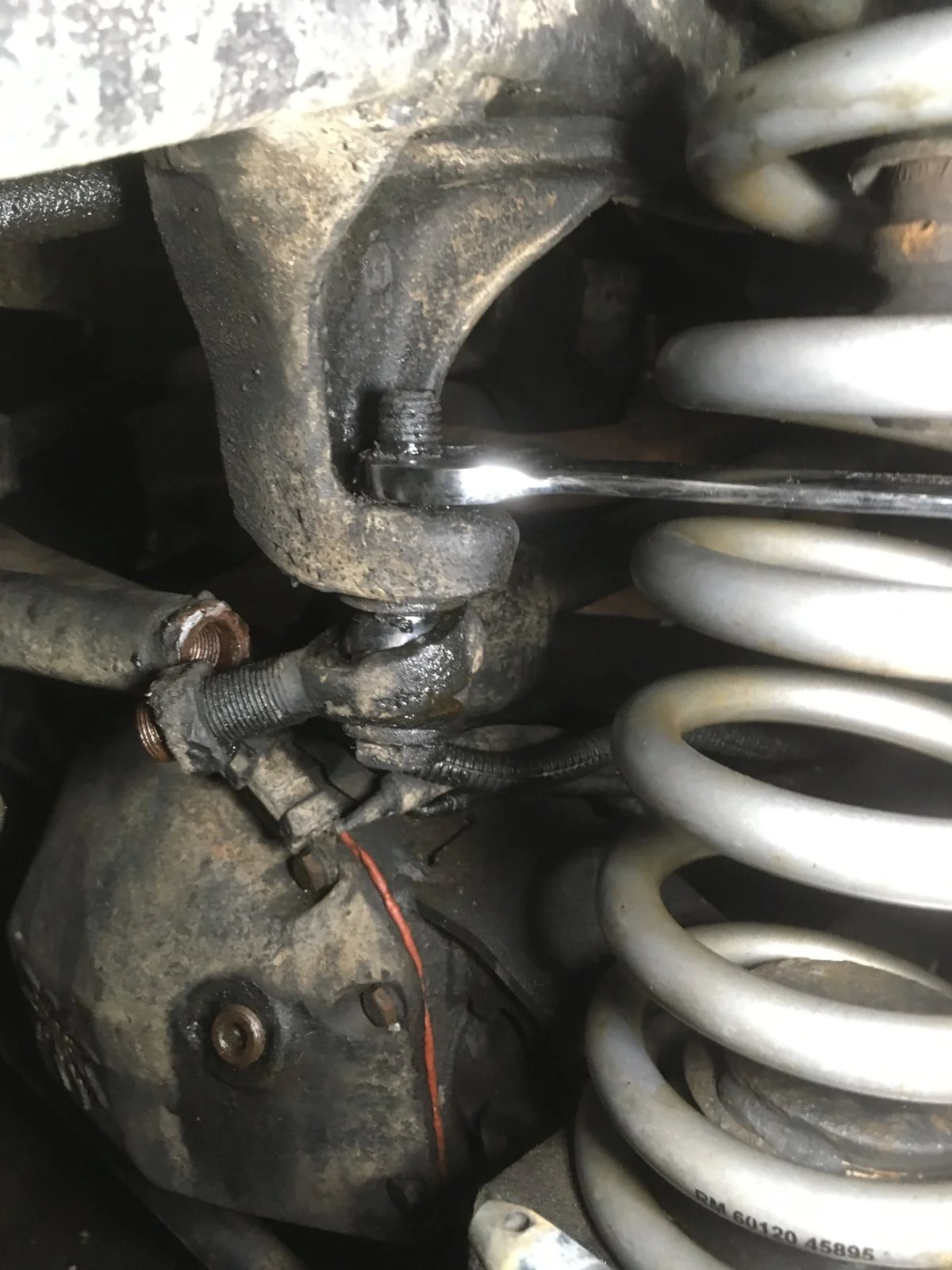

This was an interesting nut to get off. I was able to stick a 17mm Flare wrench in a little hole in the side as nothing else seemed to fit. luckily this wrench just barely fit in the small gap and I was able to easily remove the bolt.

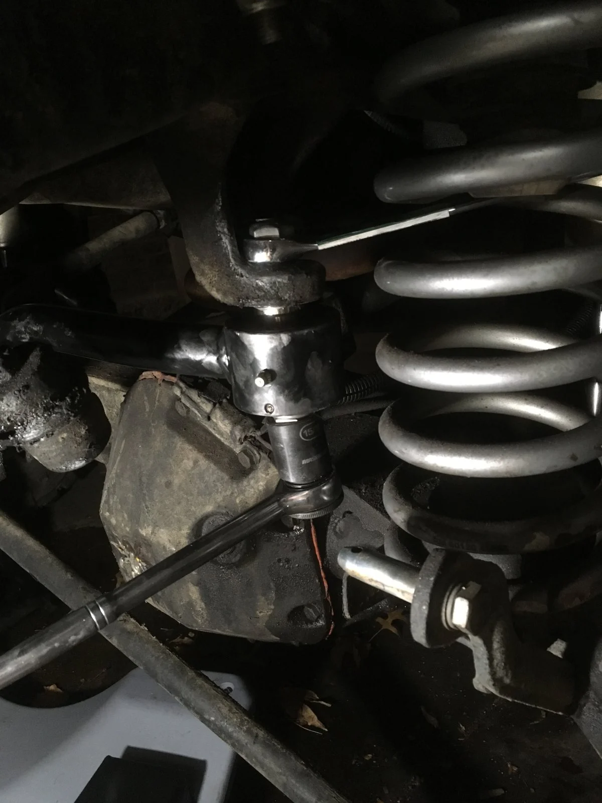

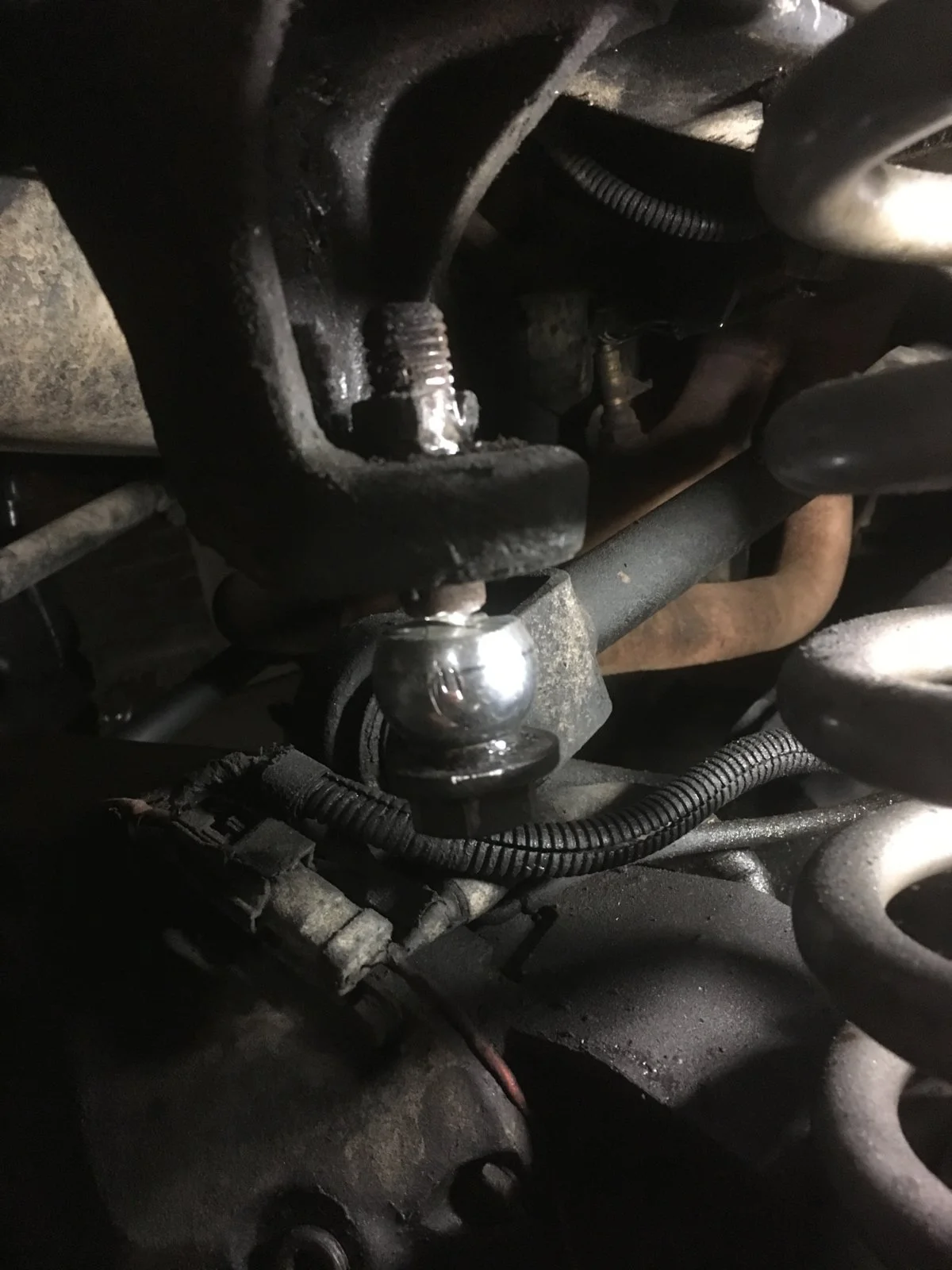

I then went back to the Chassis side and ended up cutting the whole joint off. I figured I was replacing everything anyway and I just wanted it off at that point. Using a Dremel I slowly cut it off. I tried to attack the nut but the dremel just wasn't able to get a good angle. I then decided to go for the bolt which worked fairly well. An angle grinder would have made this much easier.. and faster..

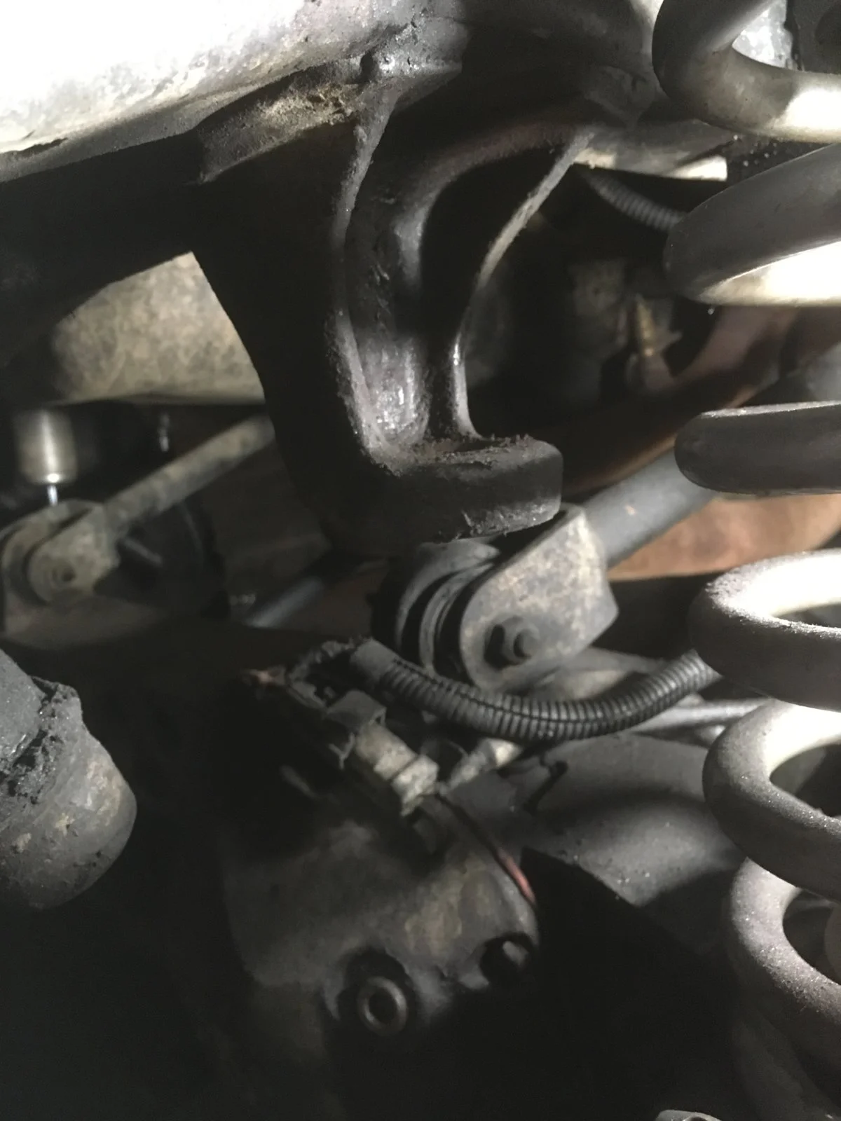

After I had the old and broken track bar bits out I was finally able to start putting the new equipment in. The instructions said to pop in the chassis side first and torque it down to 165 foot lbs if I remember correctly.

I then realized that since the bolt was larger that would mean the nut is larger as well. See that was a litte bit of an issue since that 17mm flare wrench JUST BARELY FIT. All the other combo wrenches I had at the time were ratcheting on one side and a standard wrench on the other. because of that I needed to go out and get some standard combo wrenches and I was then able to slide it in the bottom hole with ease.
I know its hard to tell here but there was a small hole in the side that I used when getting the nut off but when putting it back in, the wrench was too big to fit there again. Luckily I was able to fit the wrench in the bottom hole for the install. I forget what the torque specs were for the axle bolt but I think it was like 65 ft lbs or something.
