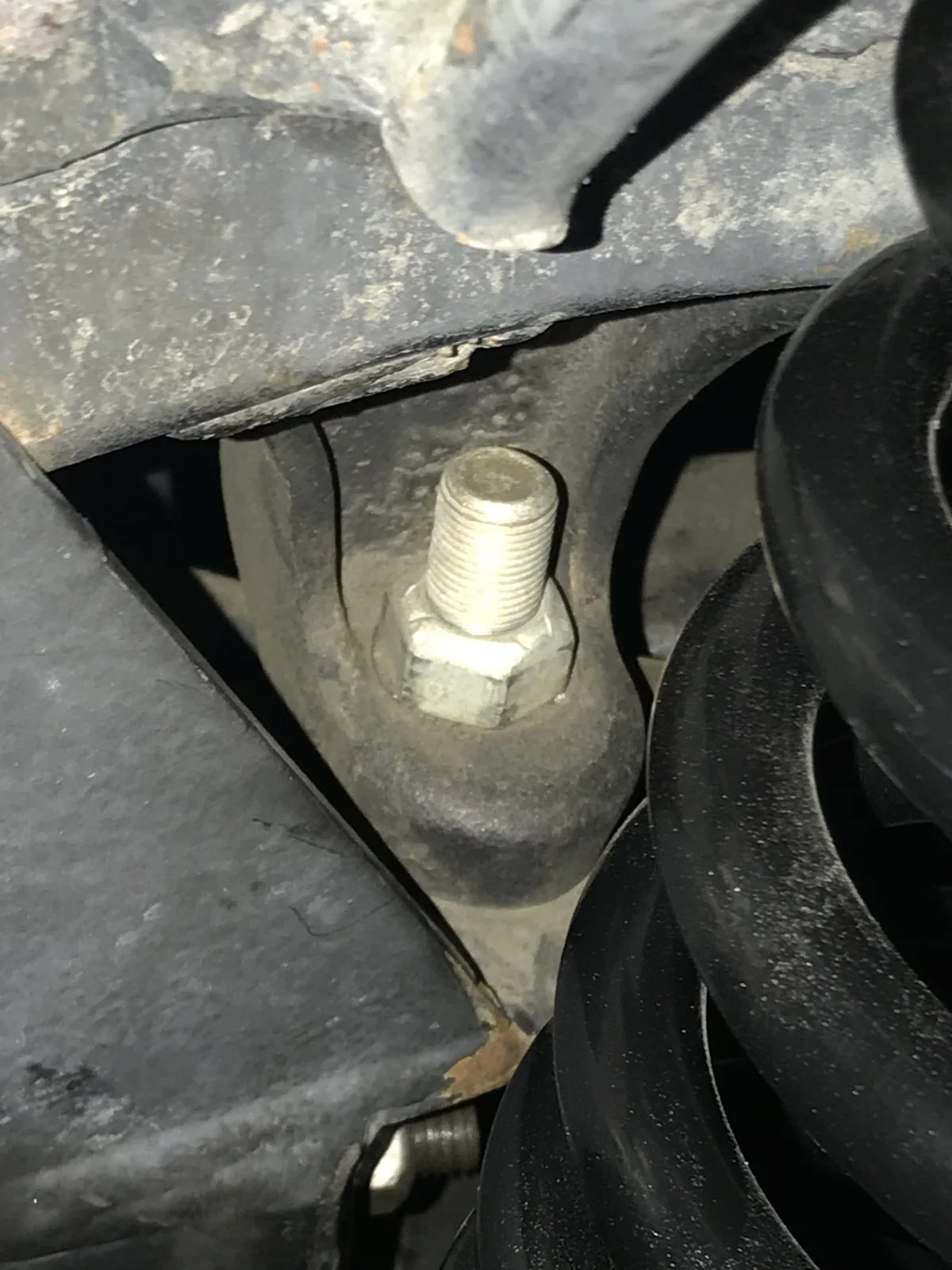

I only think the frame side is drilled. The axle side looks like its stock.
I’m not sure if you are saying you had to make new holes after the RE track bar or if you were able to conveniently use the holes you had previously drilled. Lol I read it like 3 times trying to figure it out.

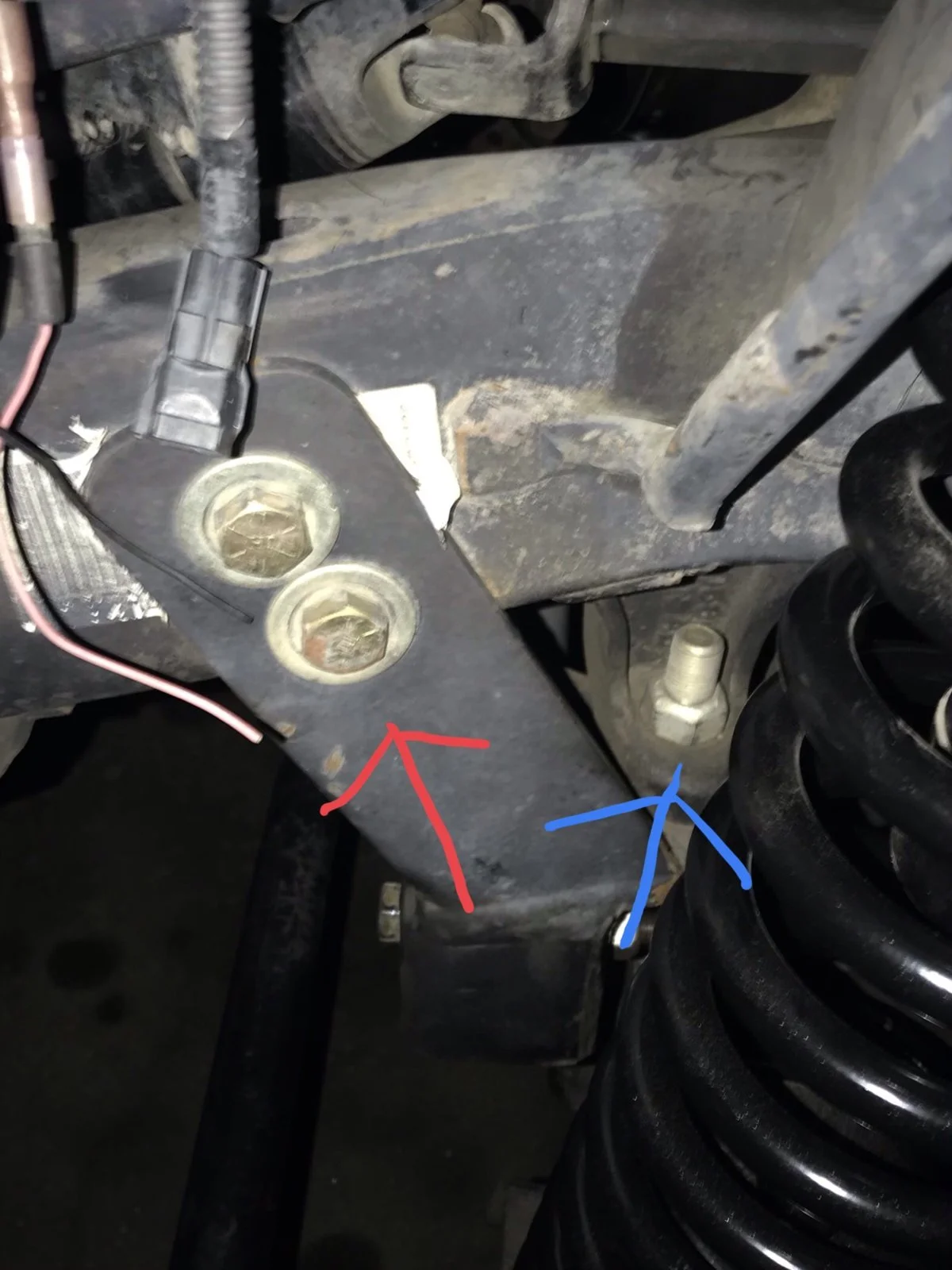

Give me like 30min I’m running to the store I’ll take pictures of the RE track bar. You’ll see why you shouldn’t buy it.

Reason why not to buy Rubicon Express trac bar. RE requires you to drill two holes in your frame(red arrow) for their adapter and I think it still requires you to drill on driver side. someone will confirm by looking at the nut(blue arrow). If I had known back then their was another option for a trac bar I would have went with currie or jks. I didn’t have this forum back then and I didn’t know what was a good part or not. I had seen Rubicon Express a lot so I thought they were good. It’s better to drill 1 hole which currie and what I read above Jks also requires you to do rather than 3 holes with RE trac bar.

In your defense I think RE used to be good in the YJ days, but somewhere they sold out to another company, and it is not the same company it used to be. I probably wouldn't have known either if I hadn't come to this Forum. Don't beat yourself up just fix the issue, and come back more often and share your new knowledge.

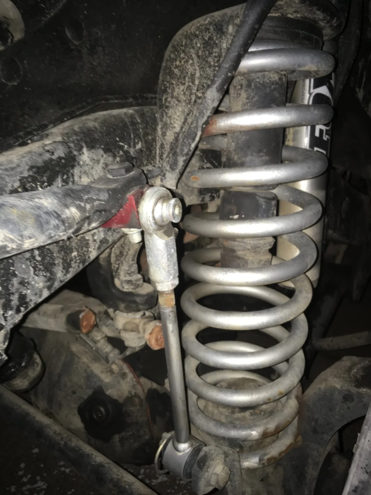

Take a very close look at the diff cover. Is there any evidence that the track bar has come in contact with it?
Have the bump stops been extended?

Well I don’t see the adapter you posted so I guess that’s 2 less holes to worry about. Lol

I took a closer look but I don’t see any nicks or abrasions that would indicate contact but It is dark and wet out side right now.
these bumpstops look extended to my untrained eye.

Nope, I don't seen any extended bumpstops there. You would see them on the bottom connected to the pad.
