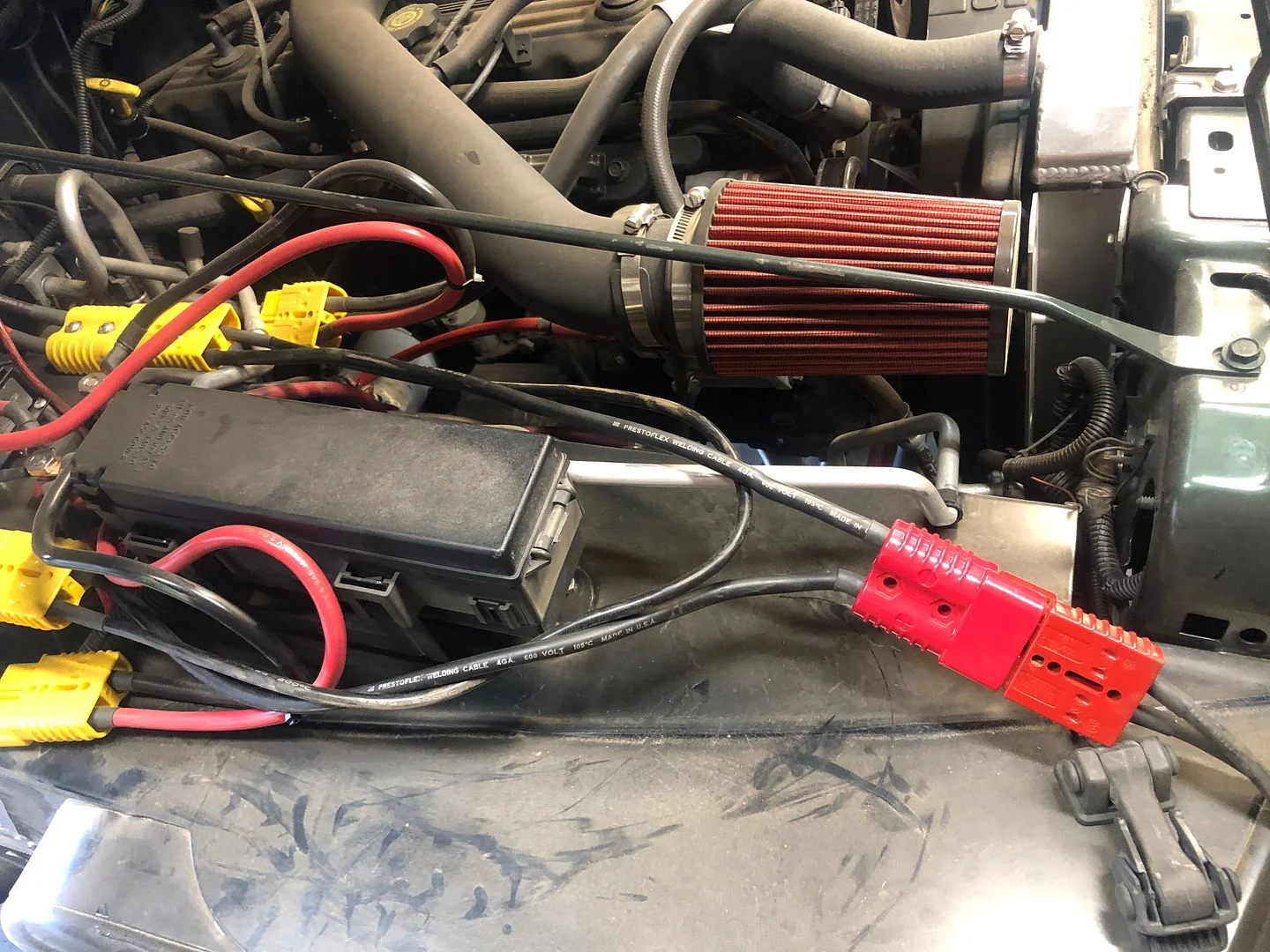

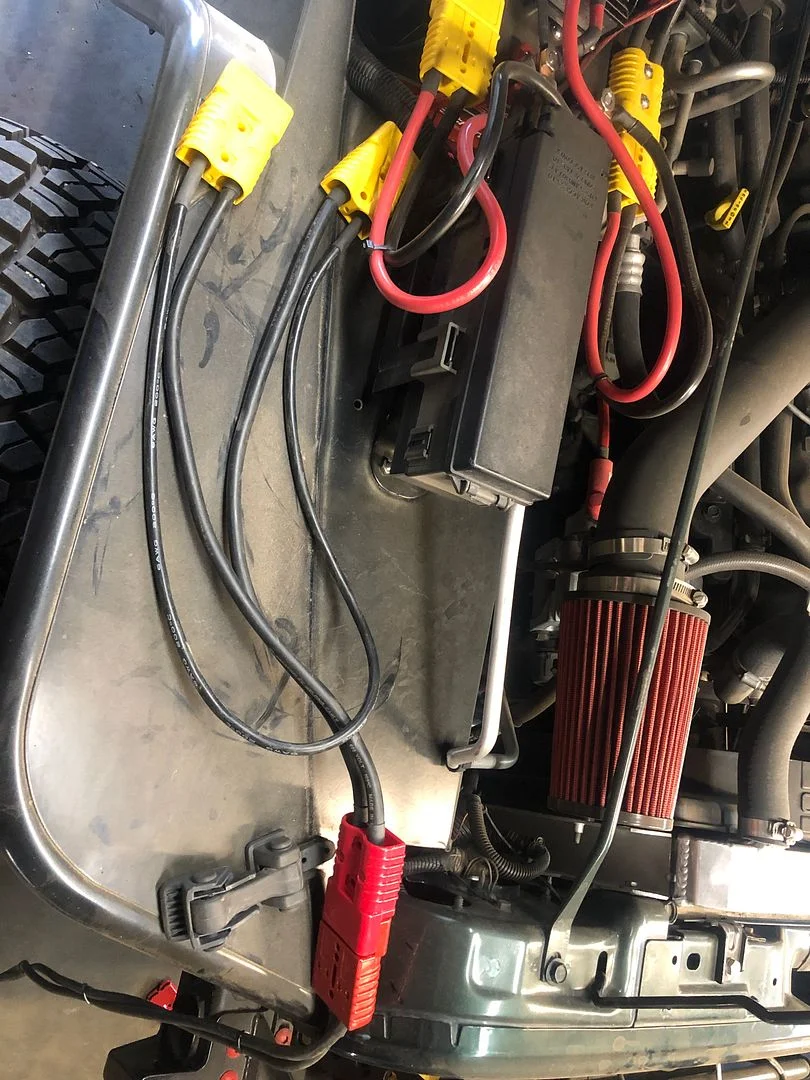

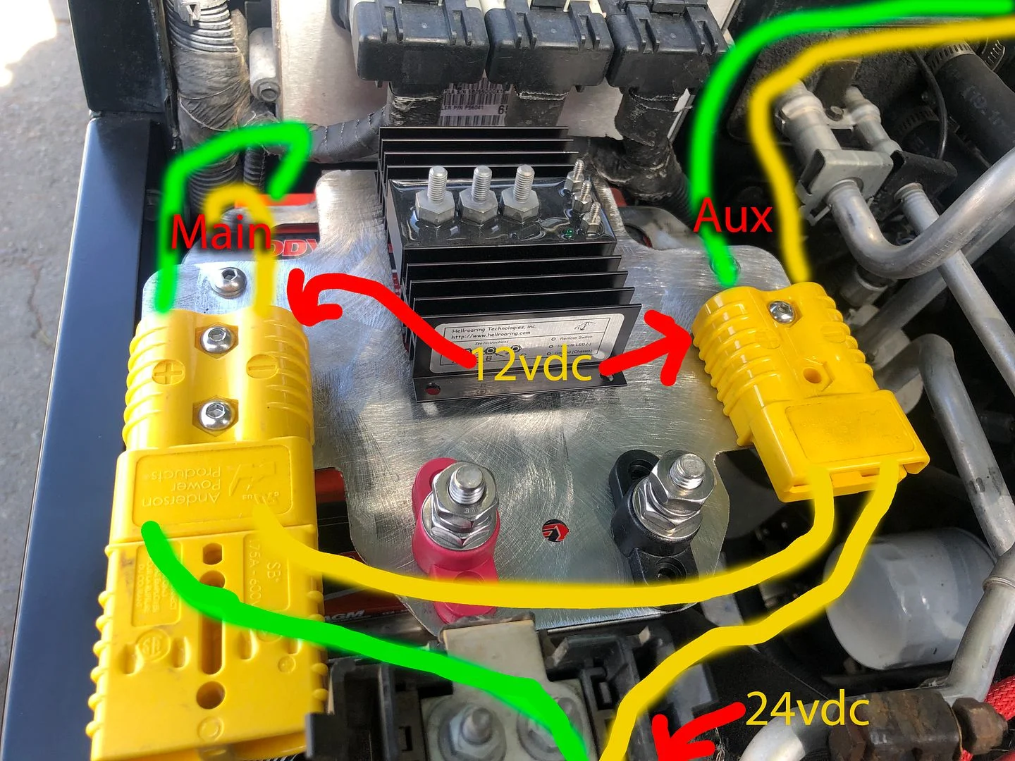

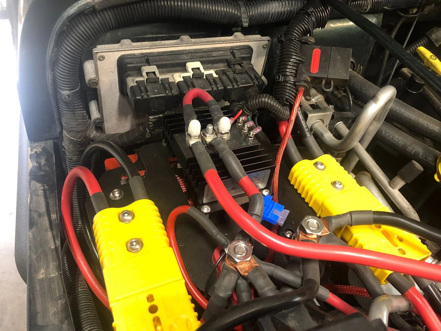

That is how mine is hooked up. In order to weld, both batteries are isolated.
@WSS thanks for the pictures and drawing. Correct me if I am wrong, you have a dual battery setup. When you have to weld, you 'isolate' your batteries by your yellow connectors disconnecting them entirely from vehicle. Then you connect it in series so you have 24v to weld with? What is the device between the yellow connectors?
It's a battery isolator because you can't have your two batteries hard wired together. No two batteries are a perfect match and if one is lower than the other it will discharge the higher one. And back and forth until they are both dead.
So there are two ways that I know of to handle this. One is with a battery isolator which does everything automatically like a Detroit locker. The other way is with a switched solenoid like I have. It's more like a ARB where you only turn it on when you need it.
It is a combiner/isolator.
https://www.hellroaring.com/battery1.php

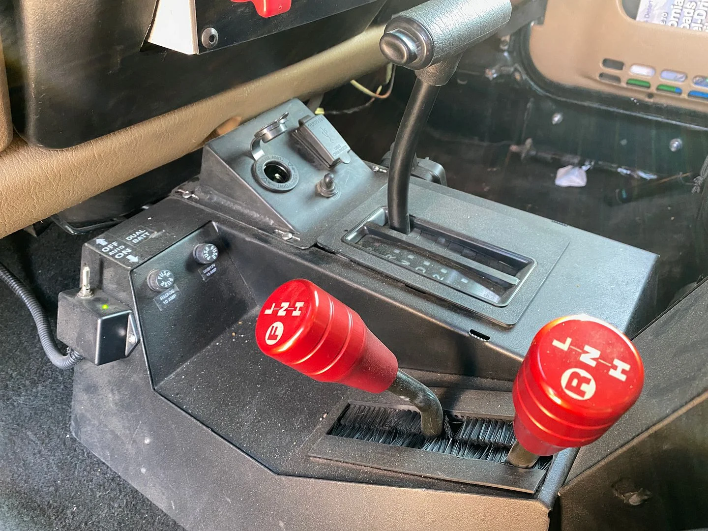

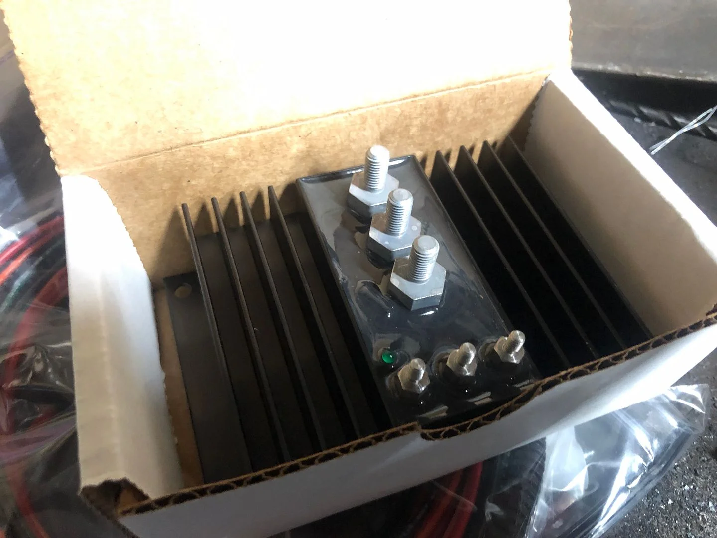

I have made isolator and combiner gigs before but this one is all inclusive and solid state, no moving relays. It has three modes, all 12v, combine, isolate and charge each. When combined, it charges both (as Rick mentioned, to the weaker specs), in isolate,each one gets same charge, in "auto", each one gets charged to it's capacity. Works really good. I have forgot and left the door cracked for a day and came back to a dead batt. Flip the swith and it fires up, then charges in bulk.
wiring kit:
It's tiny:
Better pic of it hooked up:
attached to the tuffy console:
Here it is all dirty from days on the trail:
Reactions: motomick76
My system isn't as involved but I have a normal setting where it charges both batteries at the some time but their isolated from one another. Then there is the emergency setting used if your main battery is dead you flip the switch or if you're winching you can link the two batteries together to keep your overall charge higher. and then the off setting where it turns off the isolator but then it's only charging the main battery and the Aux battery isn't being charged.
