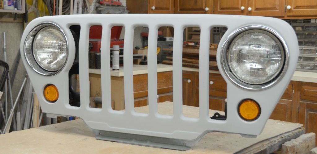

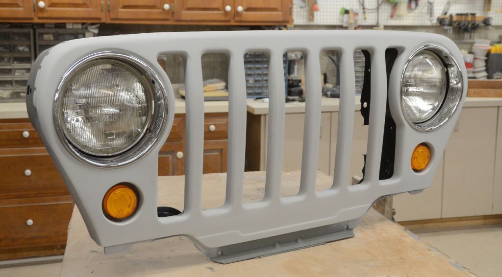

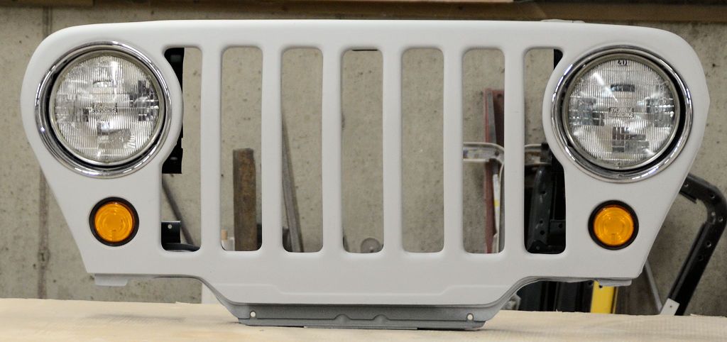

Lifting it by one fiberglass slat, it's plenty strong.
Next up: final paint (base color and clear).
