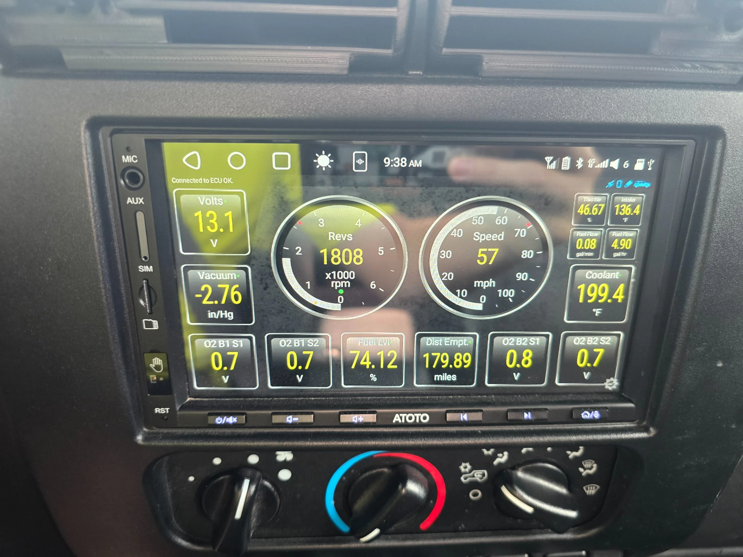

Before installing this radiator and going back to the stock fan clutch, the temperatures without the AC would run between 200-210 during driving conditions and 195-200 when idling. With the AC on, it would run around 215-225 driving and 200-210 when idling. Not sure why it was backwards other than the Hayden 2791 clutch. I never ran the AC with the original factory fan clutch.
Drove the Jeep several times Saturday evening (top off) and the engine never got above 203; and that was only a single time at peak temperatures and idling in the drive thru. Yesterday I drove it several times with the top on and AC running and the temps always stayed in the 194-199 range when driving. When idling for extended periods of time, it would creep up to around 225, but once I got moving it quickly dropped back to the 194-199 range. The AC performance is greatly increased. I'm going to attribute that to the reduced under hood temps.
The picture below is how the temp was running this morning and how I got the temps above.
If there was every a selling point for a double din screen that picture is it. what is the data running off of?
The app is the Torque Pro App and the radio is connected to a generic Bluetooth OBD2 adapter. The radio is an ATOTO S8 Ultra, which is based on Android 10. I also have their remote amp installed on the back of the radio and a Visible (Verizon) sim card installed in it. It sounds amazing and essentially operates like a tablet. It has an AM/FM app, but I stream all my audio via either the Sirius, iHeart, or YouTube Music apps.
EDIT: The fuel level and range remaining is all estimated based on the app running and fuel flow reported by the PCM. I have Tasker installed that auto starts the app as soon as the radio is powered on. The only downside is I have to manually go into the vehicles profile in the app every time I fill up to tell it the tank is full.

I have a scan gauge that is that way on the Fuel. It beeps at you warning your out of fuel if you don’t reset. Super annoying part of that feature. is Torque app the same way ?
You don't have to put the fuel level or DTE gauge on the screen. All the gauges are customizable to your choice. When choosing, it will light up green the PID's the app can see from the PCM. You pick the PID, gauge size, style, and location.

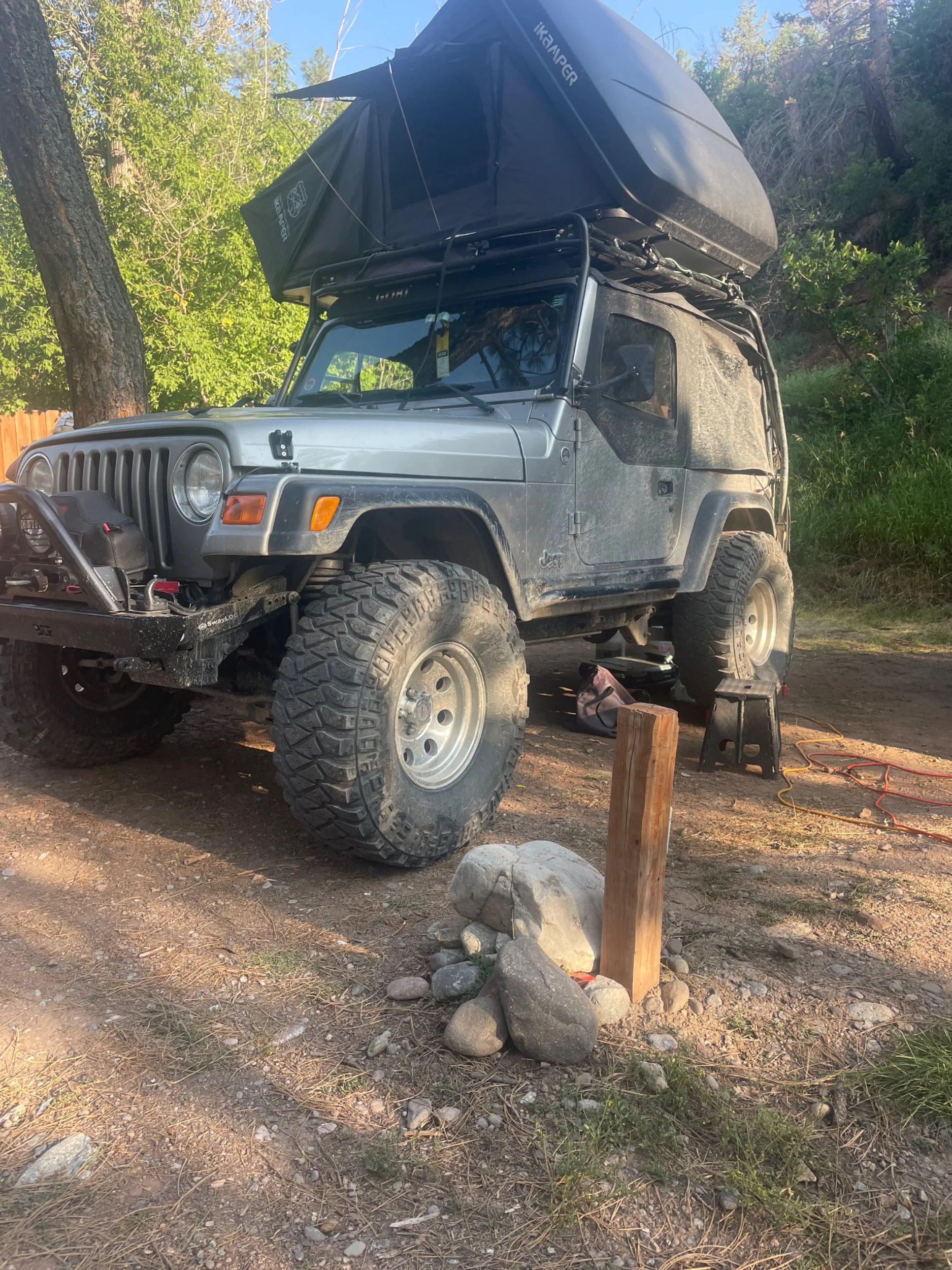

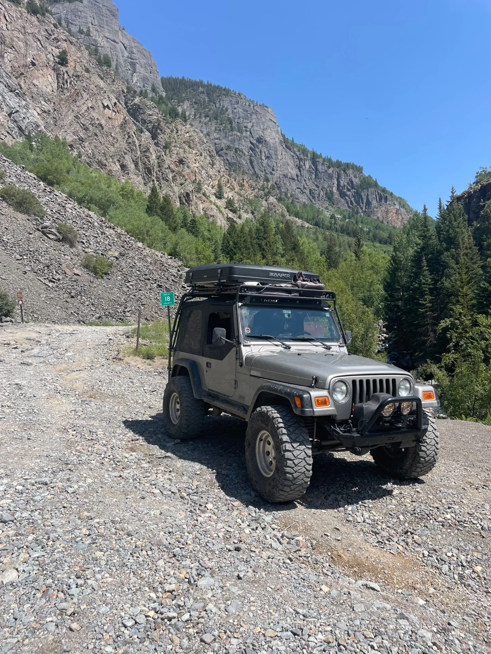

In Colorado doing all the trails

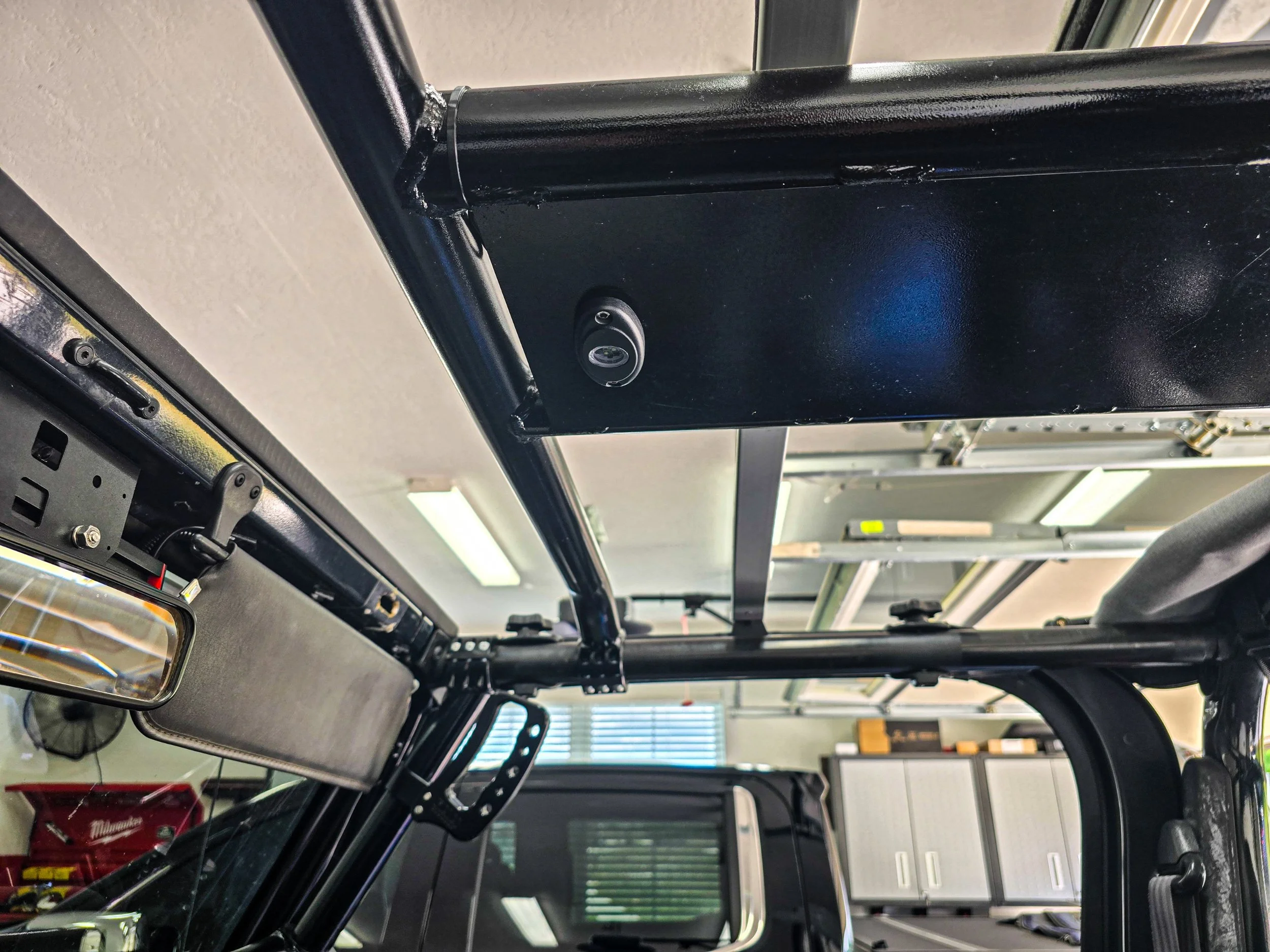

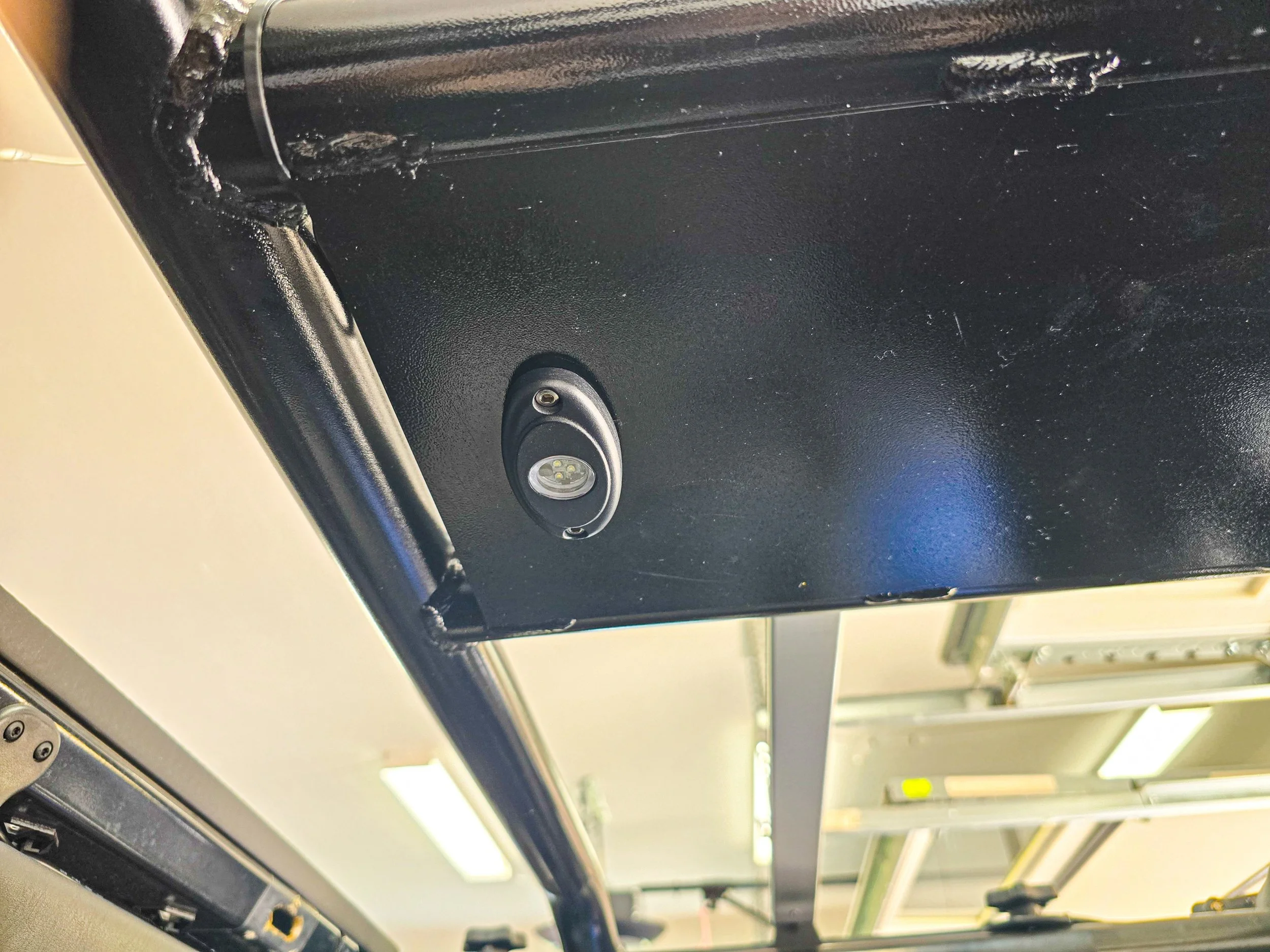

Installed a left over rock light from Nightlite as a front dome light. The light is actually around 6k temperature. My phones camera made it look more yellow.

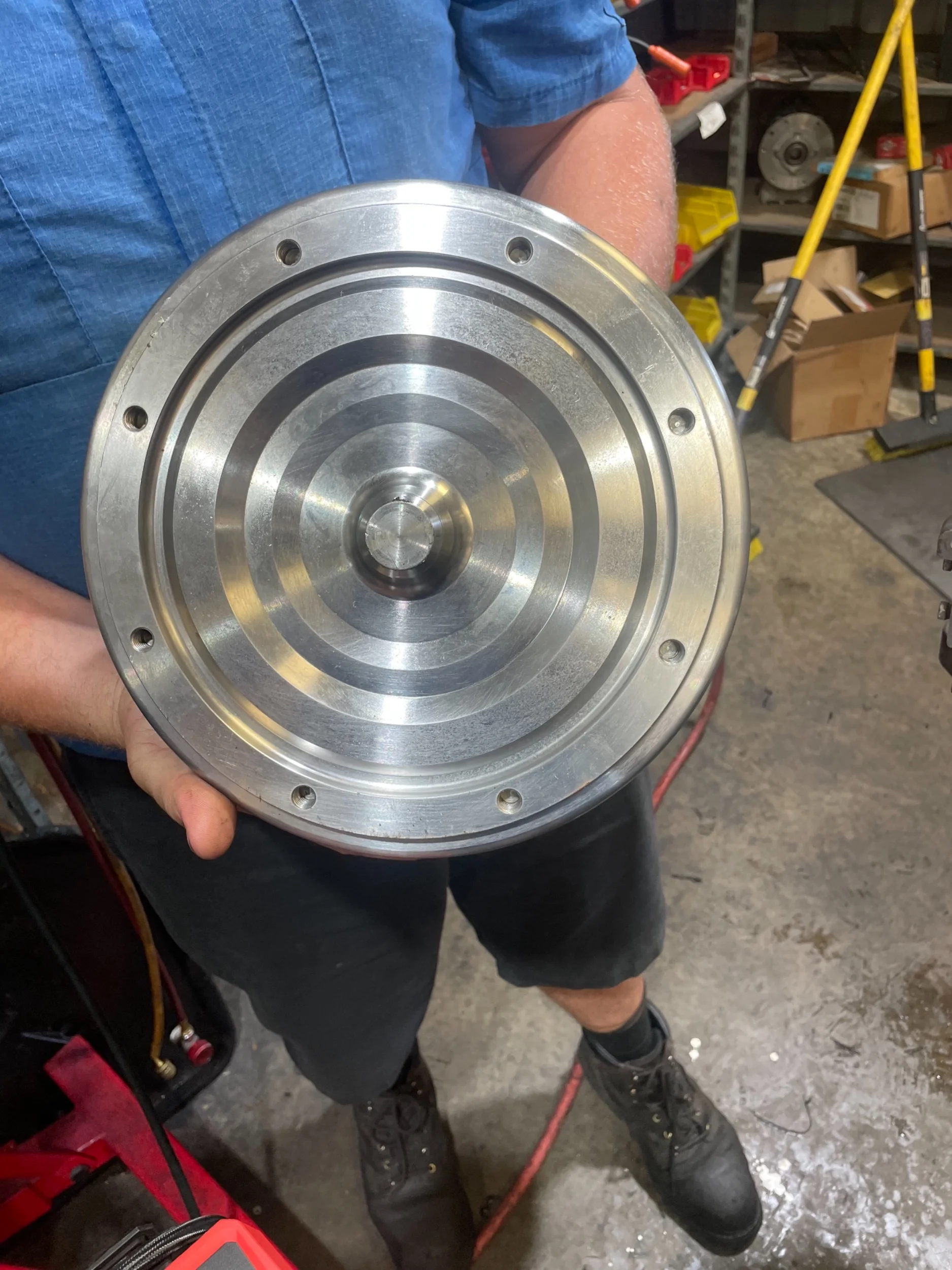

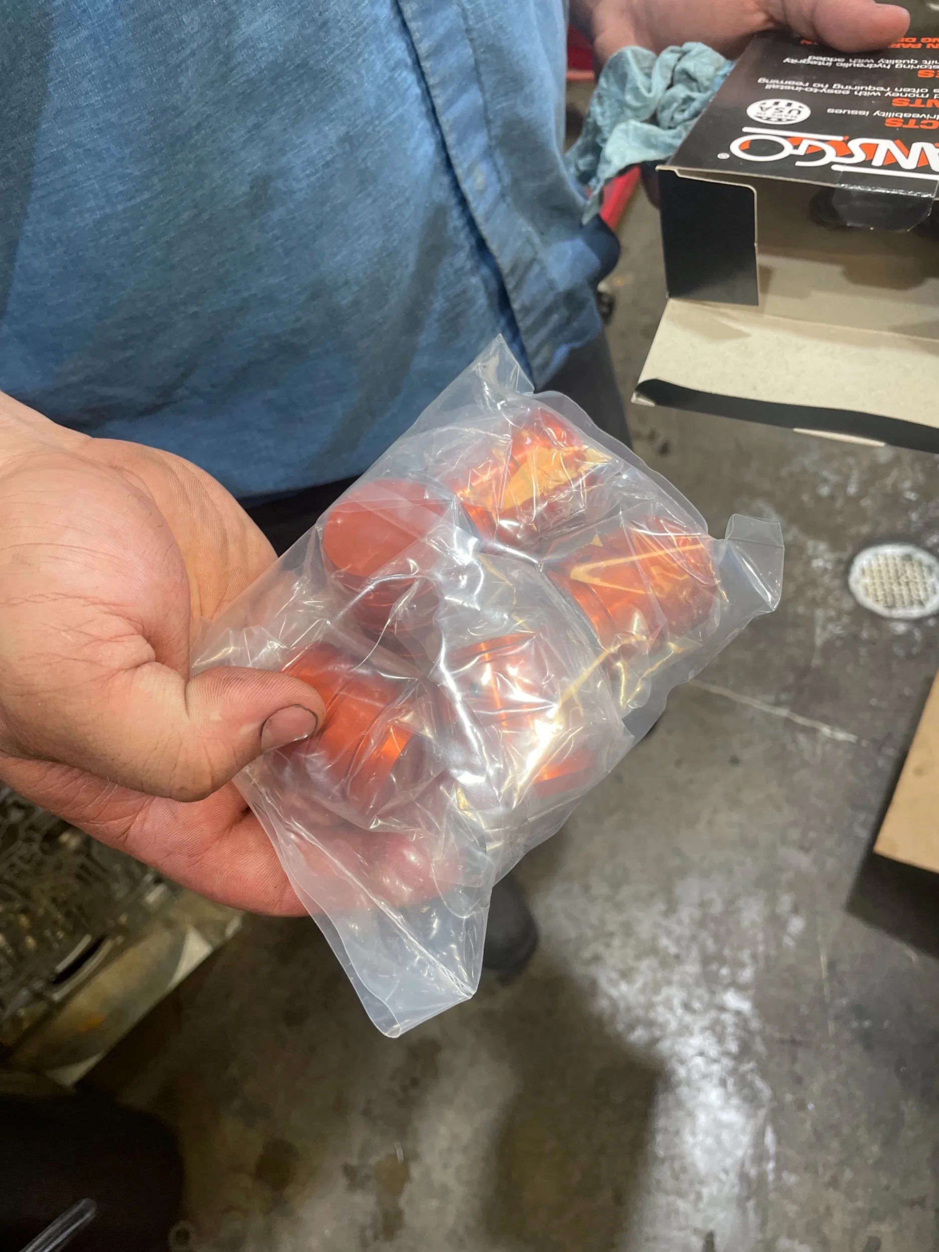

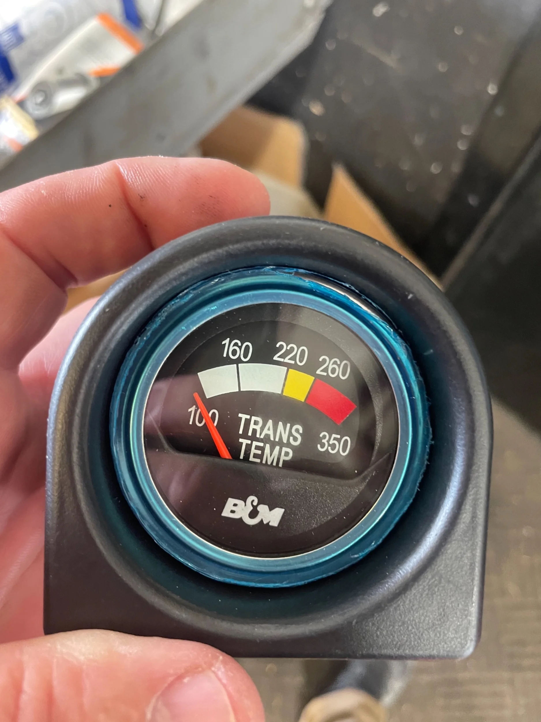

Billet torque converter and shift pistons going in , along with temp gauge and cooler.
Any of you guys know the 42 RLE is made in 2 versions....05 brought in a non variable line pressure model. Was news to me.
Gauge will be left of the cluster on the dash at an angle, 3m double face taped with extra wire to relocate later.

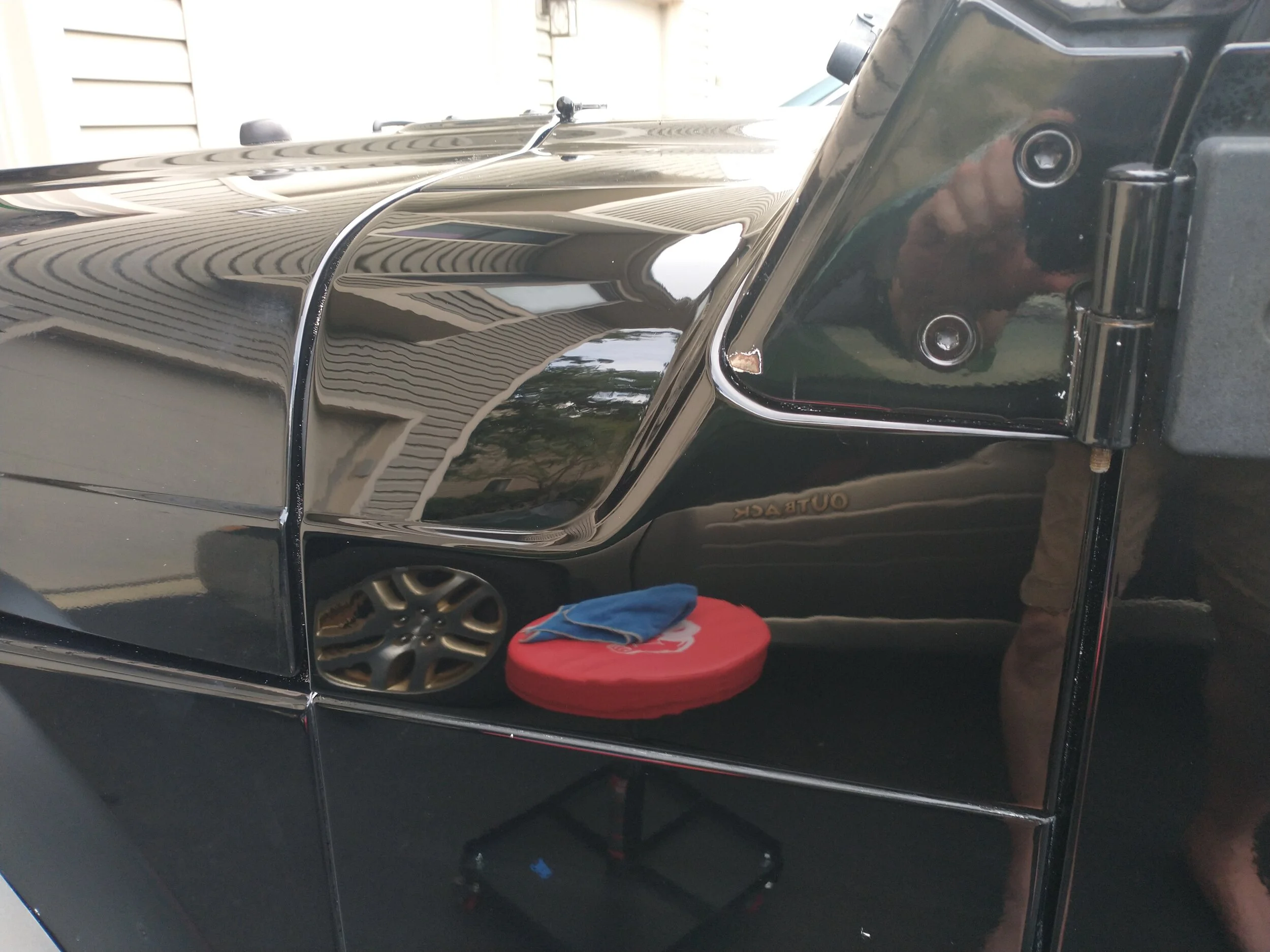

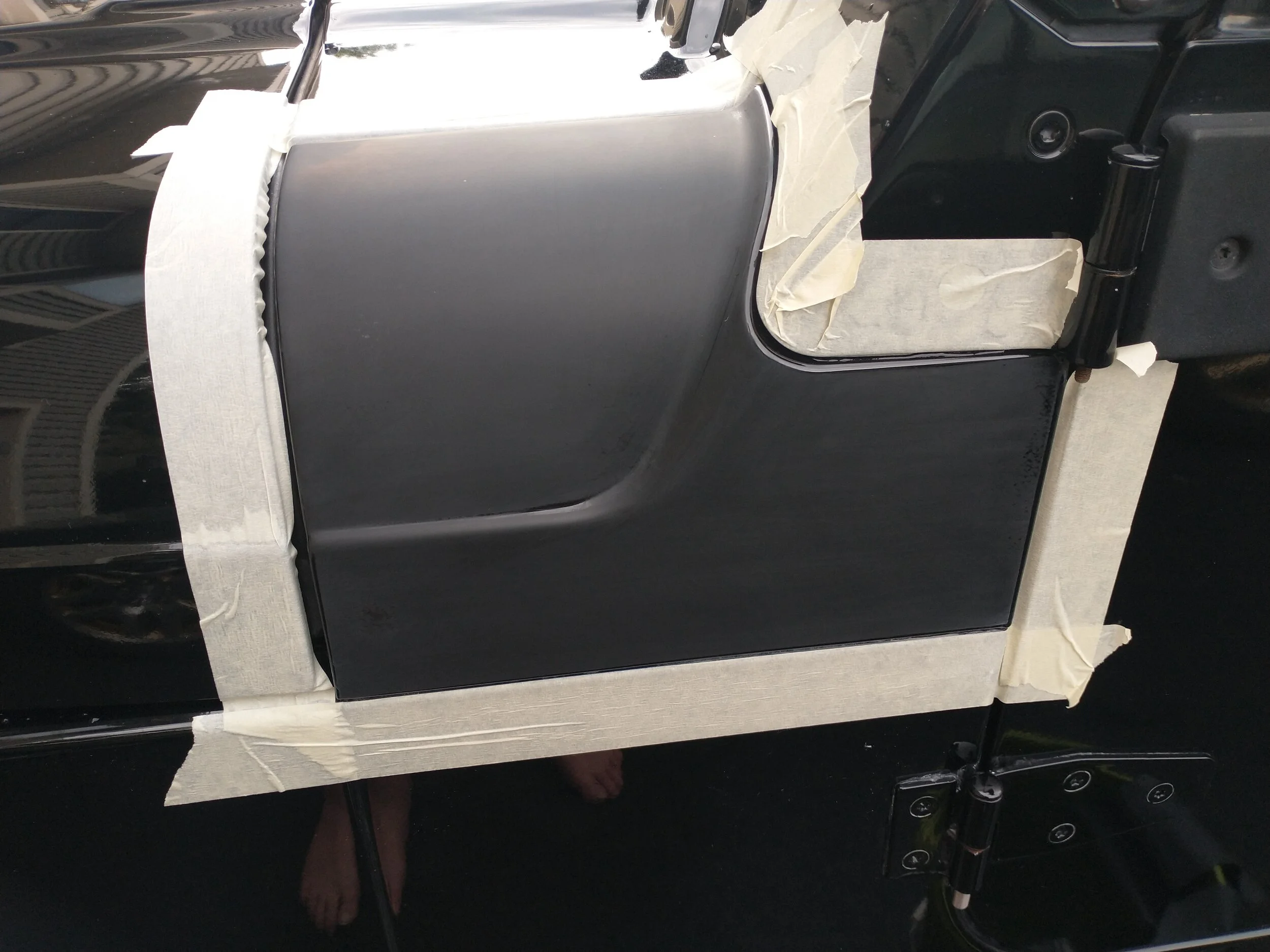

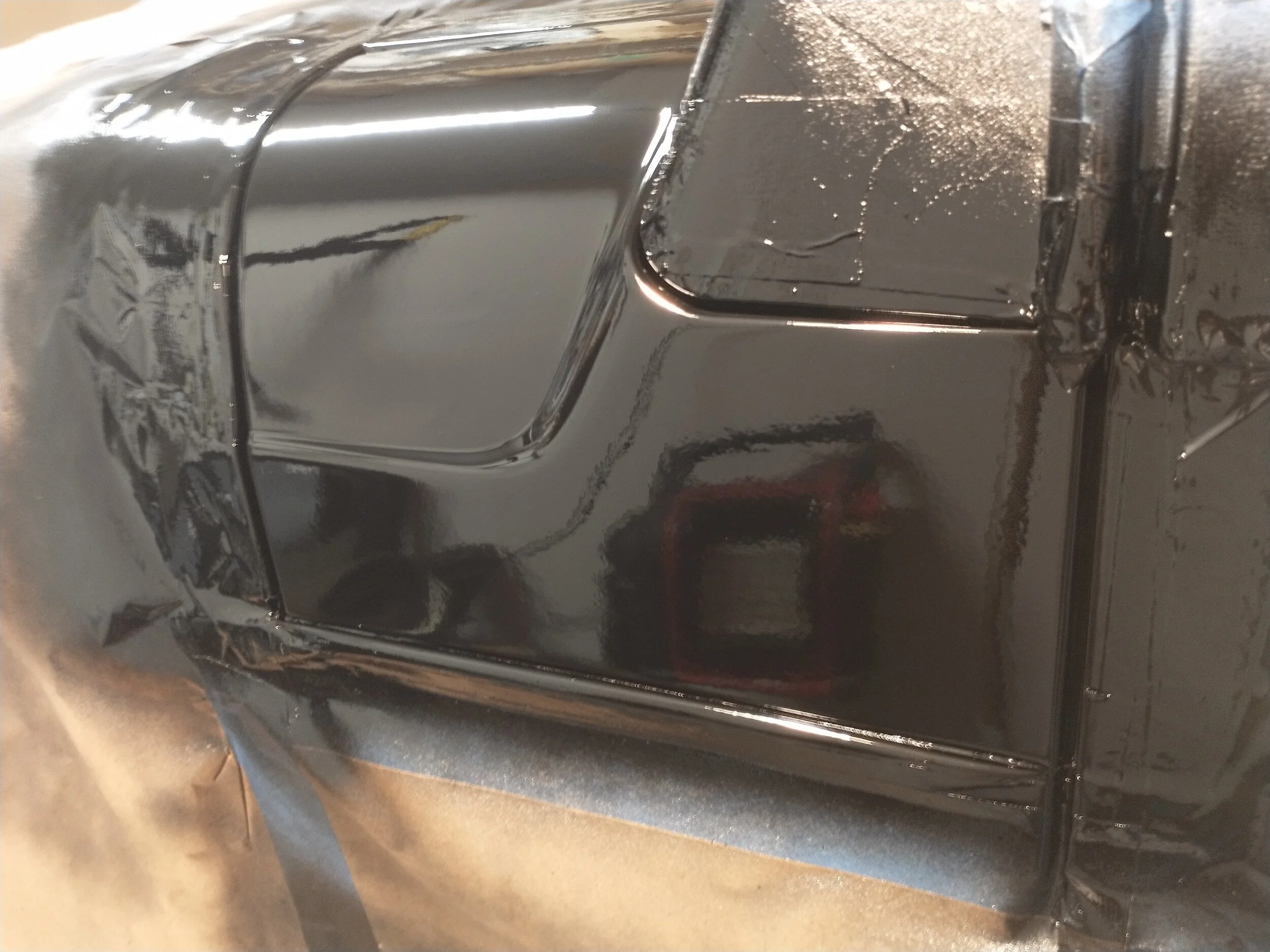

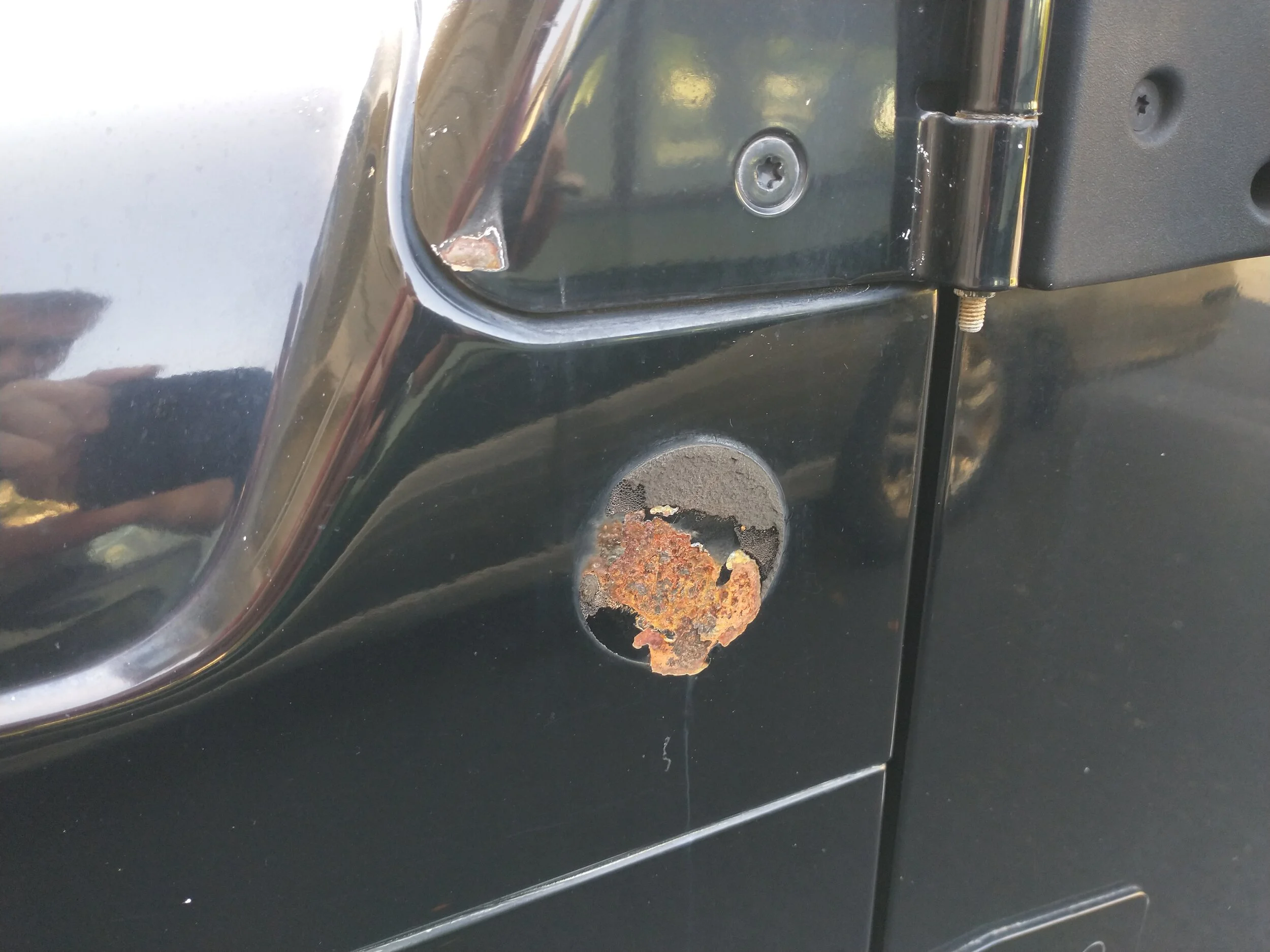

Finally got around to finishing up a body repair this weekend that I started last November. My LJ had one rust issue when purchased in May '23, a nice blister formed over many years under the "Trail Rated" logo on the driver side.
I cleaned out the rust and shot it with a couple coats of color followed up by a catalyzed 2k clear coat. Not too bad for rattle cans in my garage in winter but I had plans to do more with it when the weather improved.
After letting things cure well and, quite honestly, forgetting about it for a few months, it was time to flat and polish the area. After 1500 and 2000 grit wet, hot enough to melt the balls off a brass monkey so the wet sanding was a welcome task.
After a few passes each with compound, polish and wax. I'm old school and used to using corded cast metal buffing machines with wool bonnets, but I managed this with a Ryobi 18v cordless 5" DA polisher and a variety of foam pads. I snagged a red "Trail Rated" emblem from a Trailhawk (?) to replace the original gray one, thought the red might look sharper on the black.
Pretty happy with the results, the only suck being that I now have abolutely no choice but to polish out the rest of the vehicle. :D I don't think that clear coat has seen love since it left the stealership back in '05.
