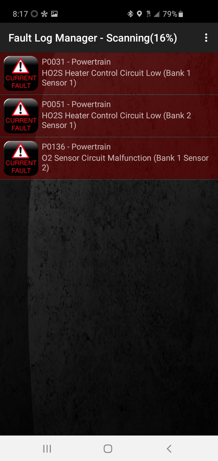

Is this all the codes?
I bought a Mopar crank sensor yesterday. Put it in tonight and cleared the codes.
I expect the evap leak codes will return.
The o2 codes have been there since right after purchasing the jeep last year.
Drove it around for 40 minutes. Like nothing ever happened.
A fluke? Mopar sensor or no sensor?
Time will tell......
Evap code is likely just your gas cap
Unless you replaced your sensors, those o2 codes will likely be back.

Gas cap is new Mopar last year. o2 sensors are new last year (NTK). I had one o2 sensor code and one evap leak code, if I recall from when I picked it up January 2019. After replacing the 1 o2, sensor (and the valve cover gasket), I ended up with 3 or 4 or 5 other codes. So, I replaced them all. Those 3 are still there. The crank sensor fixed all the misfire codes, coil circuit codes, etc. Last fall, I found one connector at the 2/2 sensor that was corroded and bare wires. Spliced in a good one, and no change. The o2 heater fuse (15a) blows almost immediately after starting. Gonna start looking for cause there soon. Just happy to not have all 13 or 14 codes and the bucking, chugging, and barely running anymore. For now at least, LOL.
ahh, I see why you're happy with only 3 codes :D
I have a stubborn evap code that kept coming up. Recently had to have a new fuel pump installed and haven't had the evap code since. Maybe there was a leaky vent hose or something. Seems MIL codes are part voodoo sometimes.
Good luck with your detective work. Will be interesting to see if you find the problem.
