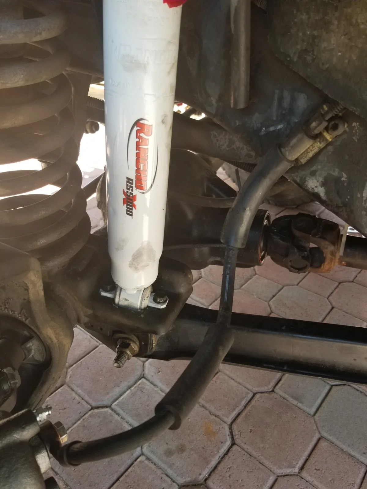

There's 2 bolts on the bottom. Are yours like that? But it's weird bc it looks like the hole on the bottom of the shock sits in the frame?
That's how the front shocks mount. Two bottom nuts and bolts and one top nut. The rounded bottom of the shock protrudes down through that small square opening maybe 3/8".
Reactions: Matt77
There is a nut on the bottom of each bolt.
