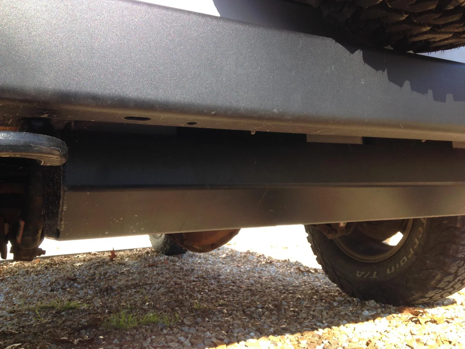

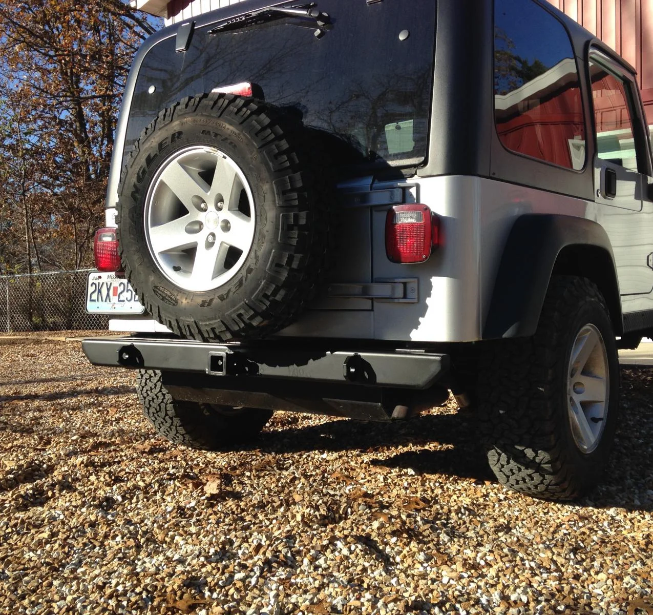

I installed Genright's 24.5 gallon tank and the GM hose. Tank and skid plate are made well.

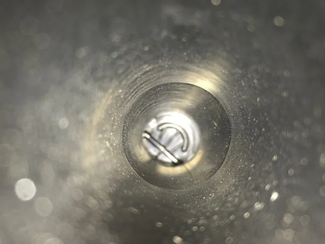

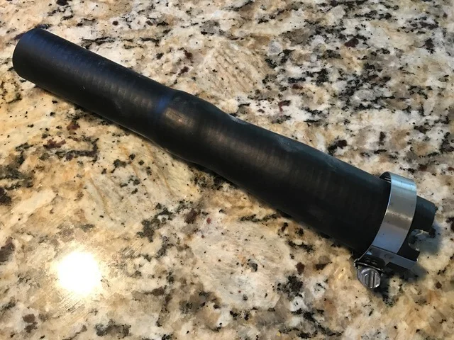

So, I'm doing it myself and I'm just curious.... This is probably a dumb question, but the flapper valve can only go one way and I'm confused as to if it should flap open "down" or flap open "up" In other words, does the gas going into the tank open the flapper? If this is the case, then is the flapper open normally and closes only when the gas comes back up the hose? It just seems like the valve is upside down in this hose I bought. When I hold it hose clamp up, the flapper is closed....no gas could possibly go in. The first photo is narrow end up and the second photo is wide end and hose clamp up. Many thanks for any help.....
