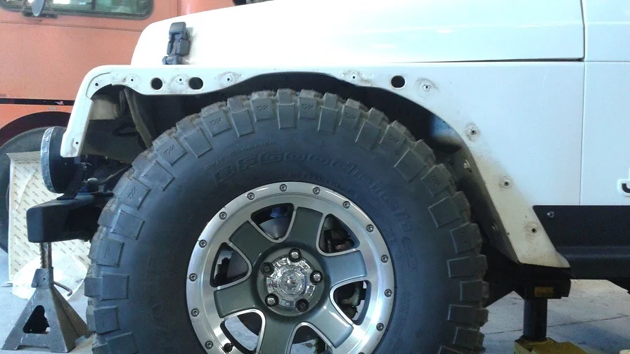

Second, the person at Quadratec said all I need to do to run 33's is add a flat fender kit such as Bushwacker or Xenon. I asked about a 1.25' body lift and that seemed frowned upon. I was thinking I may not have to do the fenders if I did the body lift, and the body lift is much cheaper. What are your thoughts? And while your at it, what are your thoughts on Bushwacker vs Xenon as well as 4" or 6" width, keeping in mind the 33's coming on 17x9 wheels with backspacing of 4.75"?

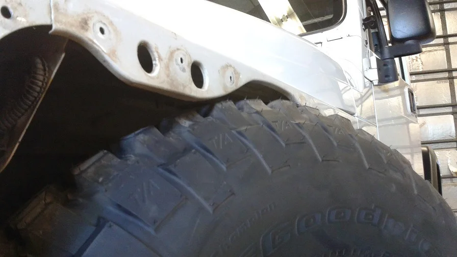

Idiot advice if you ask me. If you run 33" tires on a stock height TJ, you'll run into a lot of rubbing issues, even with flat fender flares. To run a 33" tire, you really want 3" or more of lift. An idea combo is the 2.5" OME lift and a 1.25" body lift. That setup is widely regarded as one of the best you can get.
Bushwackers are GARBAGE. I can't stress that enough... There's a reason people refer to them as Bushcrackers. They break easier than you can imagine, and IMHO, they look ugly as sin. I don't have any experience with Xenon though.
Third, should I do the tires and wheels first and see if they can fit under stock flares? Or do the flares or body lift first because if I don't I'll get myself in trouble? I appreciate feedback from all you guys with years of experience. Here's a pic of the Jeep with the 2"BB
Not if you're doing 33" tires. If you're doing 33" tires, you should do the LIFT first, then the wheels / tires.

I'll confirm what everyone has said. I have a 2.5" lift, MC fenders, and 33" MTR's. I love the way my jeep is, but 33's can be a pain at times (read anytime you have to take the tires off).
And flat fender flares are only for looks. They add zero functionality to the jeep because if they tire ever contacted them, they'd just move out of the way like they were designed to do. You can easily cut your stock flares to be "flat flares". Unless you just really love they way a certain brand of flat flares look and can't live without them.
From what you guys are saying, I already have 31x10.5 Goodyear Wrangler M/T w/Kevlar. Maybe I should stick with those for now, get some better looking 15" rims, and if I want to add a body lift I could go to 32's later (or something like a 285/75r15). That way save some bucks on tires and still get the look I'm looking for. That would certainly be cheaper. Thanks for help guys. More opinions are appreciated...I like advice, but not very much from those who are trying to sell a product.
This is what I would do. You'll hear a lot of us say (myself included) that if we could have done it all over again, we would have just stuck with 31" tires and a high quality, small lift, such as the 2.5" OME lift.
