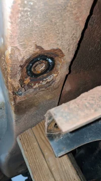

It looks like I've got a little rust problem on the drivers side torque box (I think that's what that is? Middle body mount). Probably will need to deal with that eventually
I have a real bad spot on my passenger side too I've been meaning to fix. I'd like to swap sliders before I do though
Reactions: lBasket
Looks like replacement panels aren't too expensive, the work is probably really involved though huh
Also what sliders have you got are those the Warn ones? Are they gonna be for sale đź‘€
Poison spider which use the body mounts. You don't want a slider that mounts that way, find one that mounts using the tub and is wheel well to wheel well.
