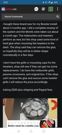

This is a great 5.25" component set that is pricey but you can bring with you to any car audio build after the Jeep.
I am unafilliated with this posting.
https://www.diymobileaudio.com/threads/morel-virtus-502-5-25-component-set.428247/
More details on Crutchfield
https://www.crutchfield.com/p_210VIR502/Morel-Virtus-502.html
