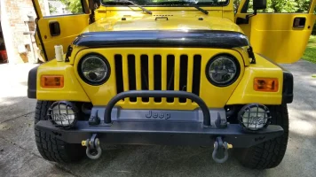

Changed the dropped pitman for a stock one. Drives so much better, no more bump steer.
Centered steering wheel and adjusted tie rod ends to equal length.

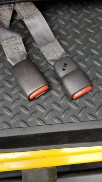

So, earlier this week, I replaced the passenger seat belt because sometimes the seatbelt would get stuck between the cover and the receiver and wouldn't latch properly. Since I was furloughed today I took the old one appart to see what had caused it. It looks like the back of it was missing some material. That allowed the latch mechanism come out and then to slide up in the cover and not be tight. I think if you are experiencing this, it could be repaired by sliding the sheath off that goes down to the bolt and putting something to hold the mechanism tight against the sheath, (then slide the sheath back up.) I swapped mine, so I didn't need to try to repair it. I had another use in mind for the broken one.

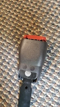

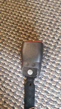

I was able to take the old cover and Dremel it out to make a cover for one of the seat belts for the back seat. Mine was missing it's cover. I had to completely take the receiver apart so I could slide the cover over it. I then put the receiver back together and slide the cover up. A zip tie is holding the cover in place. (The holes were already there, so I decided to use them.) The shape of the cover is slightly different, but it is better than just the raw uncovered mechanism.
Before
After

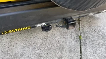

I finally got around to wiring up the connection for a trailer. I've had the parts for 6 months. Pretty easy install. It just plugs in behind the driver side taillight up in the wheel well.
