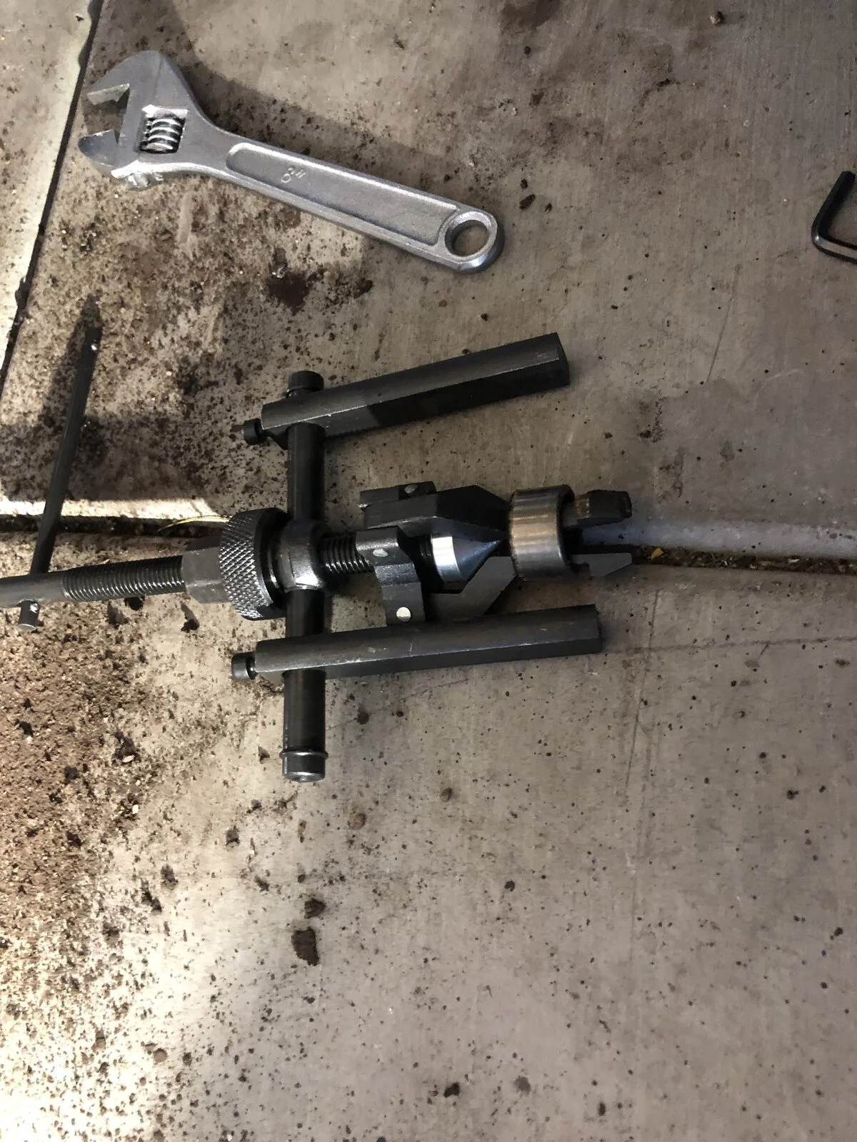

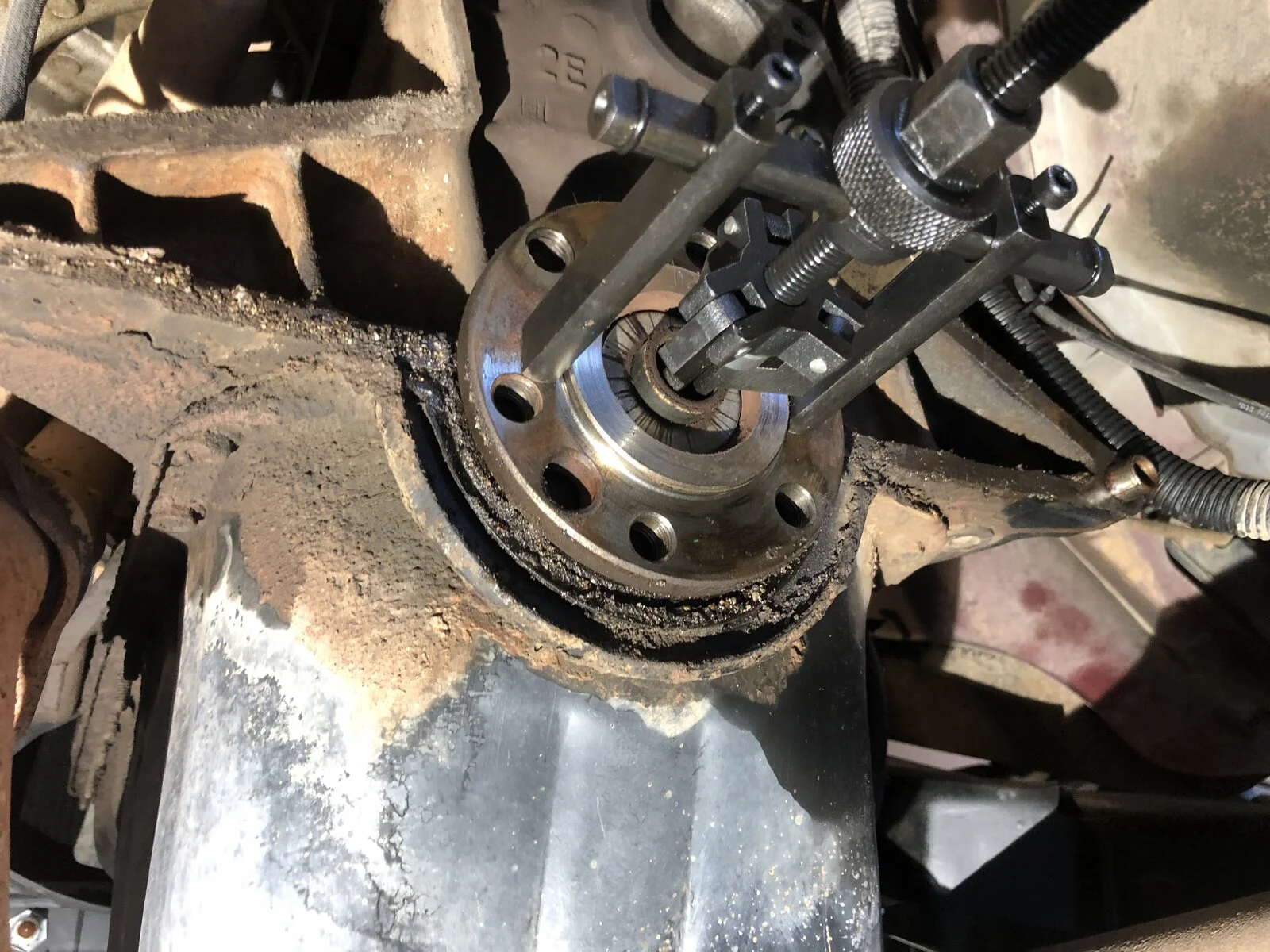

Oh yeah, that looks a lot better than what I struggled with. I used a two jaw...and my life SUCKED for an hour.

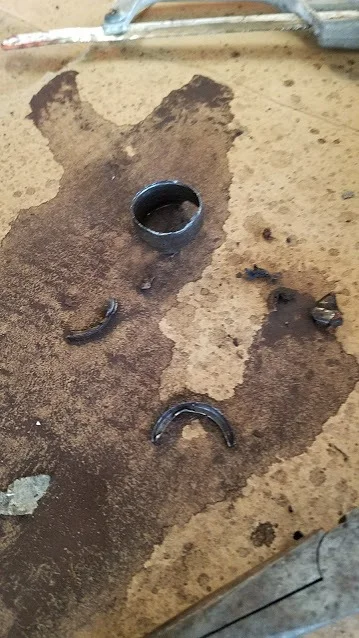

This is how mine came out...Of course, my bearing had seized so the inner cage was FUBAR
Do you just tap the new bearing in with a rubber or plastic hammer? Use any grease there? Or just on the splines after cleaning them up?
Reactions: Cross-Threaded-06TJ
I use a bushing driver. But you could substitute anything that drives it in flush. And I have always put a little extra grease on the pilot bearing/bushings. Not gobs.
