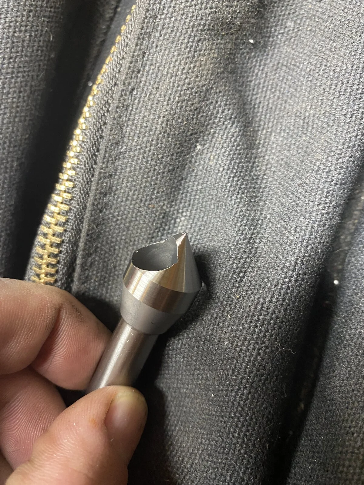

Got the 5/8” 82* countersink bit in the mail. I wasn’t too impressed with the quality. Note the edge.

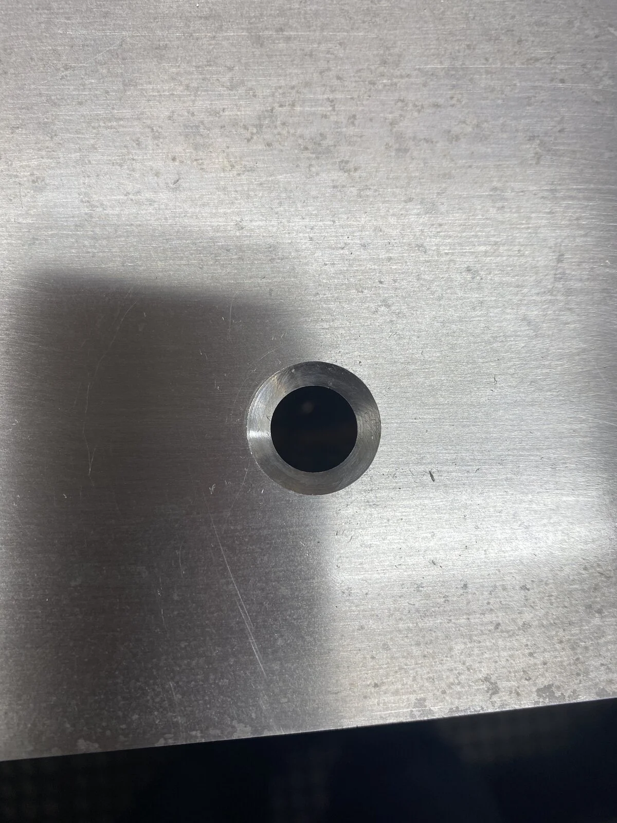

nevertheless, it was easy to get all 4 just right.

This one. It's basically the same as the one you linked to, except it's a 5/8" head diameter rather than 3/8". You'd need that to match the diameter of the head of the Savvy hardware. Blaine said Savvy uses a 3/8" hole. that's incorrect, at least on this tailgate. It is larger than 3/8". Nevertheless, a 3/8" hole and the 5/8" countersink with 82* bevel is sufficient and the hardware sits flush in the countersink.

Thanks. My brain said 5/8, but my old man eyes translated that to 3/8! 🥴
