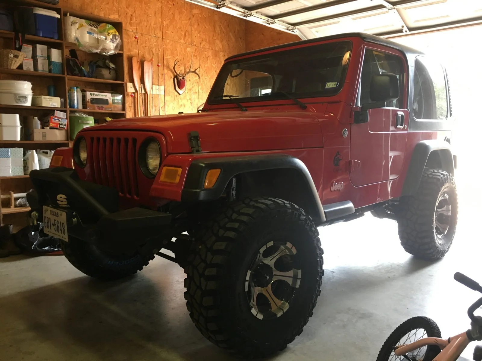

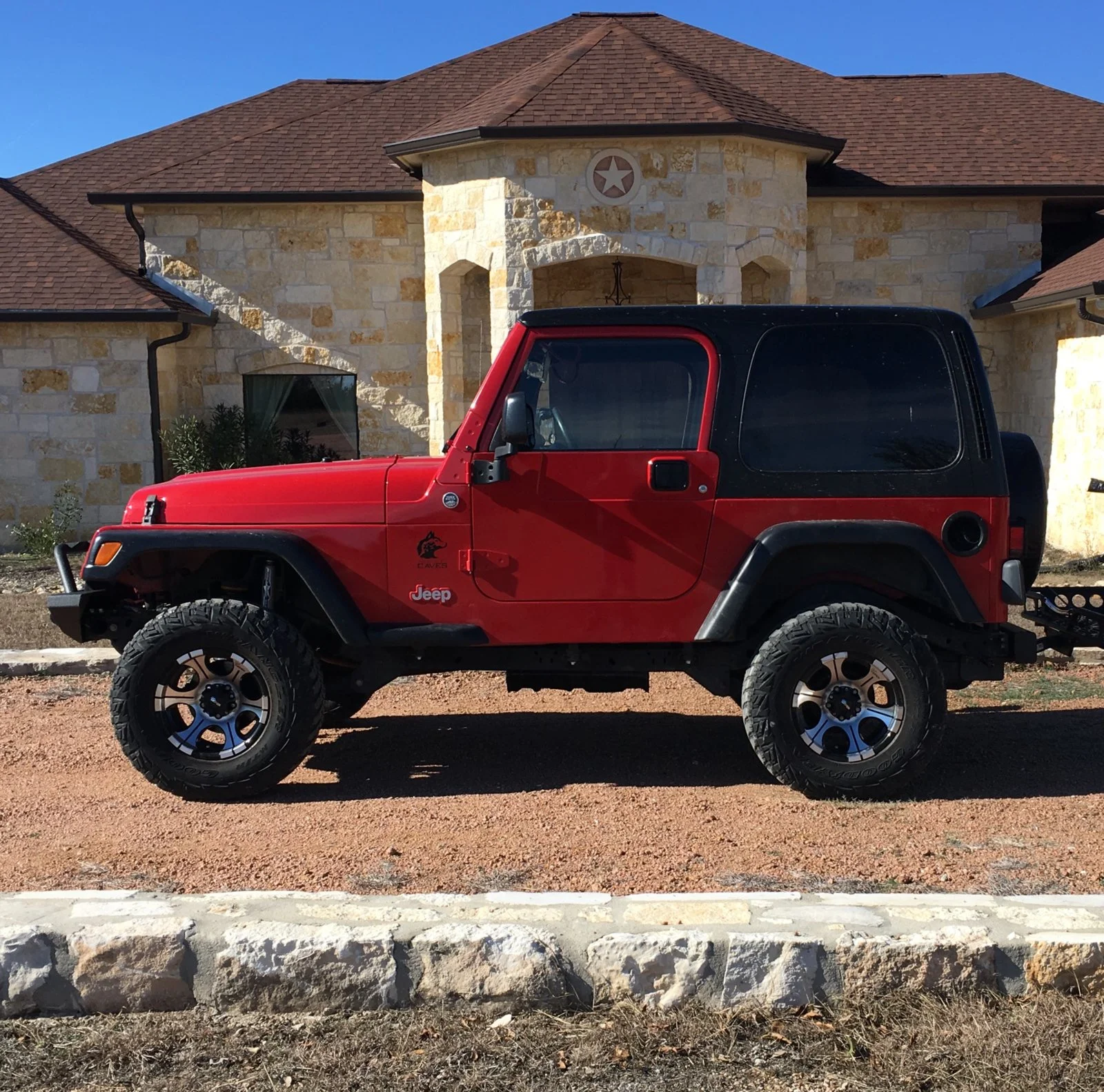

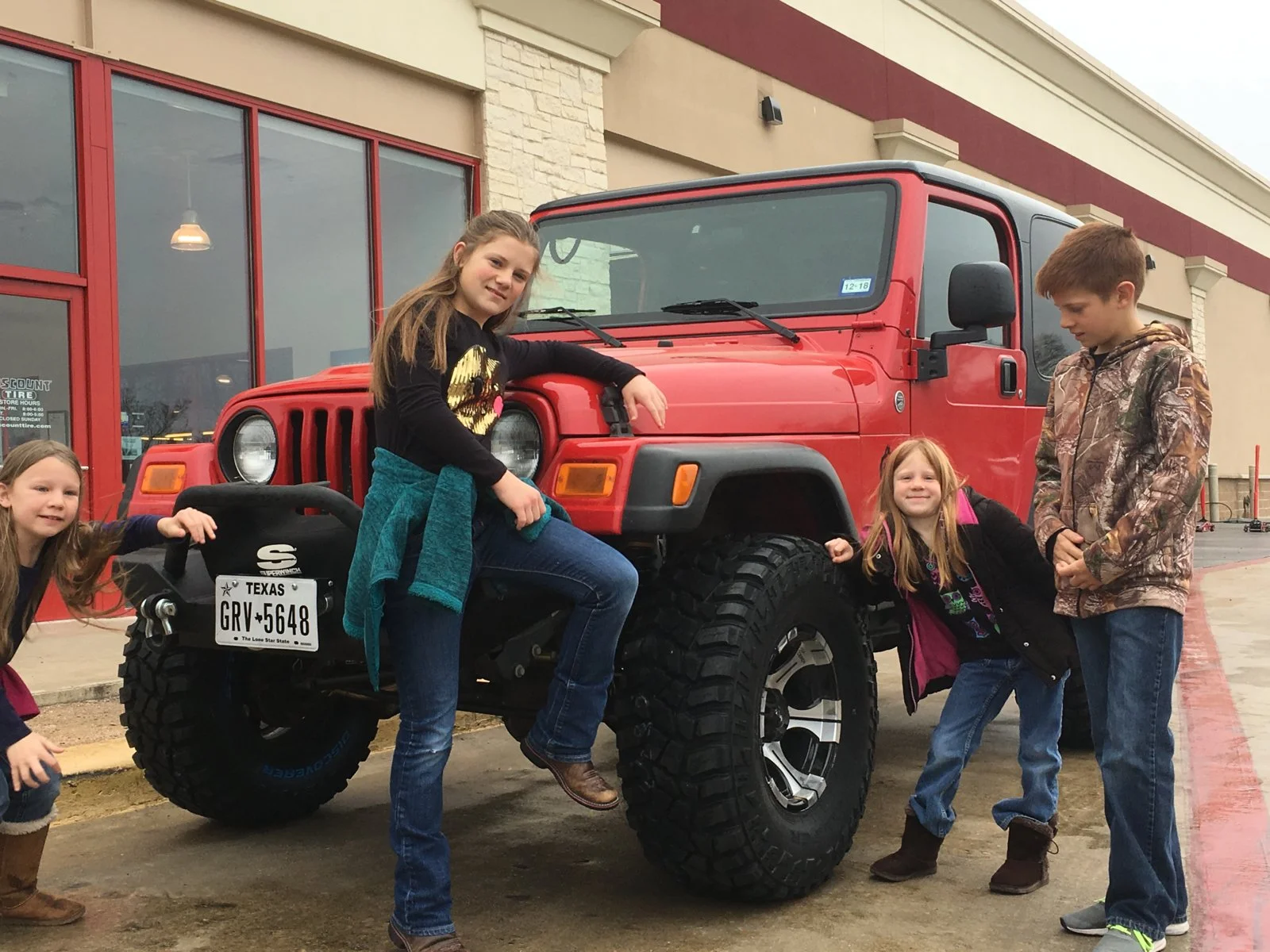

I took the plunge. New shoes from Discount Tire; Cooper STT Pro 33x12.5r15 on 2.5” OME SL and 1.25” Savvy BL. The balance is perfect. Excellent ride. Love or hate the width, I think it looks mean and will perform well for my uses. Super short valve stems to boot. :D I’m very glad I chose this tire size and width.
Gearing seems fine with the 6-Speed, especially around town. Haven’t been on highway without a trailer yet, as I brought my 31’s home. :)
Took some before and after measurements that I’ll add a bit later. For now let’s get to the pics!

After on 33’s
One more After for good measure.
Gained 1- 1 1/2” at all the important spots

I took the plunge. New shoes from Discount Tire; Cooper STT Pro 33x12.5r15 on 2.5” OME SL and 1.25” Savvy BL. The balance is perfect. Excellent ride. Love or hate the width, I think it looks mean and will perform well. :D I’m very glad I chose this tire size and width.
Before on 31’s
After in 33’s
I dig it! Nice choice JMT!
Reactions: JMT

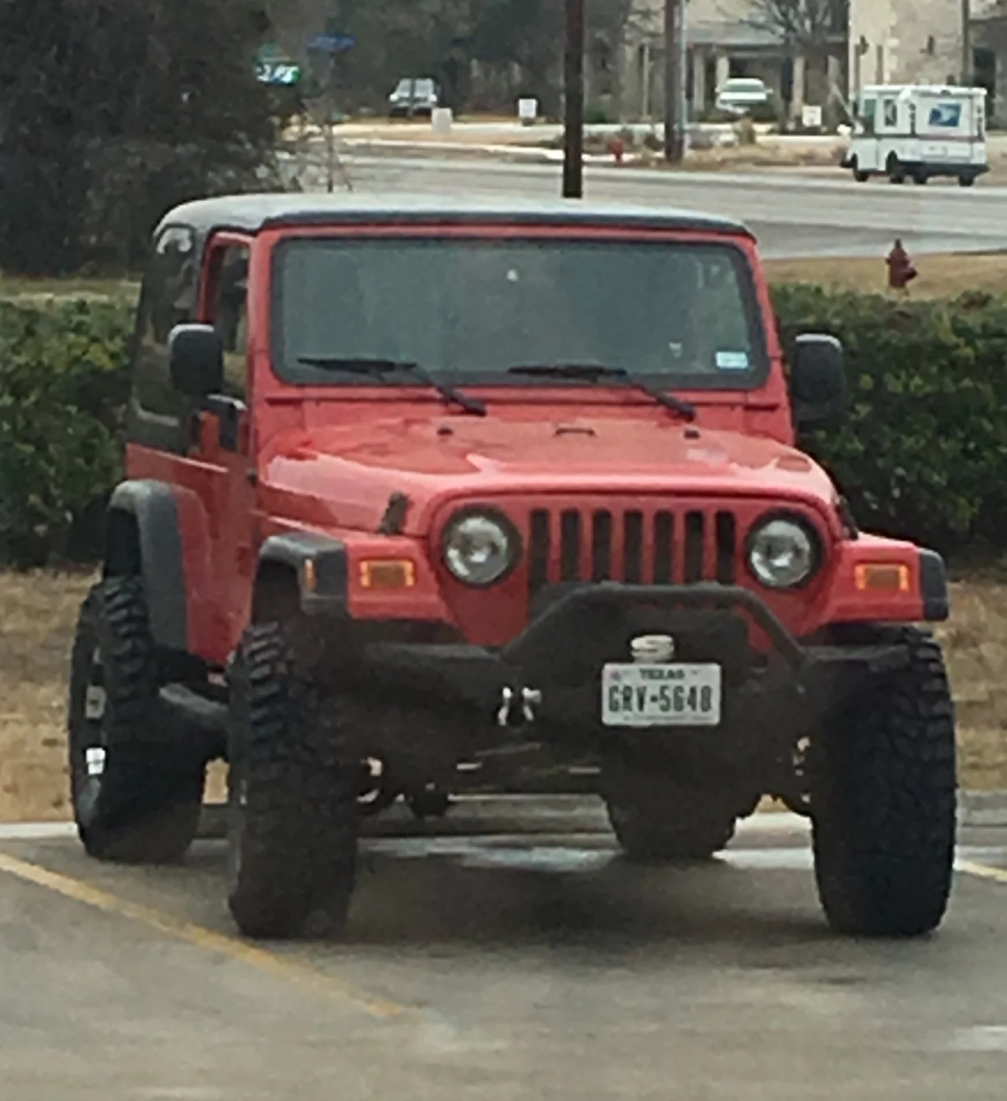

I think you done good. Looking pretty sweet to me!!! How about a distant frontal pic?

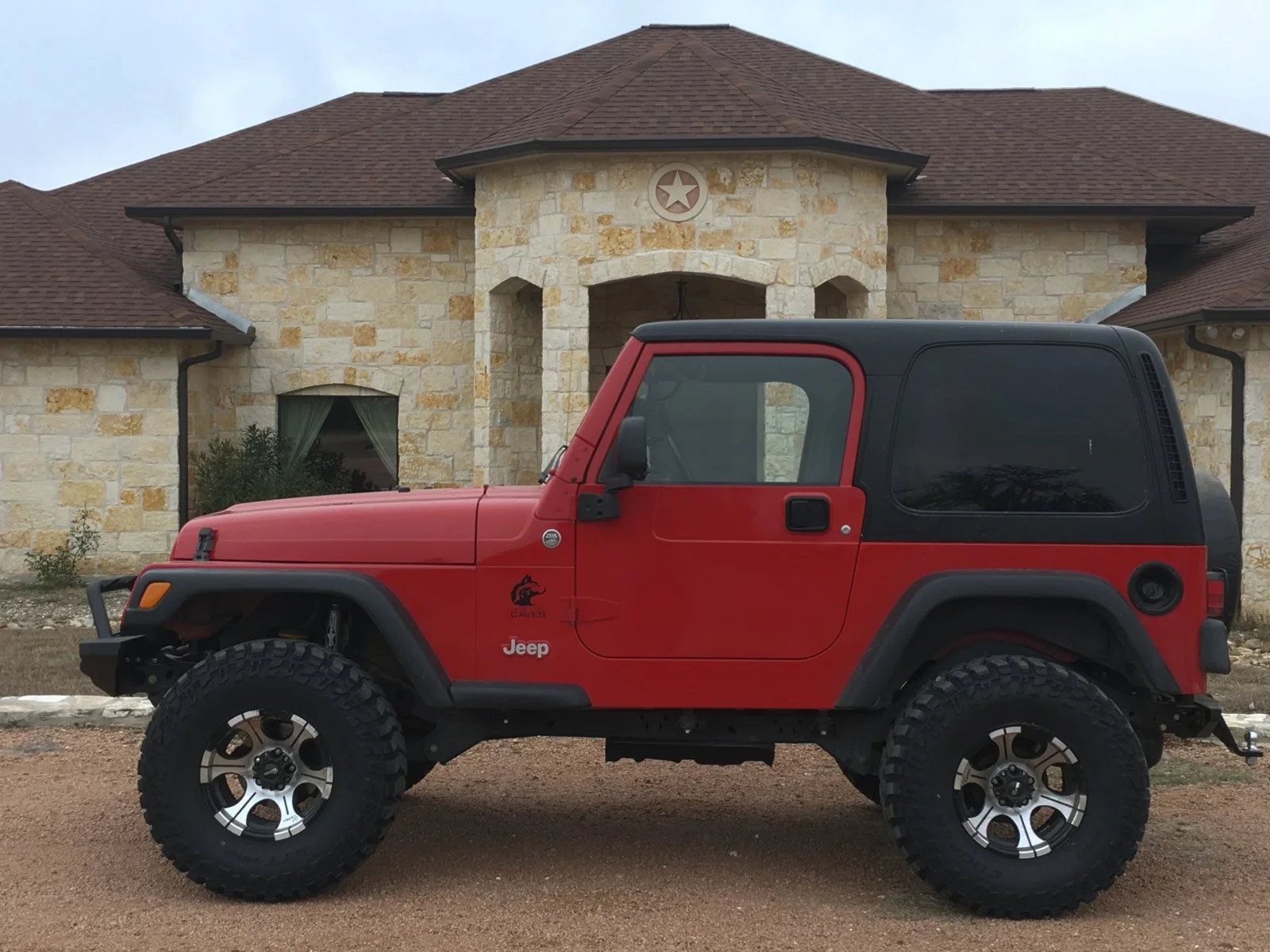

I'm kinda wanting the wrangler MT/Rs. I just got these duratracs last March though.
Thanks, it was time. My Wrangler MT/R’s were manufactured in 2013, so almost 5 yrs old. Tread was 5/32 or less all around.

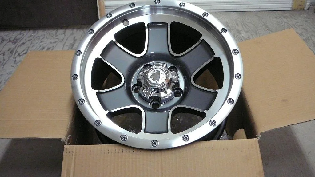

@bobthetj03, I keep meaning to ask you, what wheels do you have? I really like them. The only other wheels I've seen that I might like more than the factory Moab wheels!

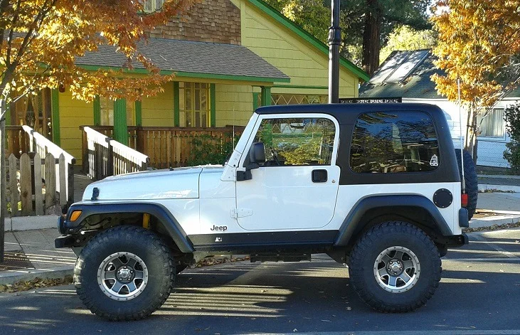

Hey @JMT, if you get some Rubi flares, we can do some side by side front/back profile shots for folks who want to know what a 12.50 wide tire looks like vs. a 10.50 wide tire. @Chris might possibly have his old Rubi flares for sale soon. Just a thought.
