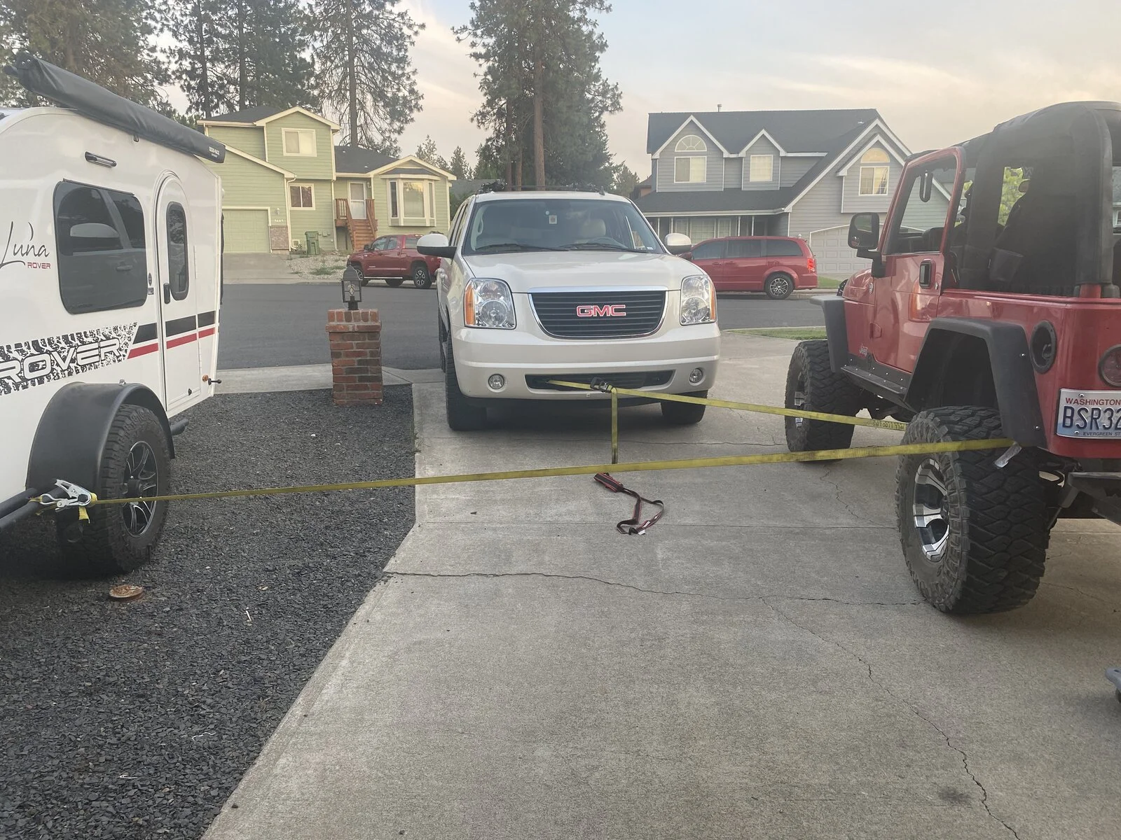

I had my wife doing that for awhile. Never could get it! Still needed about 5mm. She left me and I figured it out.A partner rocking the Jeep back and forth does it for me
Its MUCH easier to pull the bolt on one of the upper control arms when you start centering the axle. At least, that worked for me.I had my wife doing that for awhile. Never could get it! Still needed about 5mm. She left me and I figured it out.At least it’s dead on now. It’s amazing how hard that can be.
For me, it’s much easier to run the ratchet strap to the opposite frame rail underneath the Jeep.My rear TB was not the proper length after the lift. I had adjusted it, but checked it later and it was incorrect. I literally hate doing this part. It is such a PITA. I wish I knew an easier way, and I’m totally open to suggestions.
I did that first. Then had the wife rock the Jeep while I ratcheted it as tight as possible. Still needed a bit more.For me, it’s much easier to run the ratchet strap to the opposite frame rail underneath the Jeep.
I thought about that. I’m doing that next time. Good idea!Its MUCH easier to pull the bolt on one of the upper control arms when you start centering the axle. At least, that worked for me.
