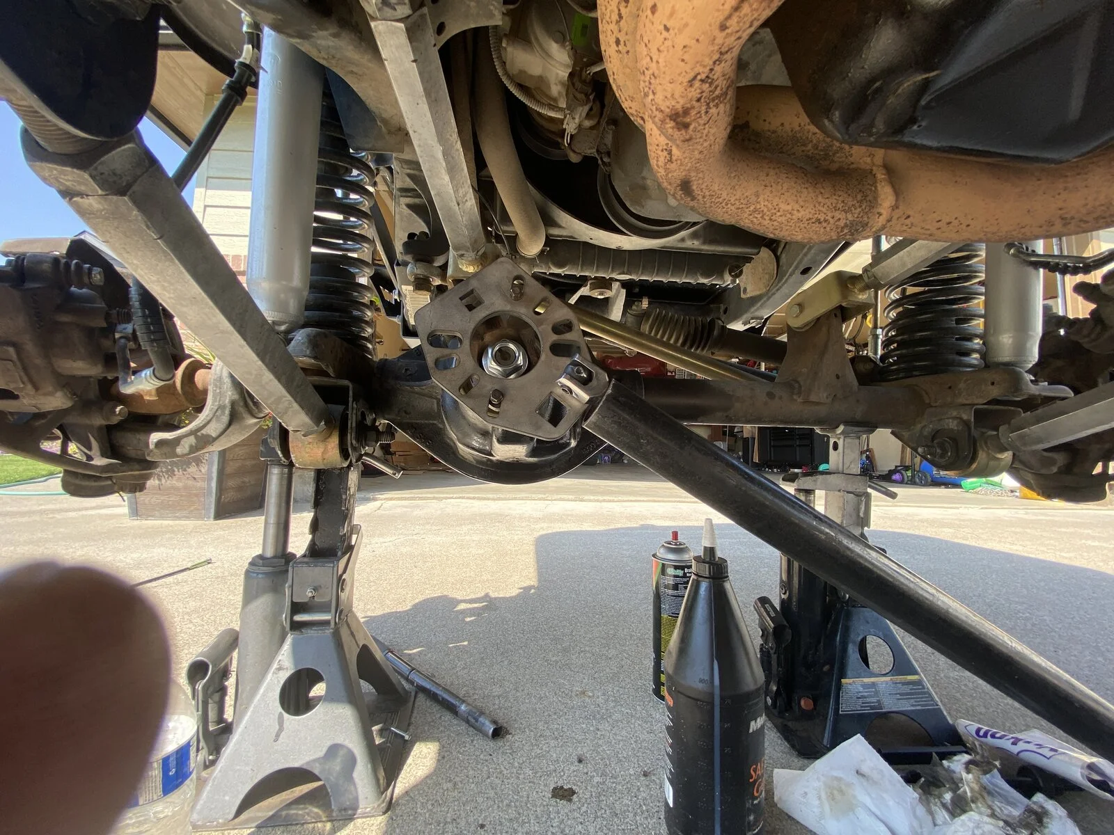

Finished up the pinion seal install. When I removed the pinion nut I discovered that the seal did not have a flange. This meant I needed a puller of some sort. My small one I used for the pinion bearing was too small. I was going to go rent some tool, but all closed due to Labor Day. My neighbor (an XJ guy) said I could drill some sheet rock screws into the tin portion and work it out. It worked. When I started torquing down the pinion nut I started at 140ft/lb and worked in 5ft/lb increments to get the pre-load 5in/lb more than prior. There was no play in the pinion shaft and when I got to 205ft/lb on the pinion nut I called it good. No leaks or issues after a 20 minute drive and the in/lb are the same as they were before.
