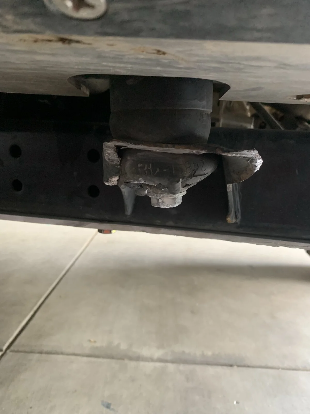

I have a set of Genright body mount brackets for the TJ. The only reason they haven't been installed is because of the Savvy MUA. With all the stuff on my to-do list, removing the cross-member and fabricating a mount isn't at the top of my list. :(

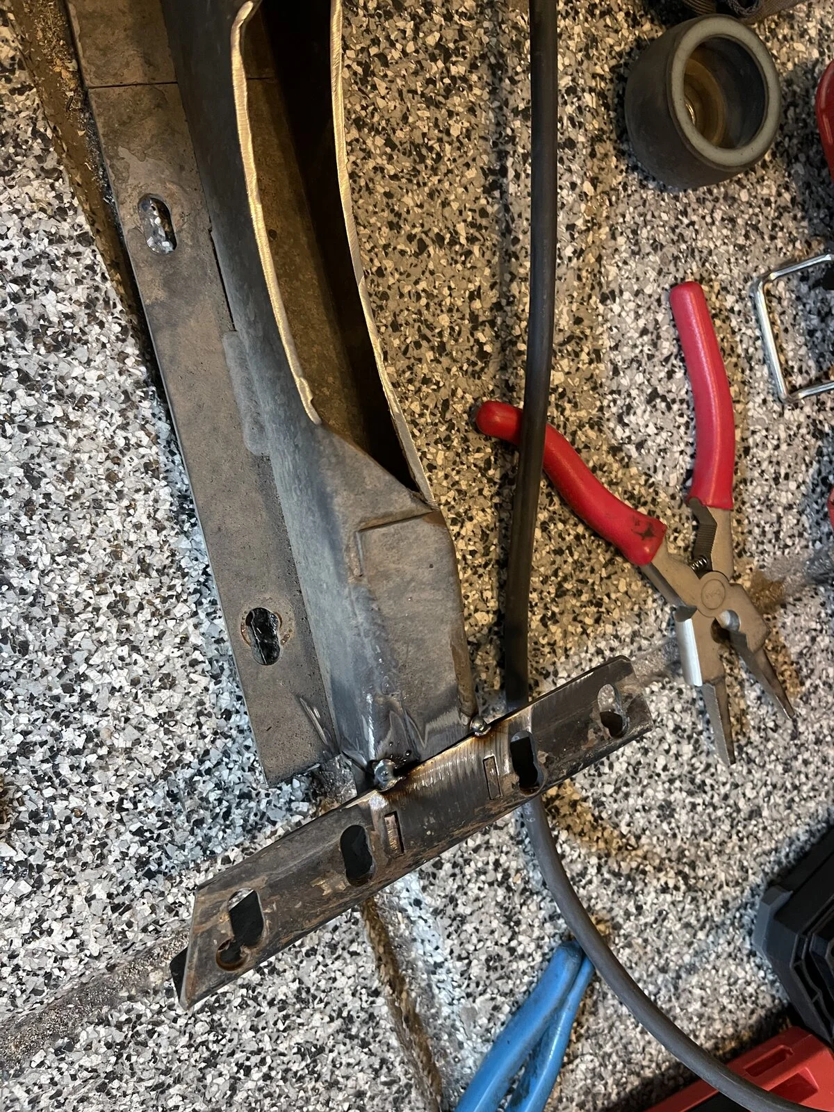

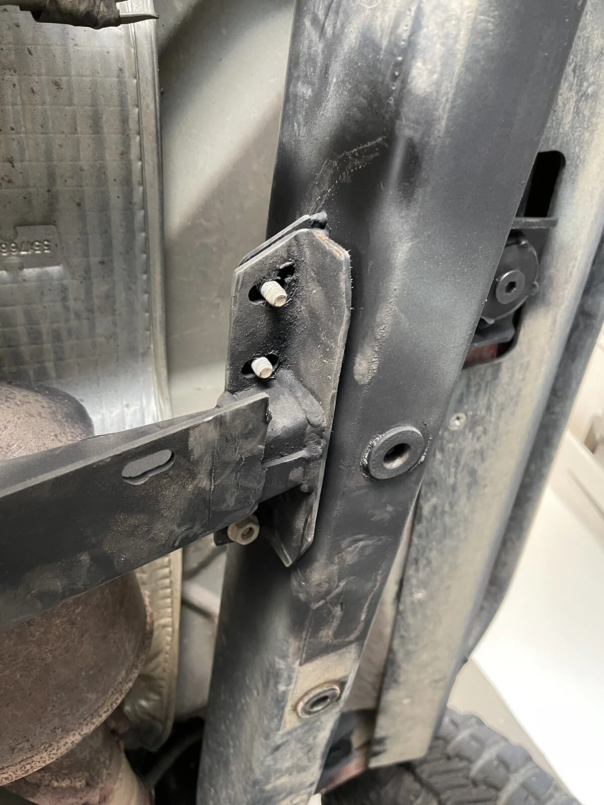

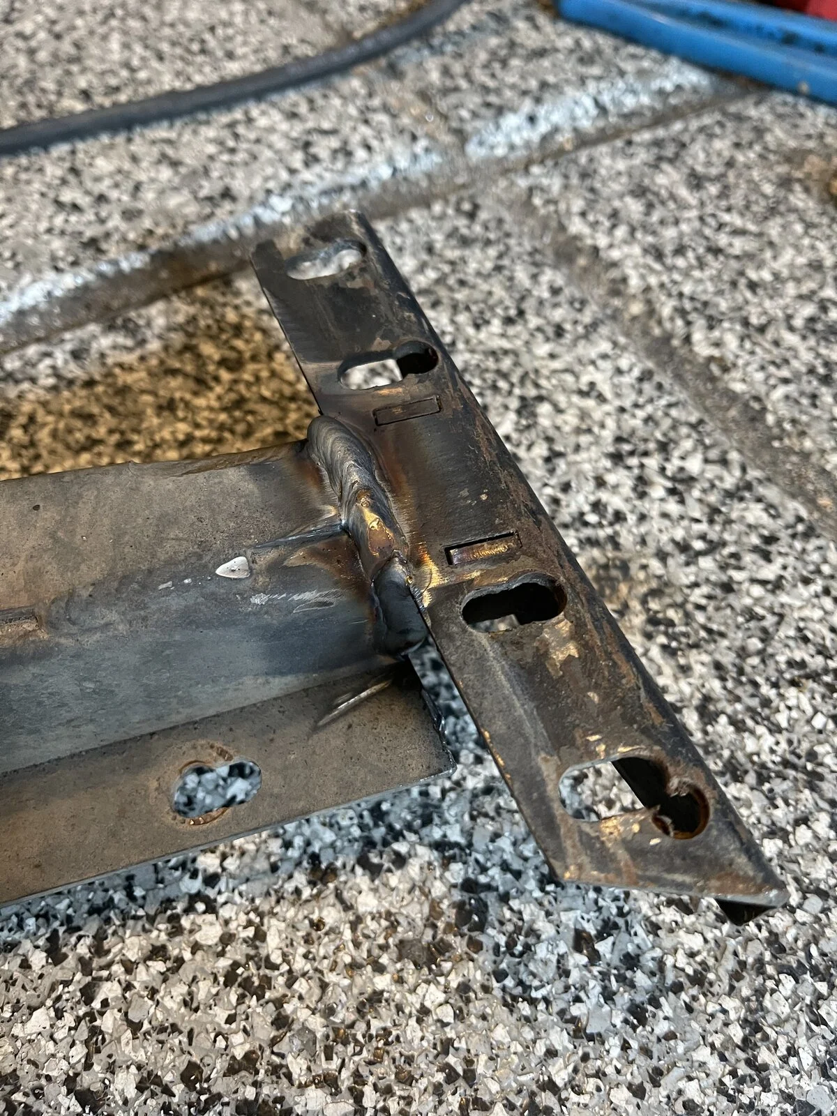

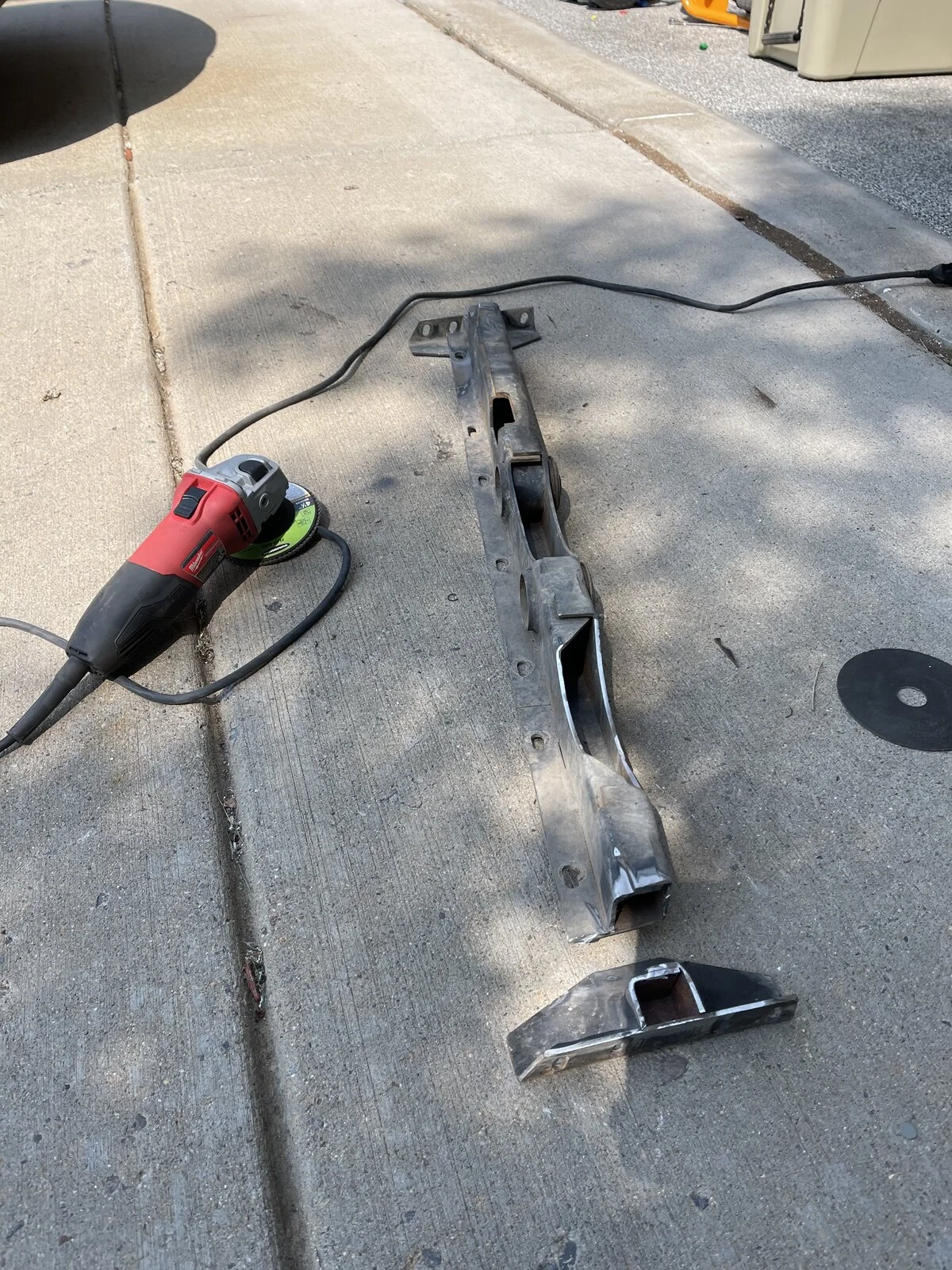

It’s not as bad as it looks. It’s really just cutting and flipping the crossmember’s end pieces side for side (and flipped). Then get the skid into position and weld tabs to the frame that line up with the newly flipped ends. I’ll eventually redo mine because I think it’s worth gusseting them too.
