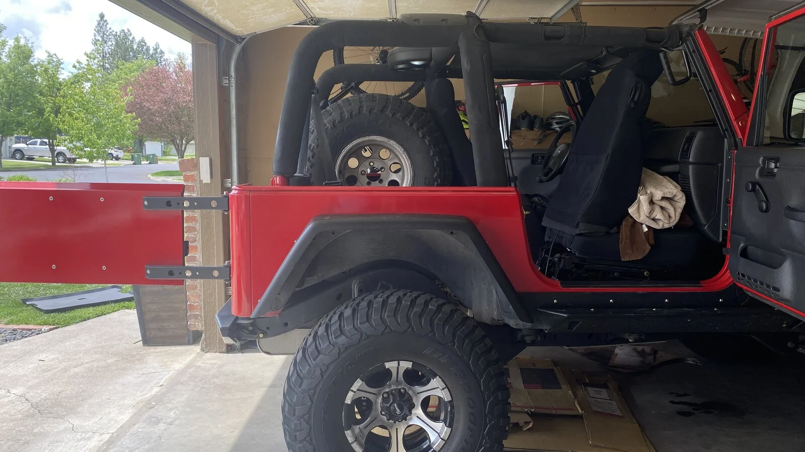

Getting ready for wheelin trips that are farther away. I’ve been planning to put the spare in the tub, but in a way that saves some space and that allows me to keep my powered subwoofer while allowing me to swap the rear seat in and out without changing the location of the powered sub.
Obviously the sub had to come off the bottom of the rear seat. This has been a good solution for me for over 5 years, but you can’t remove the rear seat and keep the sub in the Jeep, so it was time to sort it out.
If you really want to keep the back seat, you can stand the tire up at the back against the tub next to the tailgate. Remove the ‘back’ of the seat and only use the butt cushion part. It’s a tight fit but it’ll work, probably wouldn’t want to sit back there a lot time but short trips.

Maybe mount a bar between the roll bars with a T and a wheel spacer on the end right at the hub. Bolt up with a few lug nuts. Would that work?
I thinking more like the xj mount and run something through one of the lug holes back to the fender. That and a strap over the tire with some cleats https://www.amazon.com/dp/B06XPVVS5C/?tag=wranglerorg-20

The lowest lug hole is ~14" high. The highest part of the inner fender wheel well is ~12.5". If I make a bracket and bolt it to the inner fender I could raise it 1.5" and then add a swinging threaded bar like the XJ has and run it through the lug hole and use a hand tightened bolt. Maybe?
That was my thought.
