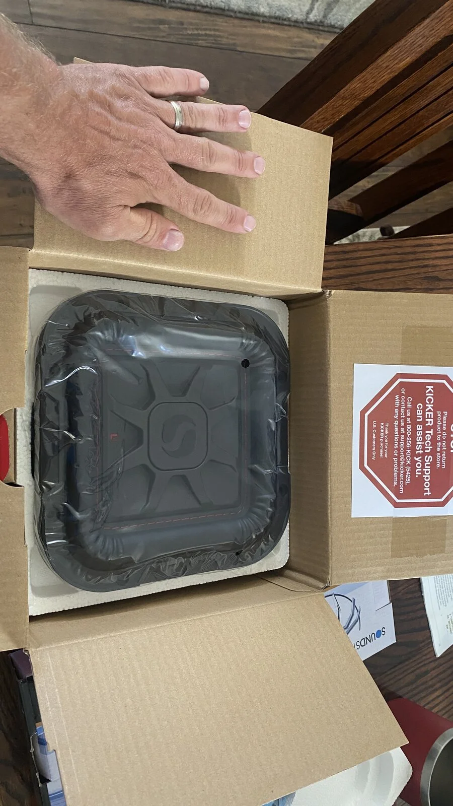

Next round of audio upgrades arrived. Don’t know when I’ll be able to get to the install. I’ll build a box for the shallow mount Kicker that will fit under the rear seat. The Soundstream Nano Picasso will go under the steering column.

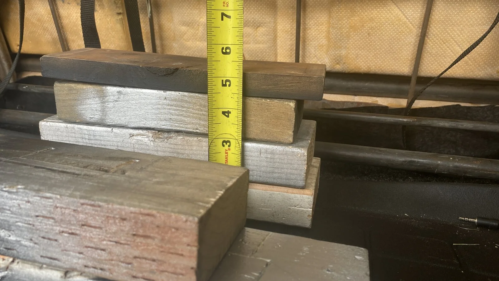

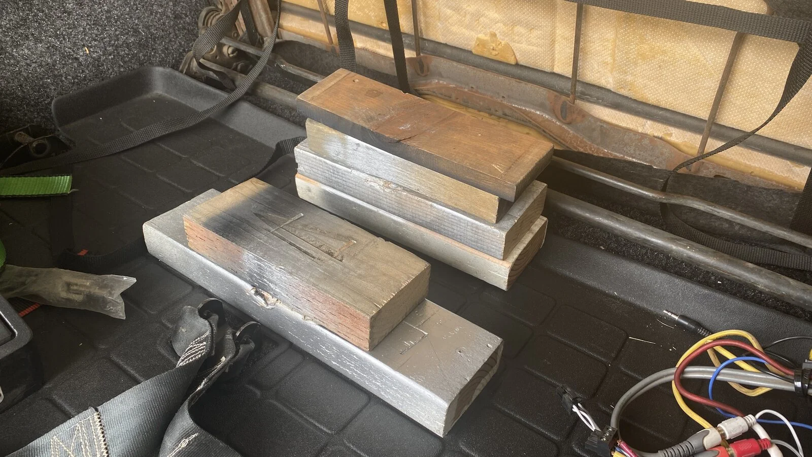

If anyone is wondering, you can build a speaker box that fits under the rear seat with the following dimensions
L = 28”
W = 10”
H = 3” at rear and 5.25” at front
Here’s a pic of the only difficult measurement to figure out. The rear seat will latch over these blocks of wood. It’s tight!
My box will only be 20x10x3 rising to 5. The sub has a mounting depth of 2 3/4, so I think I’ll be good. That’s 0.35 cu ft volume and the specs on the sub are minimum 0.2 cu ft and maximum 0.75 cu ft. These TJ’s are so tiny!
