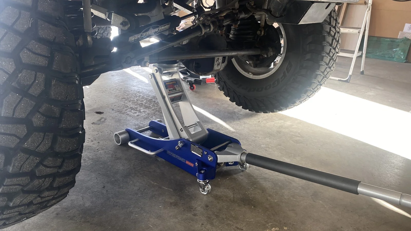

As for jacks i’ve got the HF daytona low profile, no issues

3. Bought the 2.5 ton HF Daytona Floor Jack. I think I like it. 🤗

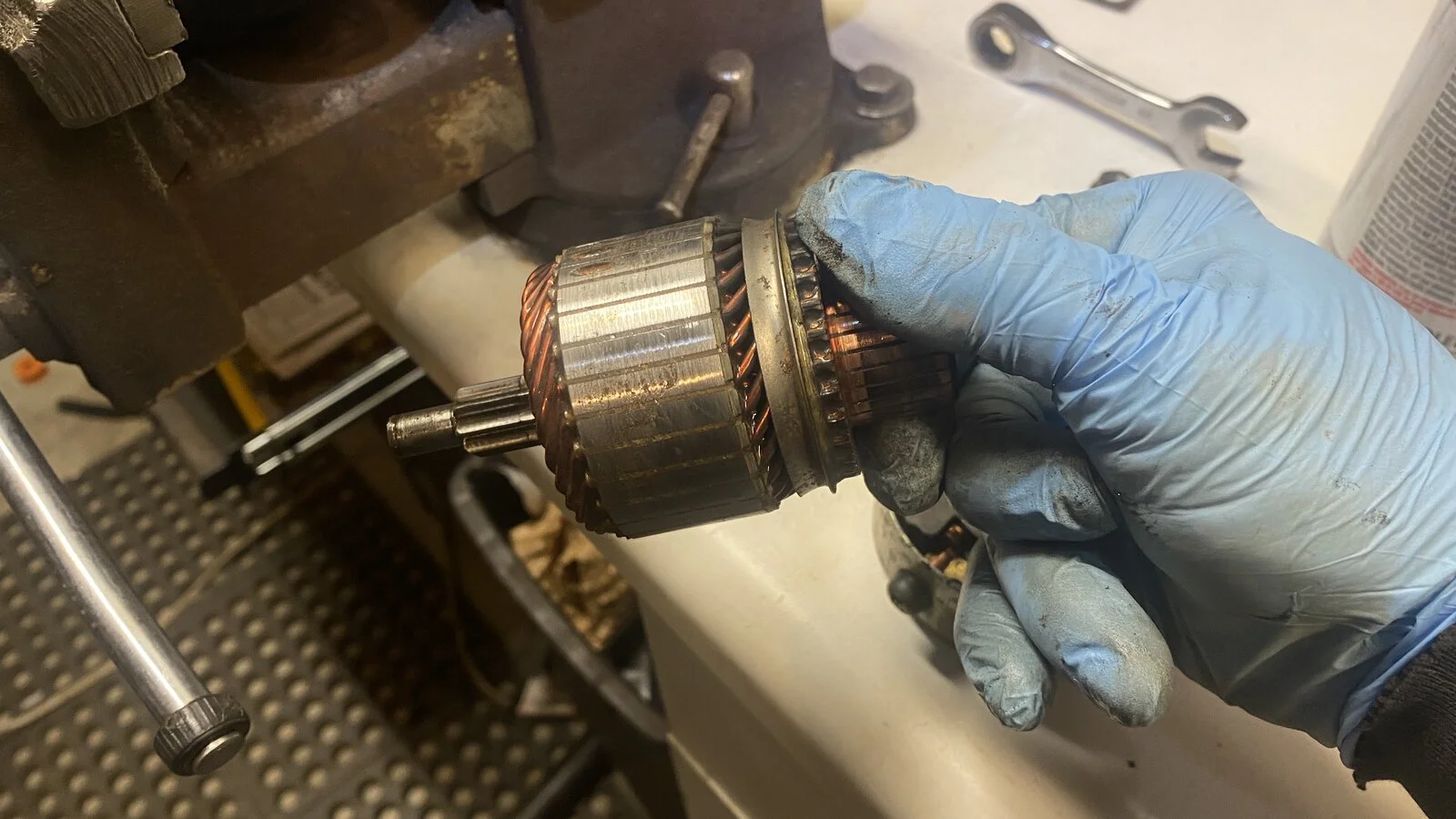

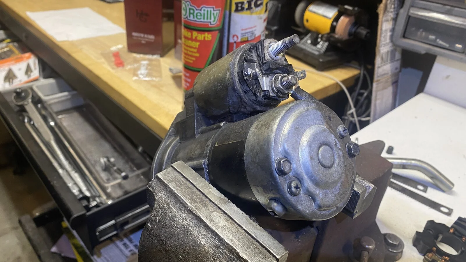

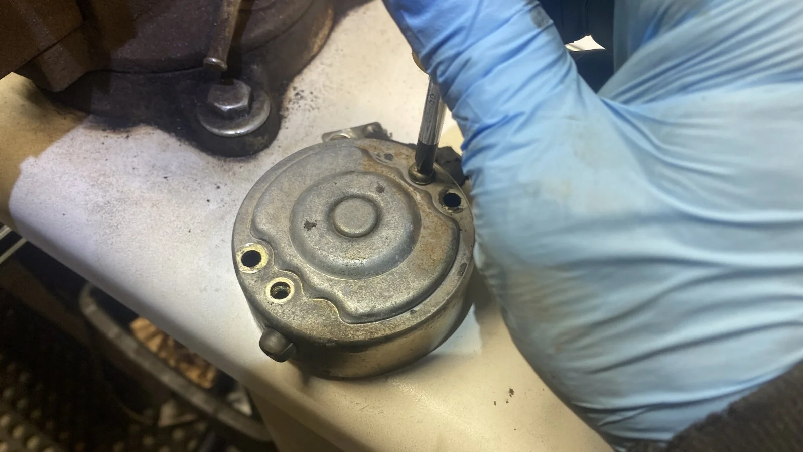

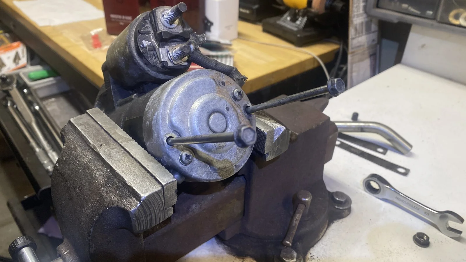

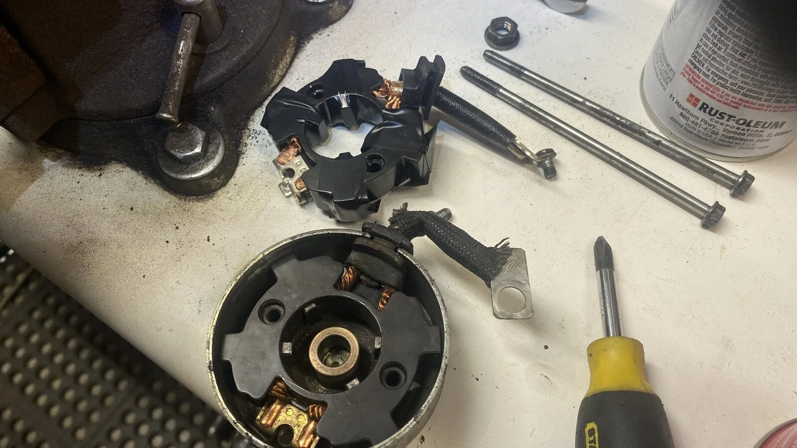

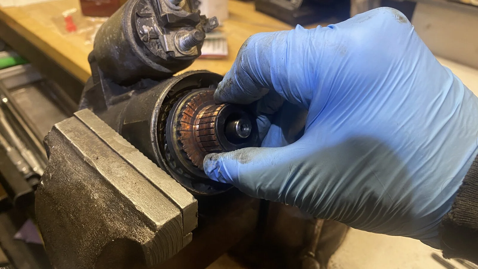

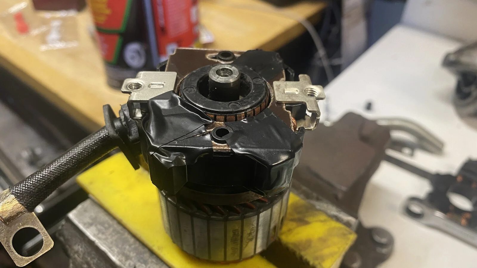

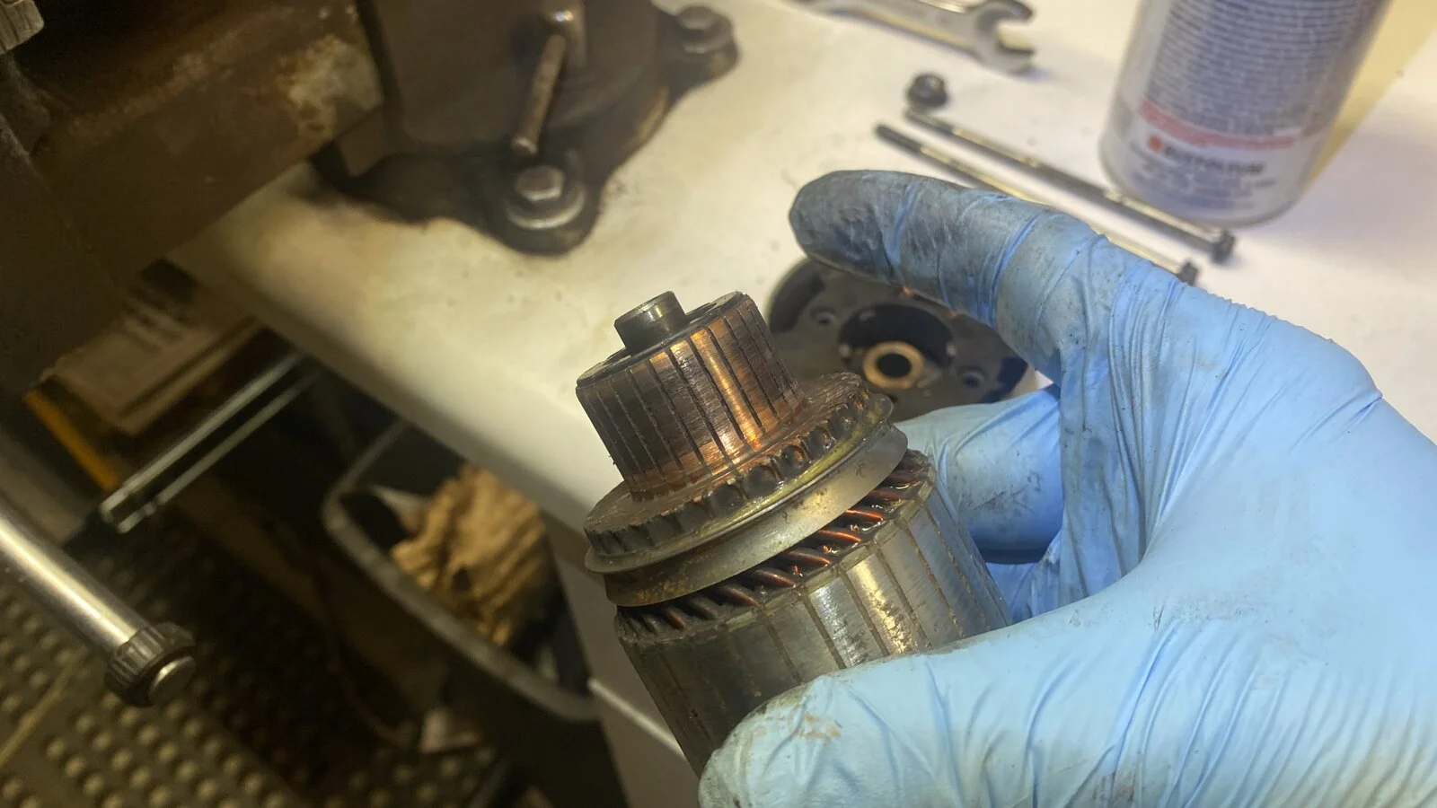

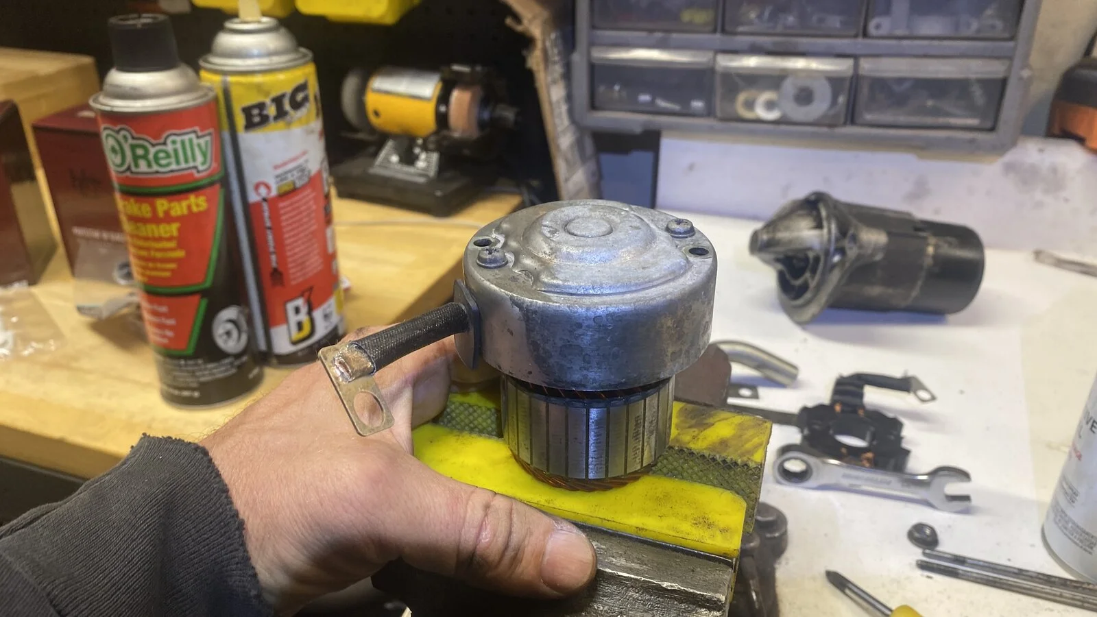

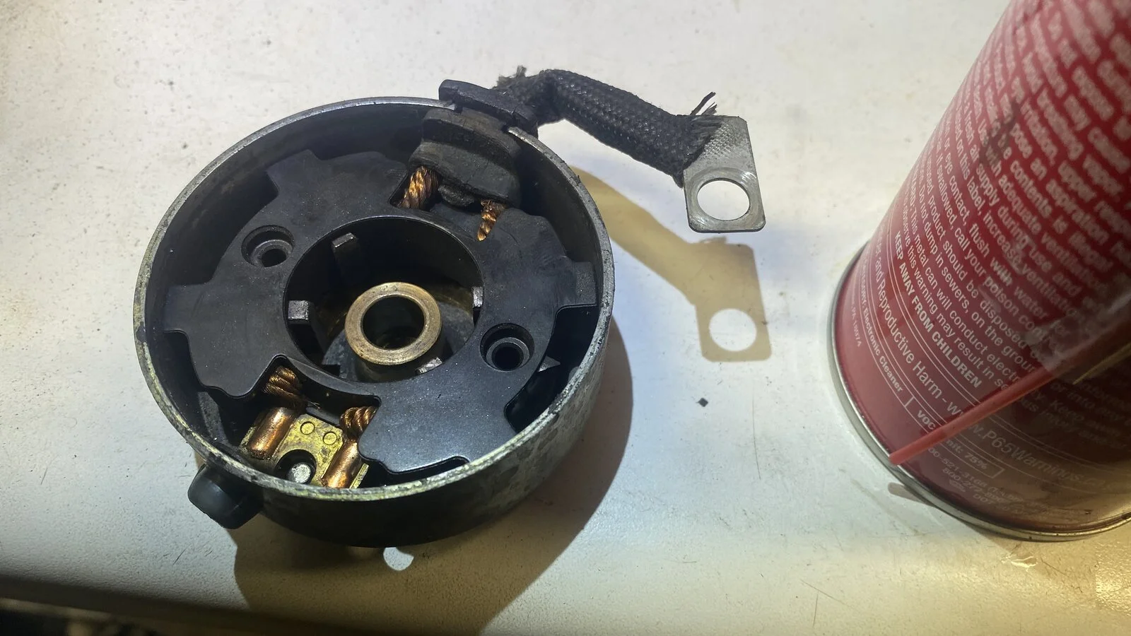

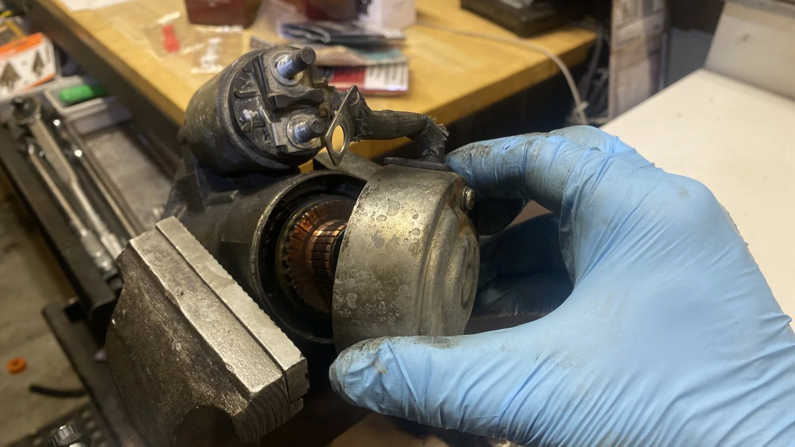

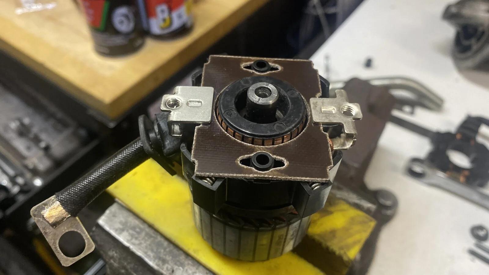

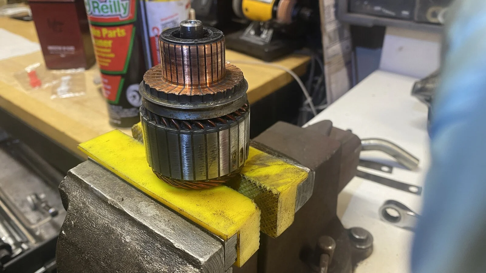

Very nice. Now I feel bad for tossing my stock starter.
I know. I was so glad someone mentioned it to me. It was 1/10th the price of new. This was all that was left of the brushes. 🤣 103,000 miles on this rig. For those doing this or putting in a new starter, check the wiring for frays and possible shorts. My wire was all messed up. I didn’t realize it before I did this. The PO had tons of electrical tape on it. I removed it all and put some extra vacuum tubing I had for the Rubicon locker on it. Worked great. It’s totally shielded from the engine and tranny.

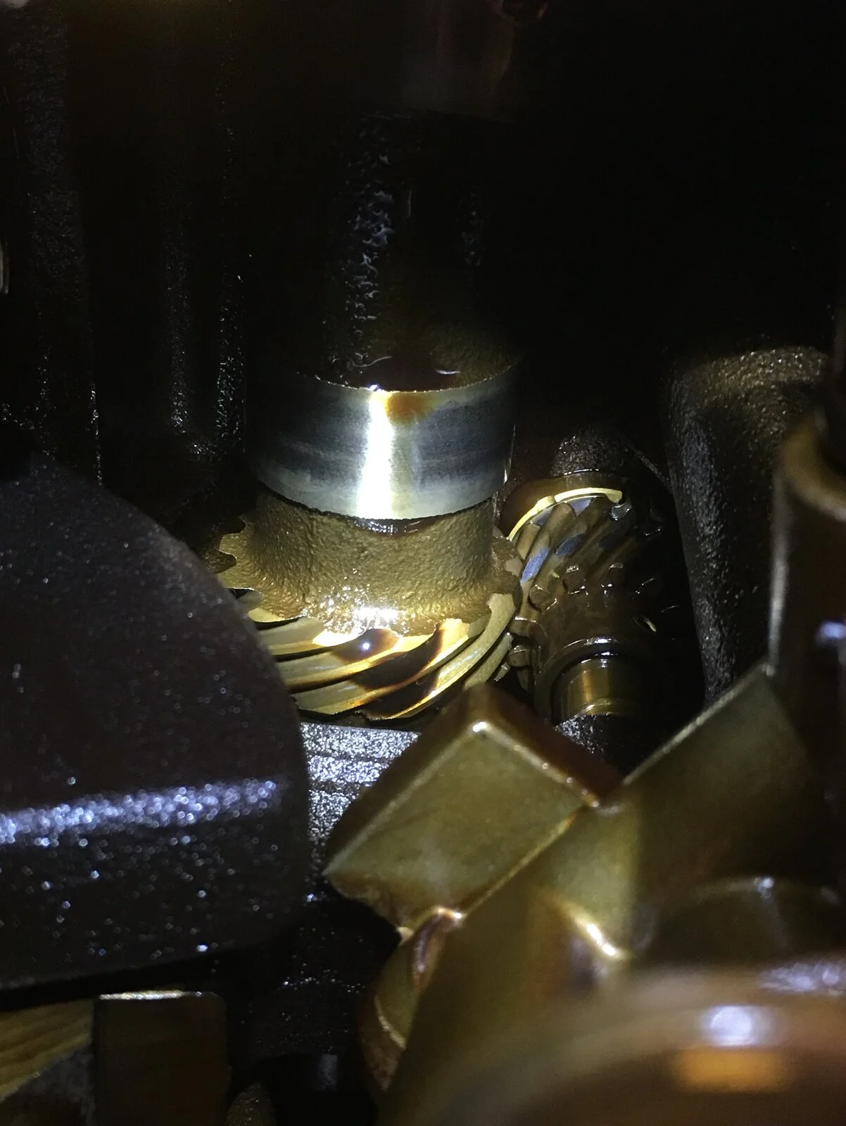

You can see your OPDA/cam gear pretty well too with the pan off, so it would be a good chance to make sure you don't have any abnormal wear.
I’ve never looked at things like the OPDA from underneath. I did replace it in Feb of 2017 or 2018 as preventative maintenance because I have an ‘05 just within the known production dates for having bad OPDA’s. When I did I kept the stock sensor. Still it would be a good time to look. I also have the original OPDA, which looked good to me.
Reactions: MountaineerTom
It's visible enough that I felt good about how mine looked.
