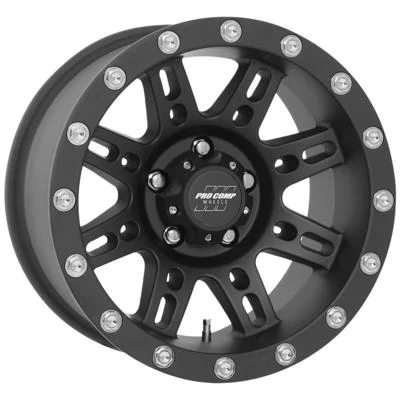

Where did the 1/4" wheel spacers come from? I was actually just thinking about looking for some this morning as my Baja extremes only have 3.6" of backspace

What are your reasons for wanting to go to less backspace than 3.6”?

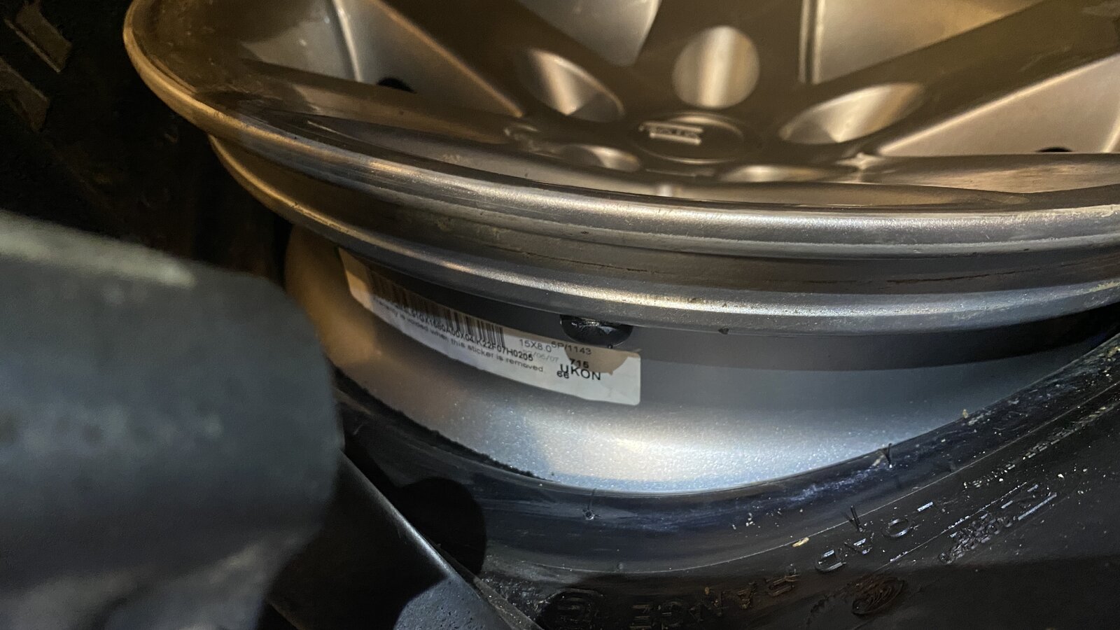

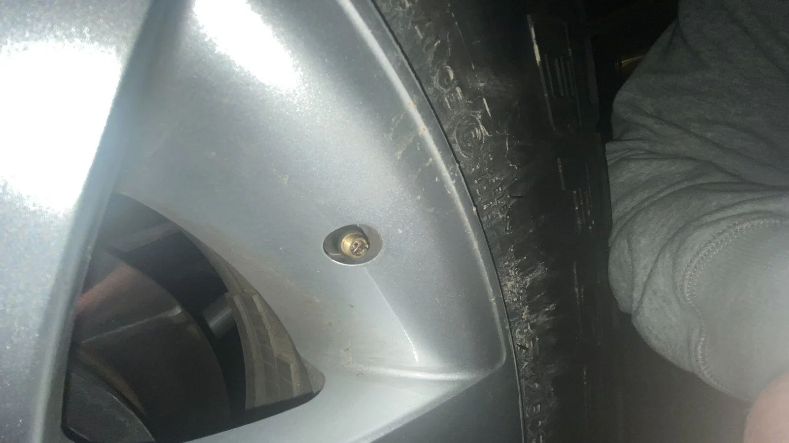

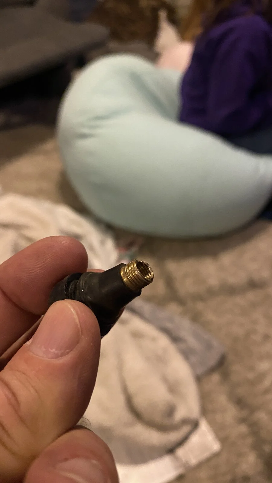

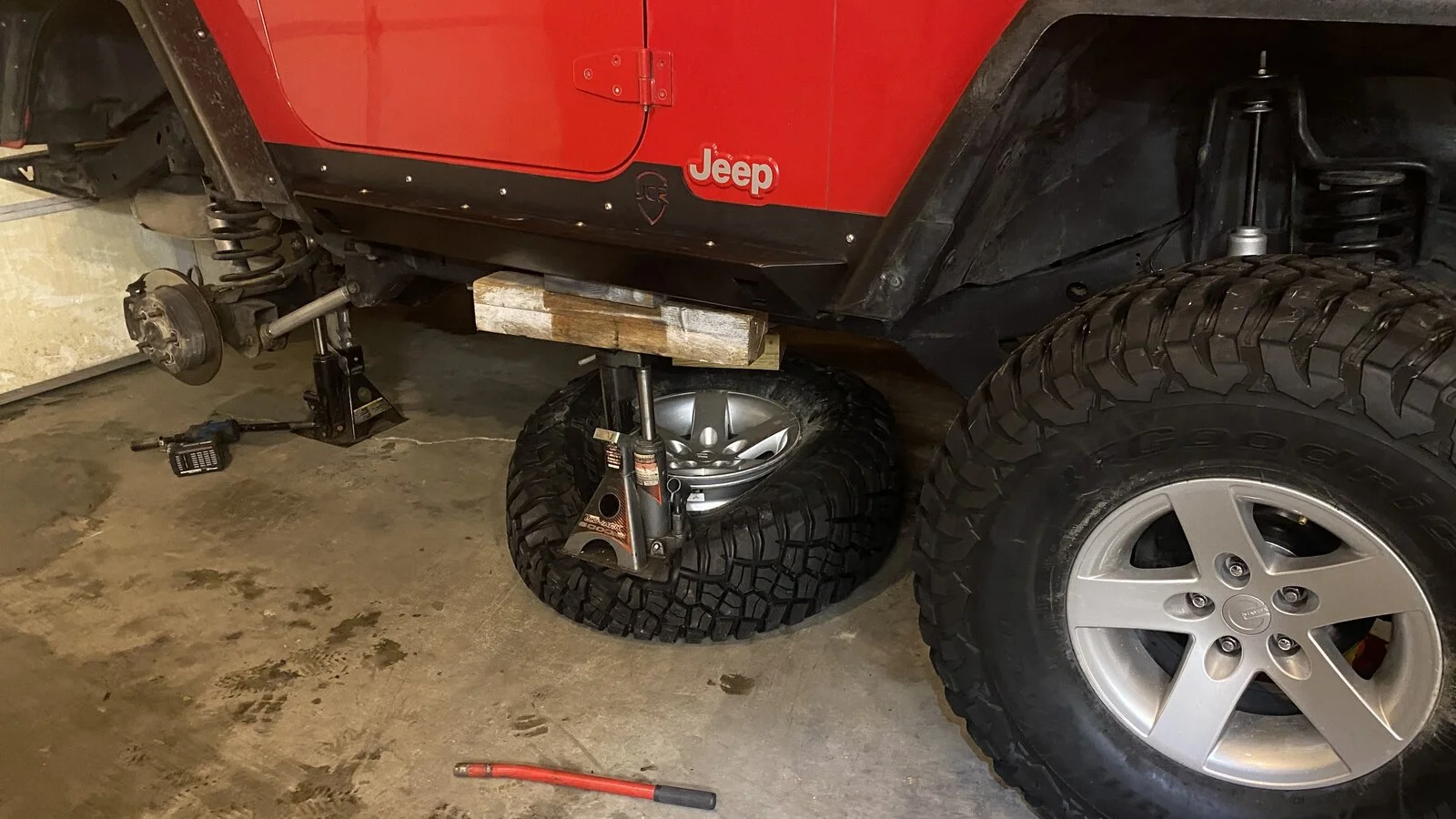

I did something stupid on Sunday (surprise 🤣). It snowed and I went for a drive, not intending to go to the ORV. It was so beautiful I meandered there anyway. I usually put my Coyote deflators on at the house so when I arrive I’m already aired down (5-7min). I jump out, remove them, flip the SL and go. But this time I put them on at the ORV. With good intentions of removing them after a gentle drive through the snow I forgot and got carried away doing the hard stuff in the hardest way possible. I heard a bang, but what’s new when you hit stuff sliding sideways. I kept going then got real tied up off camber in a ditch. I got out to look. That’s when I noticed the Coyote had ripped off taking half the valve stem with it. 🥴
It was gradually leaking so I went home. It was completely deflated later that day.

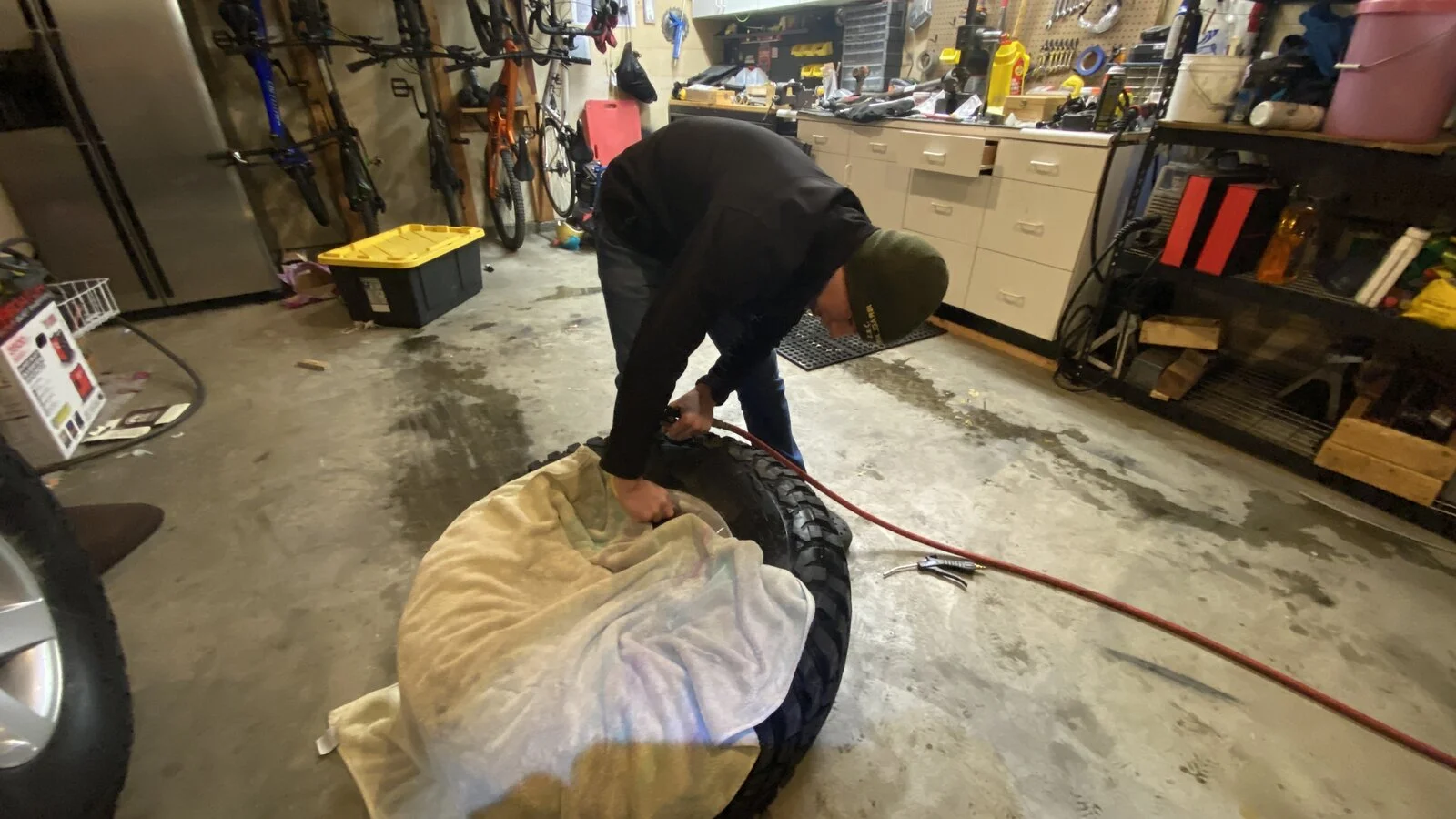

The good news is it gave me the opportunity to attempt to break the bead and replace the valve stem. I already have some for trail fixes, but had never done it. We tried a couple things to break the bead and finally got it by using a jack under the slider sitting against the sidewall. It’s very satisfying when it breaks. I had good help with Kaleb who had the best idea for getting it done.
I was able to use some pliers to pull the old valve stem out and I put some white lithium grease on the new one and used a valve stem tool to pull it through.
Laid the sidewall of the tire up on a 4x4 and I stood on the wheel while my son used the compressor to air it back up and catch the bead. POP. Easy. Ready to go! Big snowstorm forecast tonight (haha @NashvilleTJ wish you were here). Can’t wait for a snow run tomorrow! And Thursday.

Great idea to use the flat as a learning opportunity. Better to learn now then to experiment on the trail.
Colby valves work good. I've seen a couple used and it is quick and easy. The 2 times I saw them used the valvestems were very vulnerable. https://colbyvalve.com/
Good valvestem placement for Mall Crawling
Good valvestem placement for Rock Crawling
