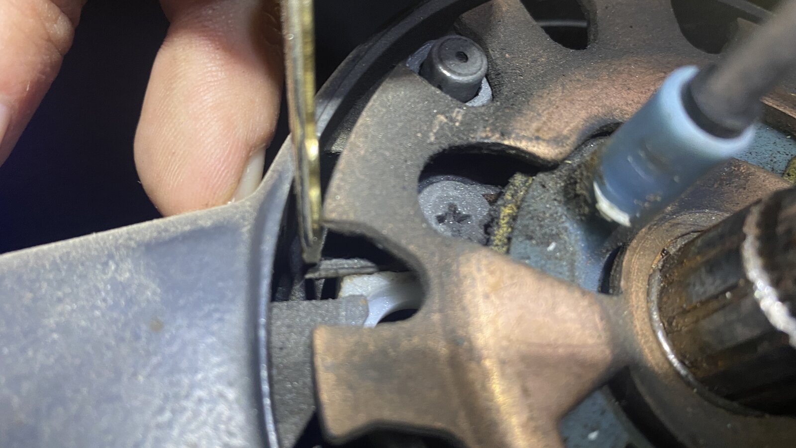

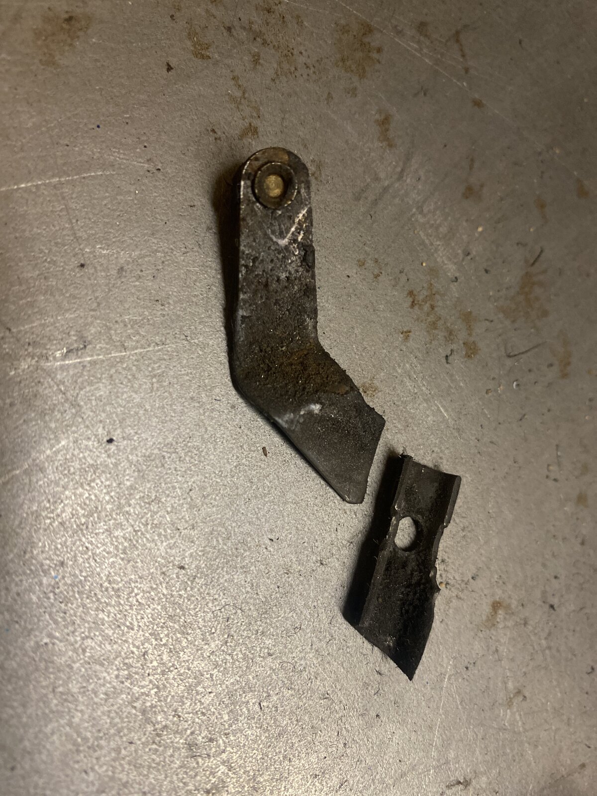

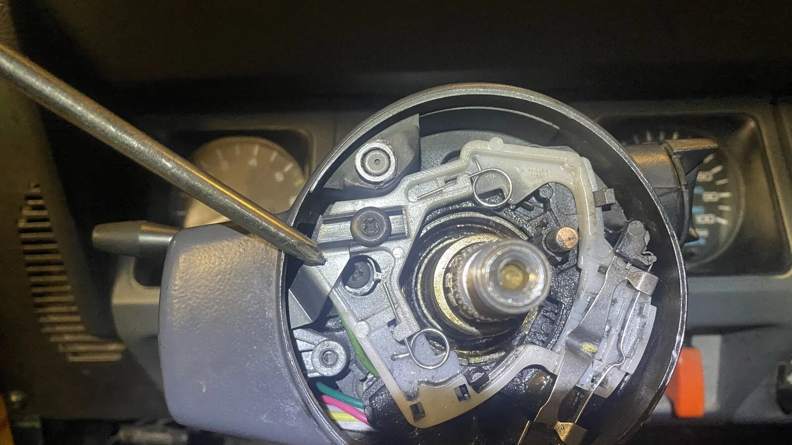

If the switch arm is metal and all the pieces are there, can it be brazed back together?
🙁 At the time I could only see the part that was broken behind other steering components, so I started researching, and when I finally found it I got it on order ASAP so I can get this Jeep back to this kid. It’s in really rough shap. I can’t braze, but I believe someone who could can fix it.
That is pot metal and better just to replace.
Reactions: JMT and DrDmoney

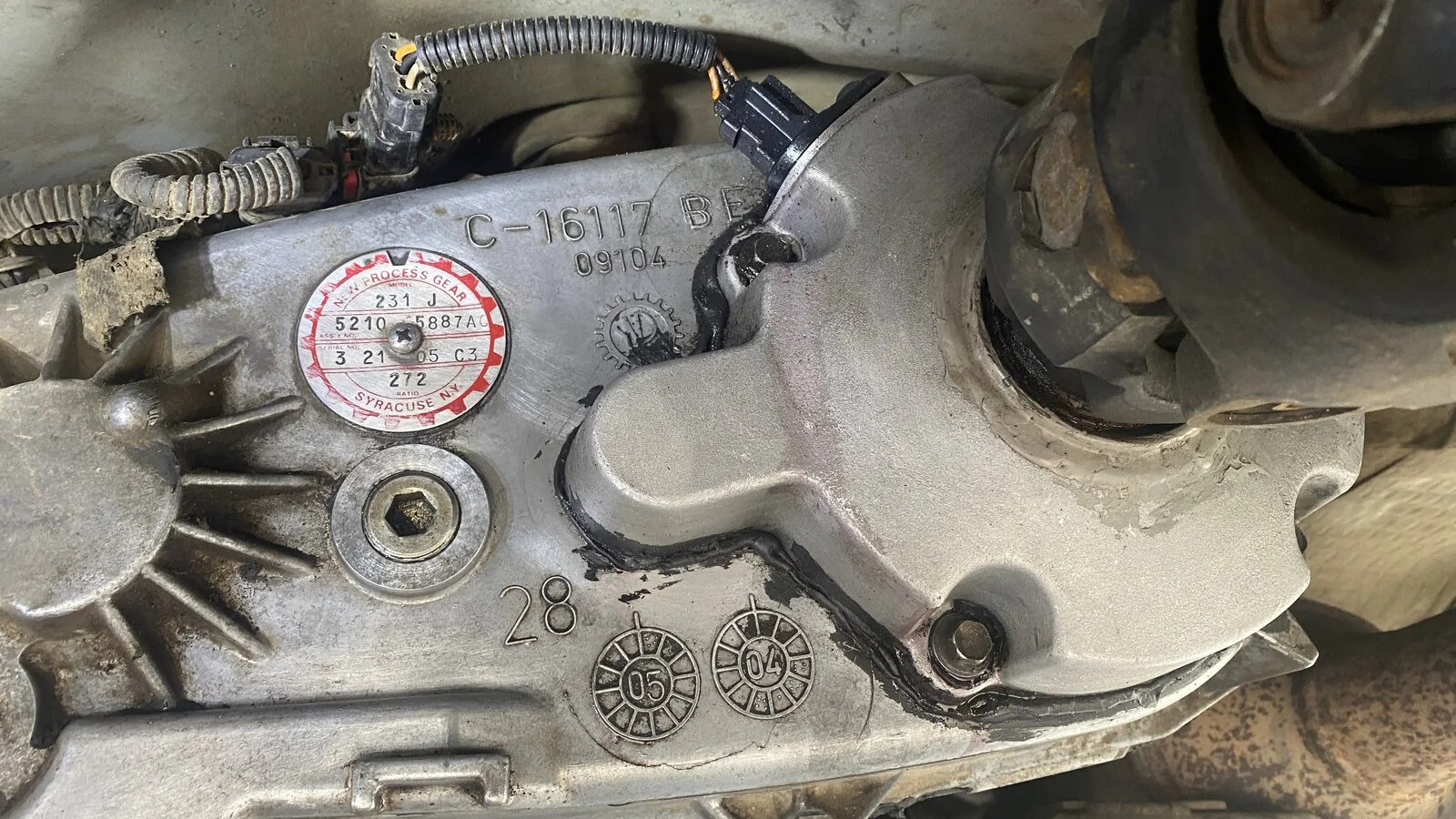

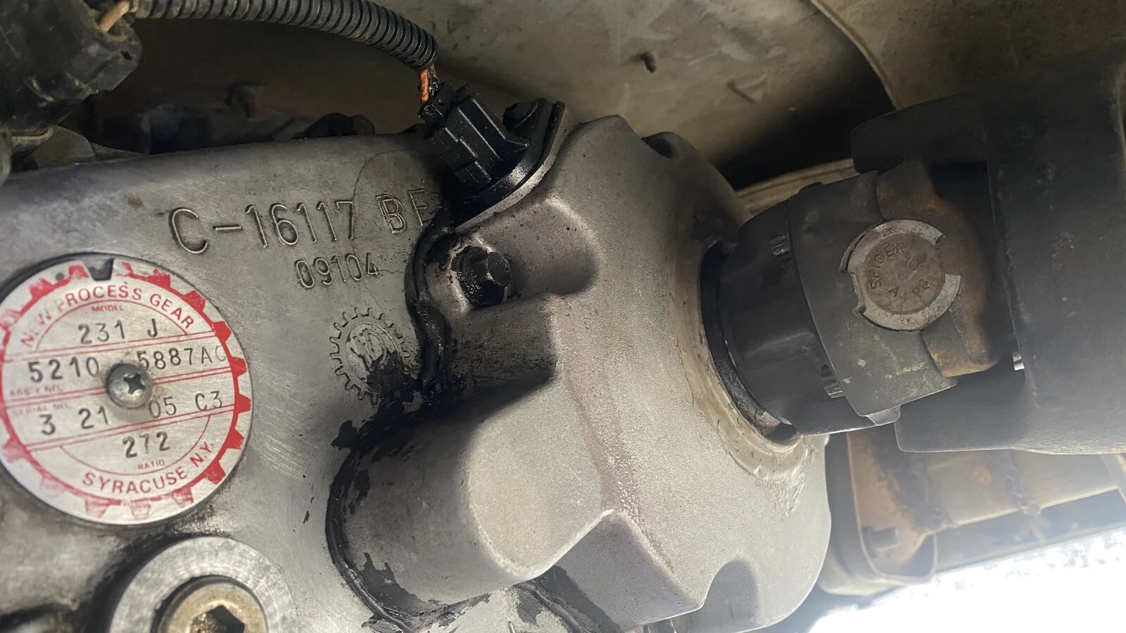

Back to business. I’m very glad I didn’t remove the TCase and split the halves without cleaning it all up and looking for the leak. I’m about 100% confident you can all tell where ATF is coming from.
The thing about those JB speedoheeler O-Rings is they’re crap. They really are too small, but try finding one with the same ID and a wall thickness that is just ever-so-slightly thicker. Every one I try won’t go in the hole. So, I wrapped some megalock (Teflon like material twice around the sensor, then put the O-Ring on and went for a 30 minute drive. Everything is dry now.
So, I cleaned up all the accumulated dirt and grime from the leak that was everywhere. Now I can get back to business with the raised body mounts. Driver side next. That will complete my project for February.

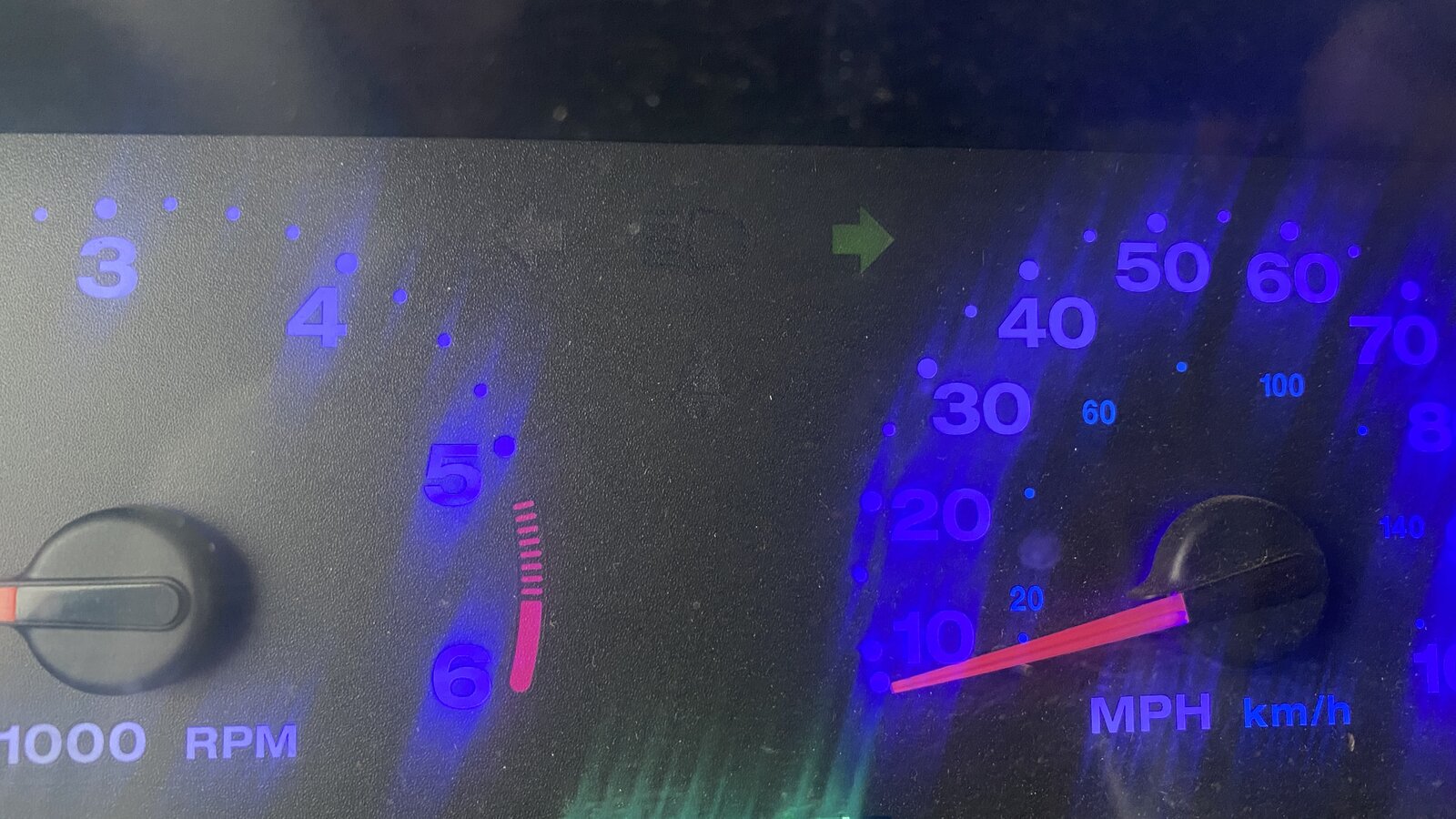

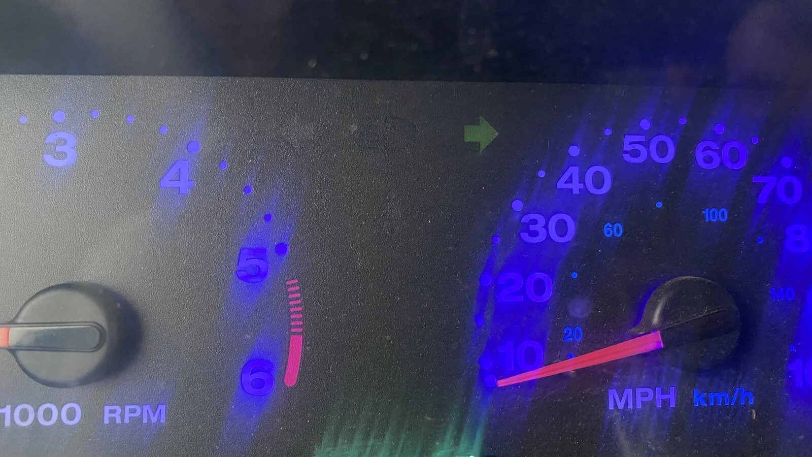

It is replaced now. Once I got it all together I expected the turn signals to work. They did, then didn’t. I tore it apart again and used some QD electronic cleaner and air to clean it all out. They worked, they didn’t, kept messing with cleaning. They work now, but the cadence of the turn signal is irregular. I cough it up to being 29 years old and poorly maintained. electrical system probably has corrosion. This kid doesn’t want to pay me $100’s of dollars to search for electrical gremlins. If they crap out soon I’ll replace his signal switch relay. It’s also a pain in the butt. Oh well, they work mo better than nothing.
Sounds like a bad ground to me.
Reactions: JMT
The replacement part looks like a stamped steel part not cast.
Reactions: JMT

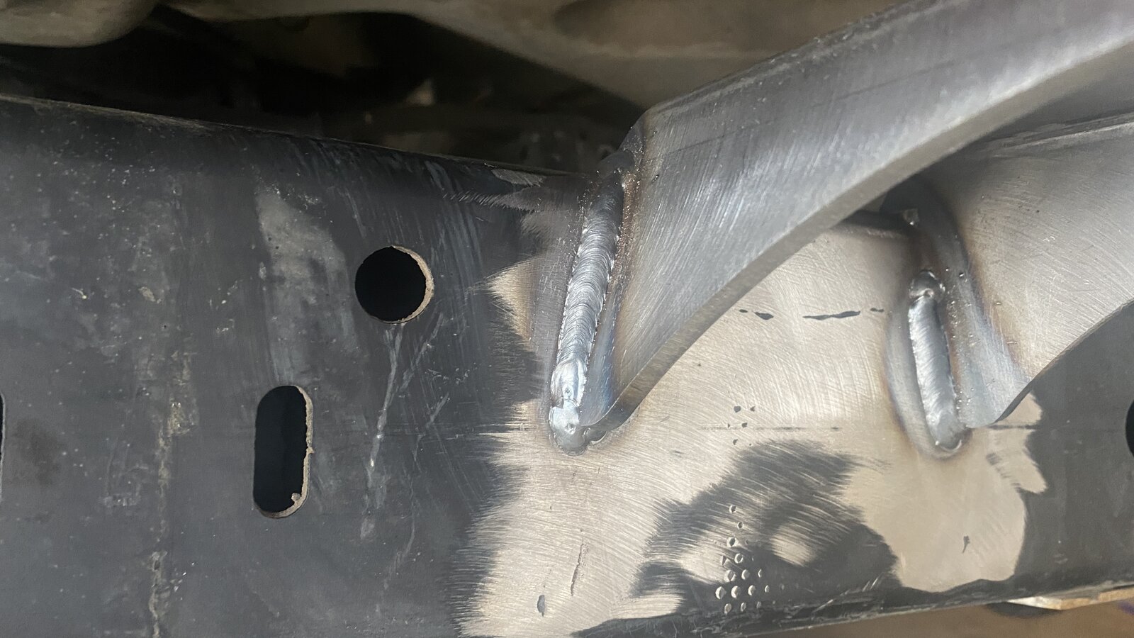

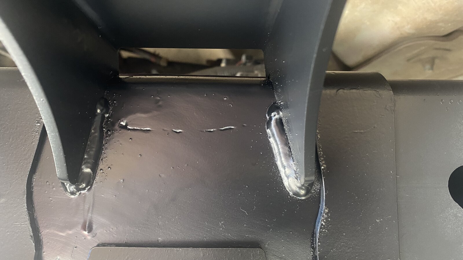

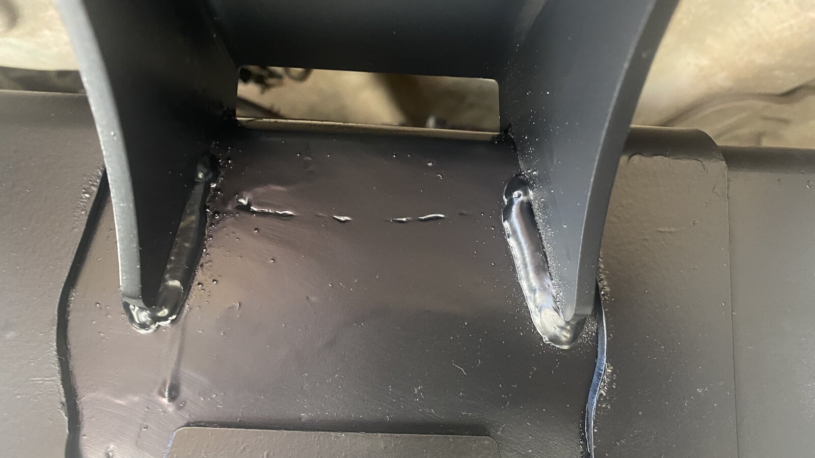

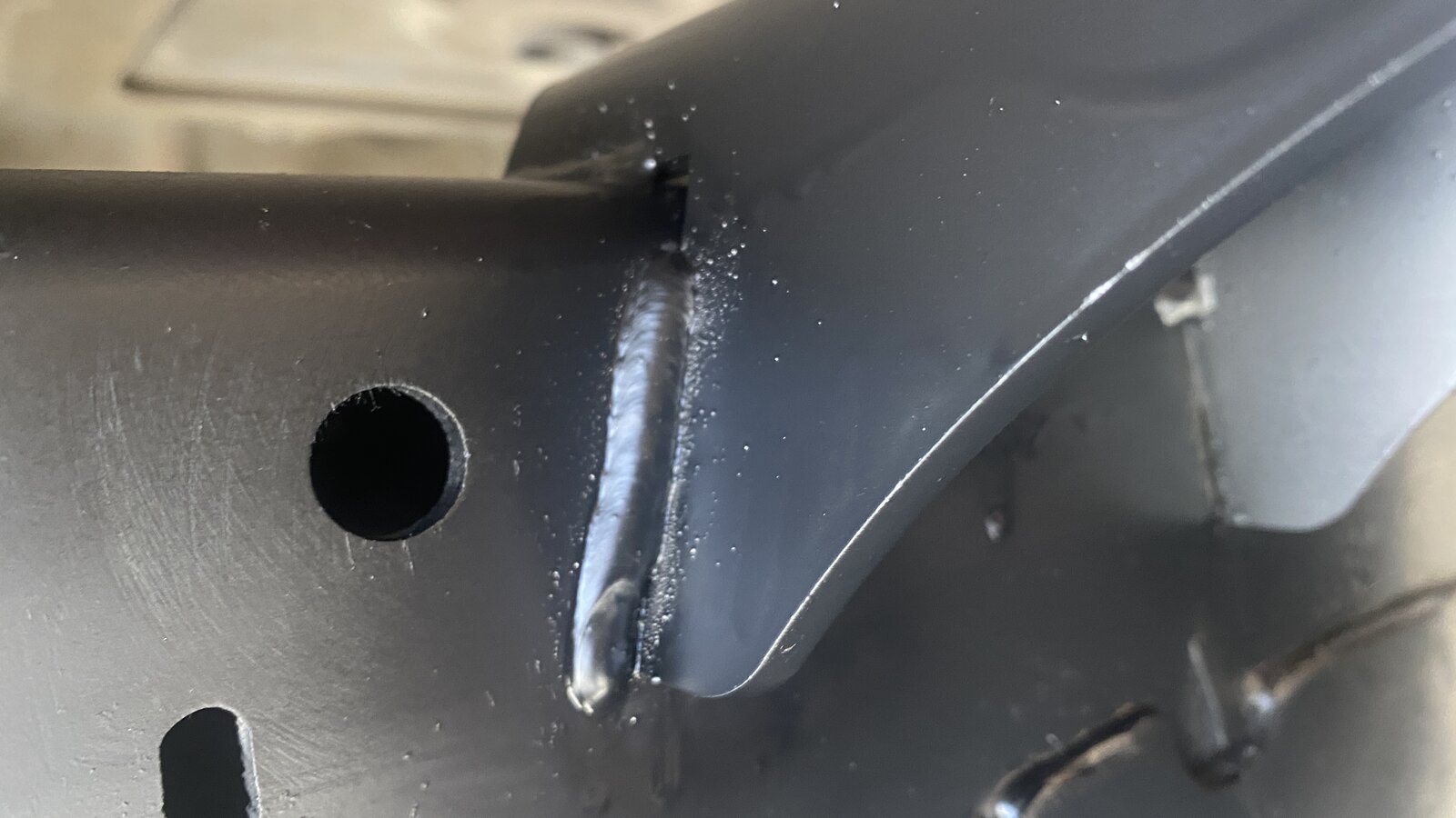

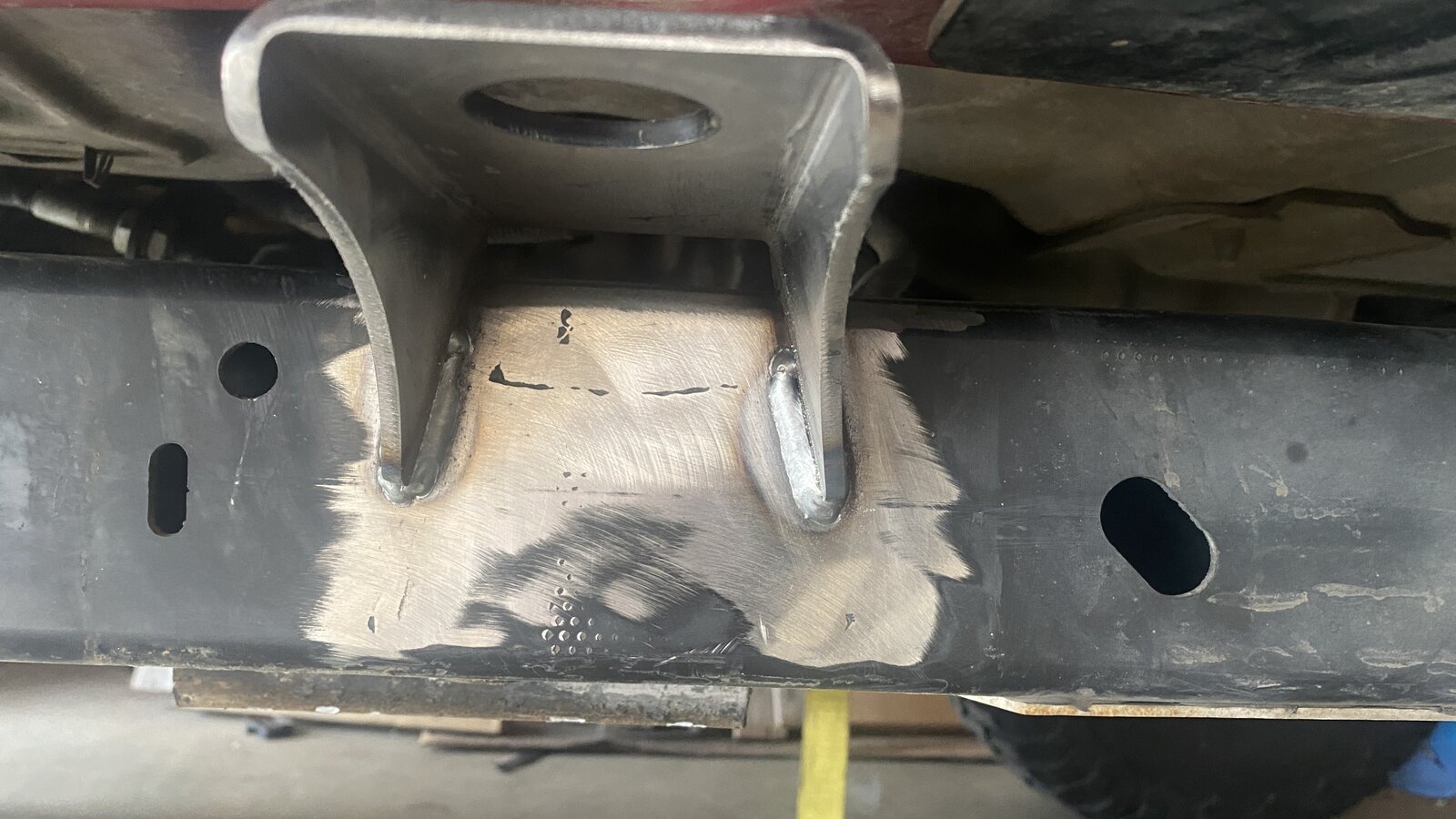

I think my welding is getting better. I still make some bad mistakes like come off the line as you can see in one photo. Fortunately, I only need 1/2” bead along each side. Fix my bad welding if you see 1, 2, 4 or 20 things wrong! I need all the help I can get!
I'm a Ray Charles welder like the rest of us, but are your welds hot enough?
