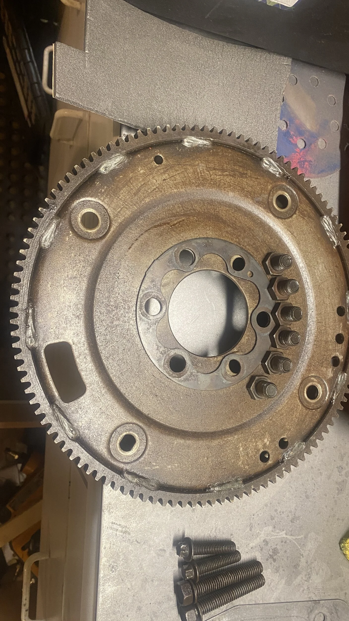

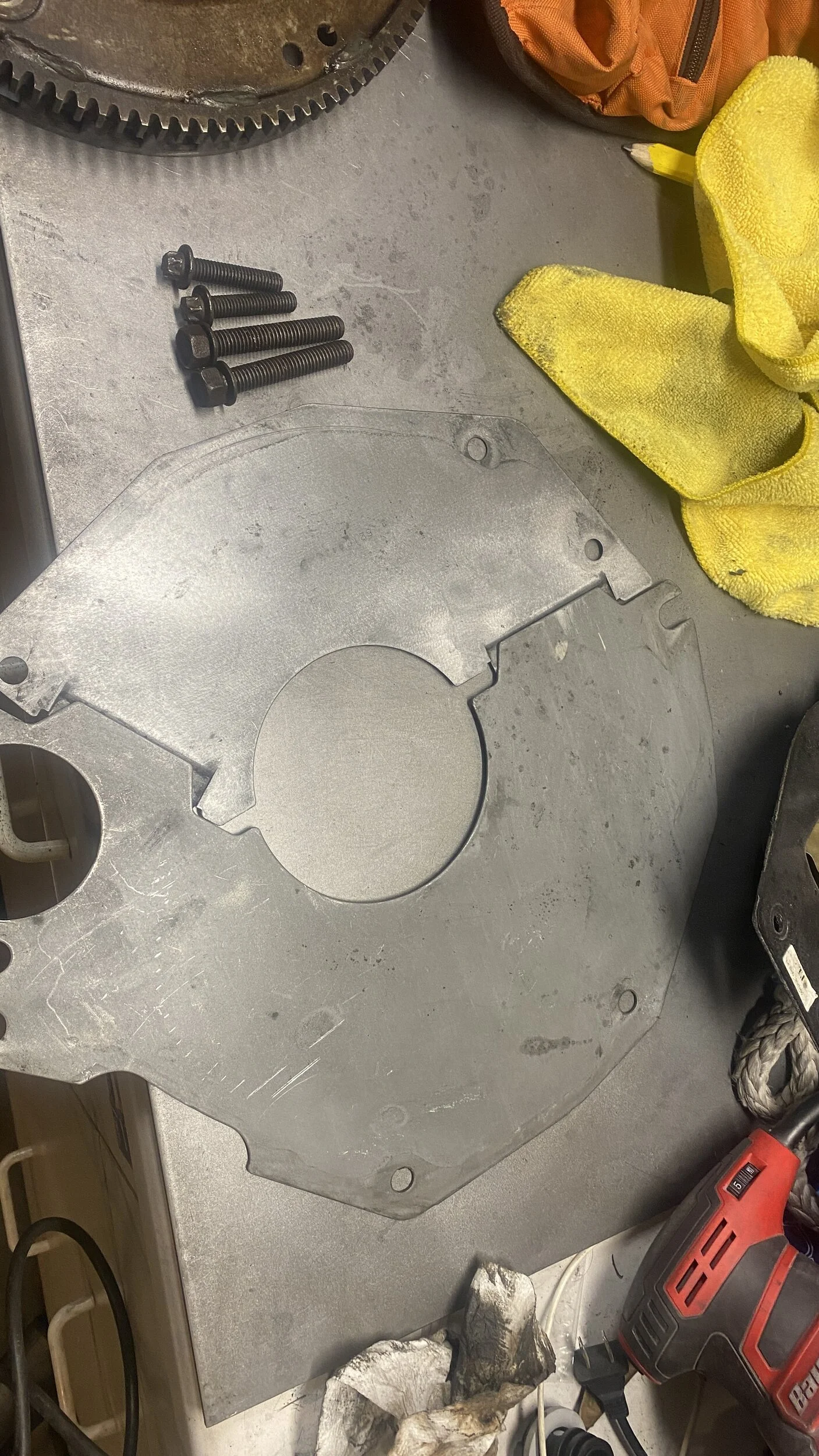

This is what I got with the transmission.
Flex plate with bolts
Dust shield

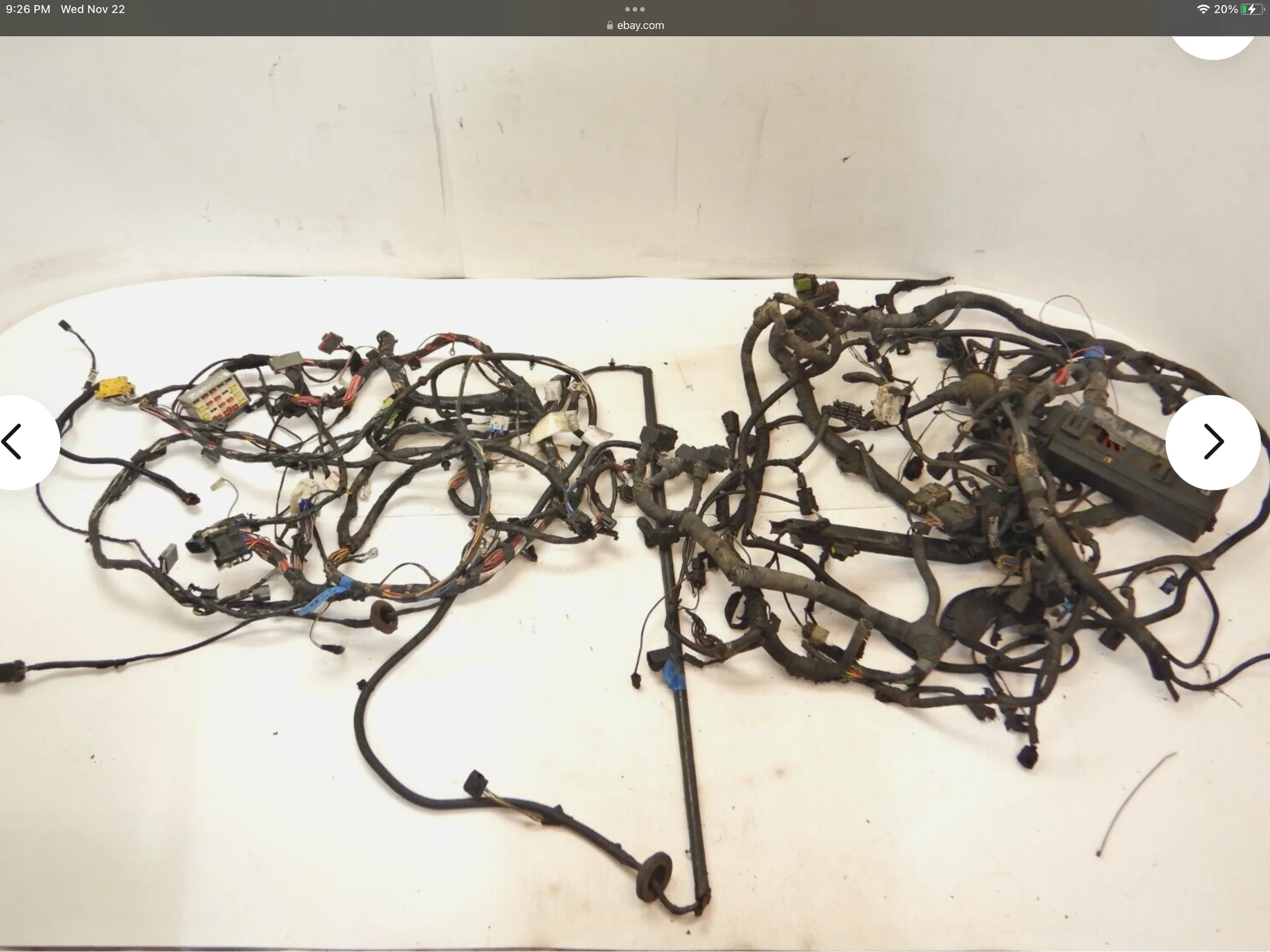

And this harness. It’s got two of the three (or four?) plugs to the computer. I have C1 (black/black) and C2 (black/orange) and am missing either C3 (black/natural) and C4 (black/green) or just the one I need. IDK at this time which of those two I need or whether I need both. I only have three harnesses in my current manual Jeep with the NSG370. I’ll research more after this post. This harness is from an 05’, which is the same year as mine. I laid it out and identified how it sits in the engine bay and identified a few connectors. Nothing is cut off, which I take to be a good omen.
It looks to me, upon further evaluation of the Connector Pin-Outs, that I need both C3 and C4. C3 has things like ASD Relay Control, Evap urge Solenoid Signal, Fuel Pump Relay Control, and Starter Motor Relay Control. C4 has the Transmission Control Relay Control and Output, Tow/Overhaul Overdrive Off Switch Sense as well as Transmission Temperature Sensor Signal and Speed Sensors. So, I think I need to source C3 and C4 harness. No idea beyond this.
Dust shield
And this harness. It’s got two of the three plugs to the computer. I don’t know enough yet to know which ones I have and which one I’m missing. I’ll research more after this post. This harness is from an 05’, which is the same year as mine. I laid it out and identified how it sits in the engine bay and identified a few connectors. Nothing is cut off, which I take to be a good omen.
Dust shield
*editing* because everything I just wrote sounds really negative and I don’t mean to be.
I don’t think that harness will work. The long leg goes back to the TC and fuel pump. If it was wired for an auto it would have all of the connectors on that leg and you would also have the black/green PCM4 plug next to the other two.
The fourth PCM plug (I think black/white) is the one for the PDC. You probably won’t have the necessary wiring in your current PDC which means you’ll be either adding a lot of wiring, or trying to source the correct PDC harness.
The flex plate bolts should not be reused. I believe they are torque to yield.
I don’t have my Jeep in front of me so I can’t remember exactly how the dash wiring ties into all of this. If you’re not up for the wiring it would be best to source the correct wiring from somewhere.
That’s exactly what I thought with the long leg. I counted the connectors on the transmission and then the ones on that leg, and there weren’t enough. Well, I’ll have to sell all this stuff and get the right stuff.

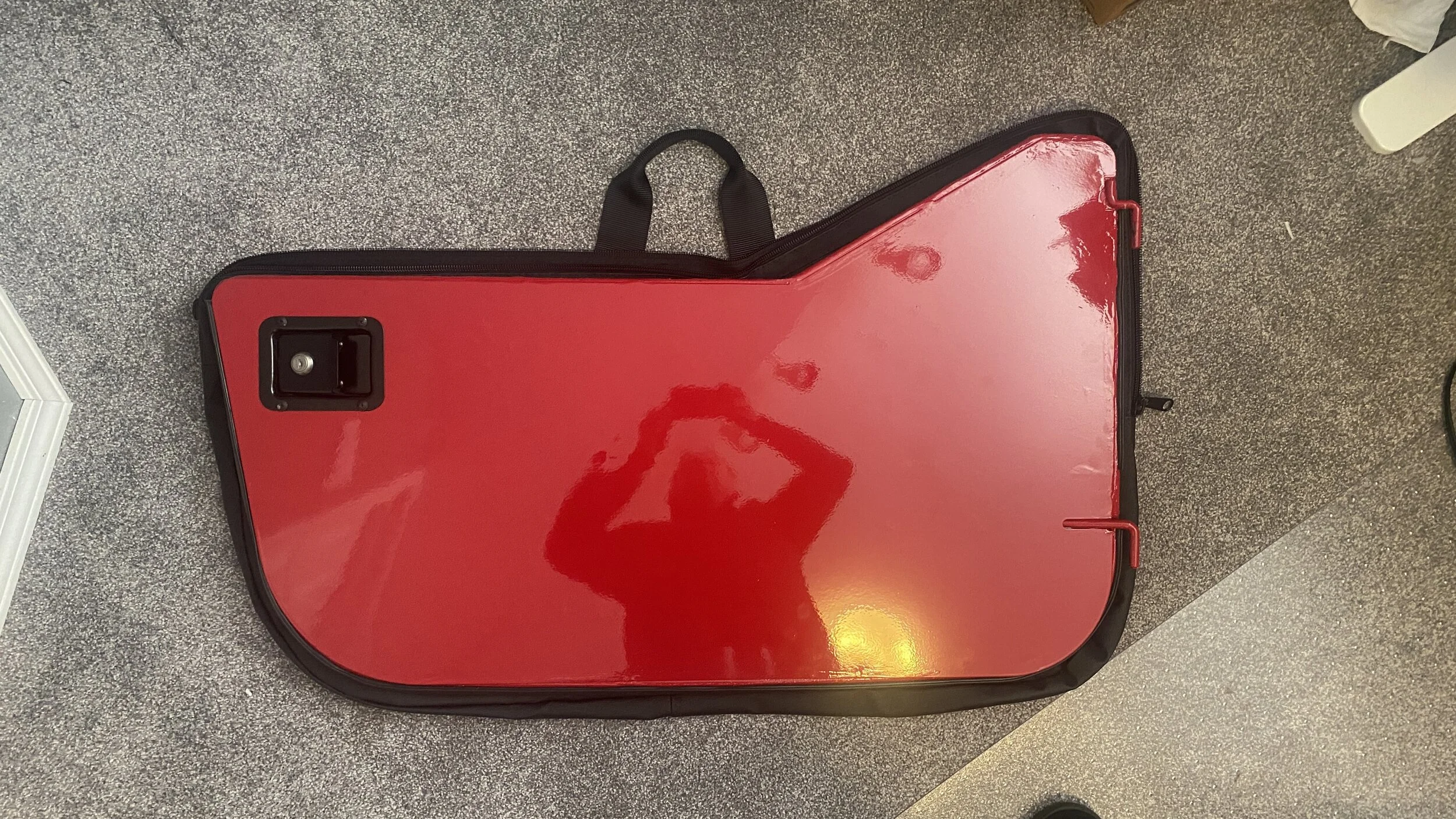

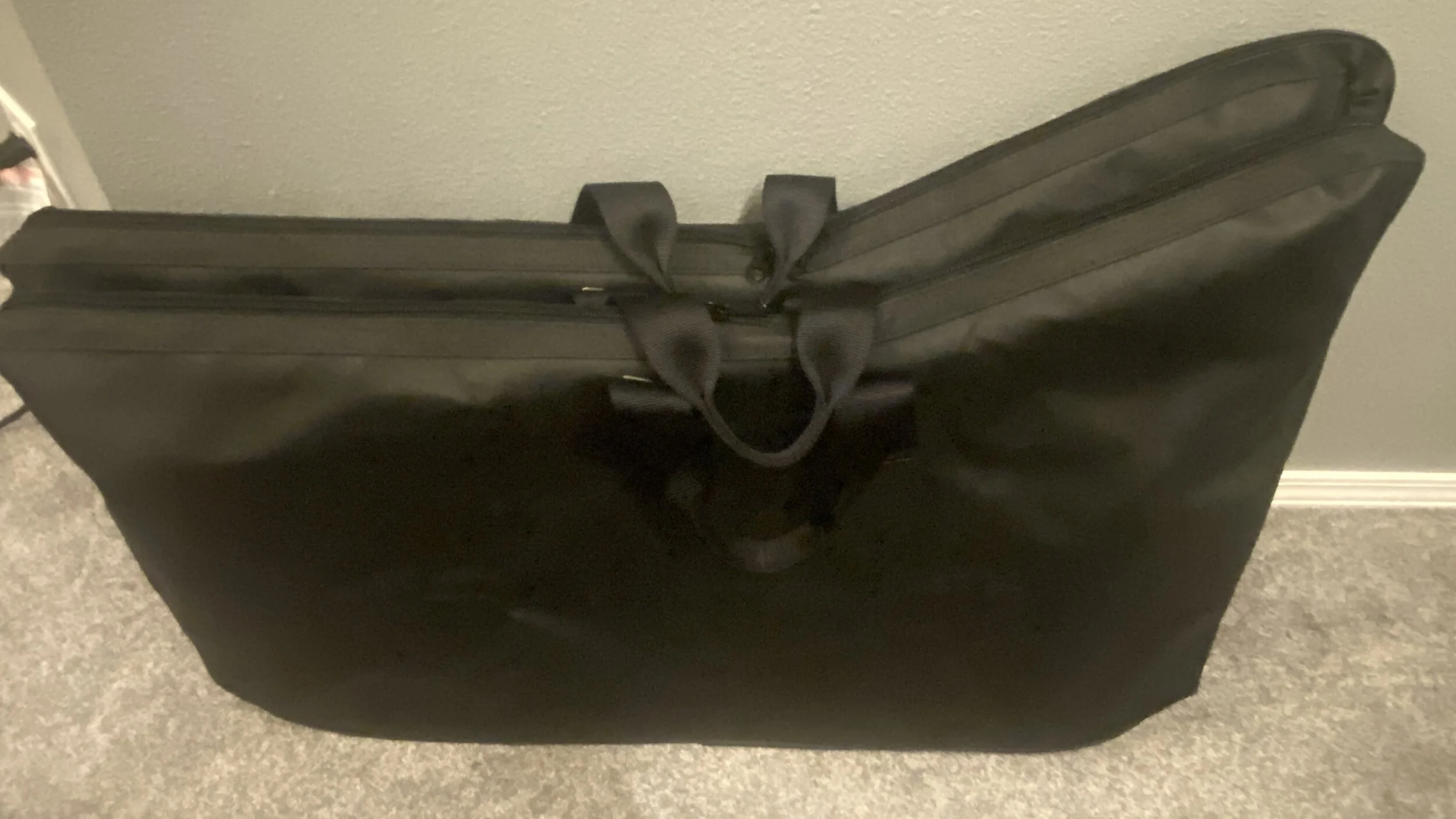

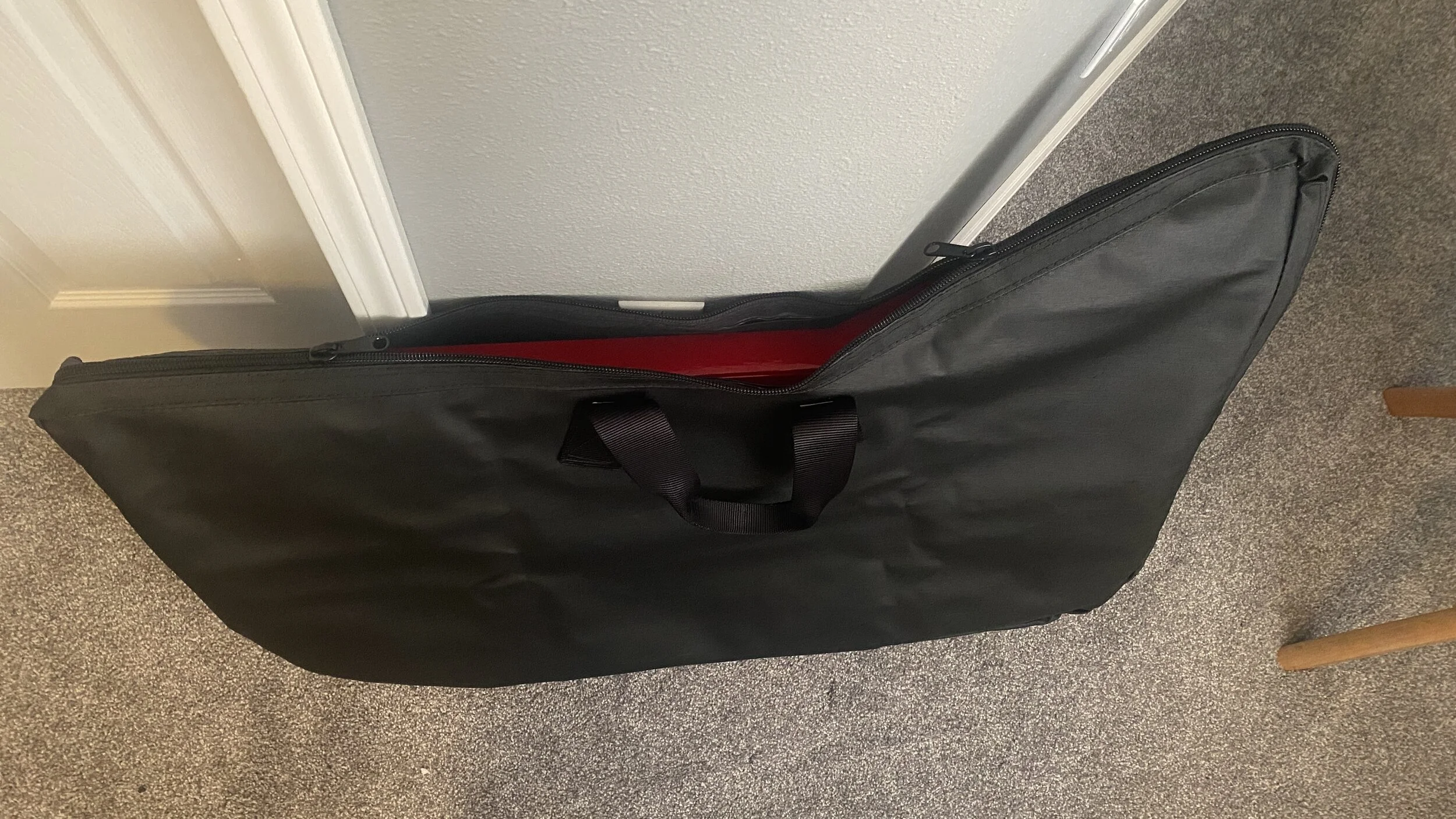

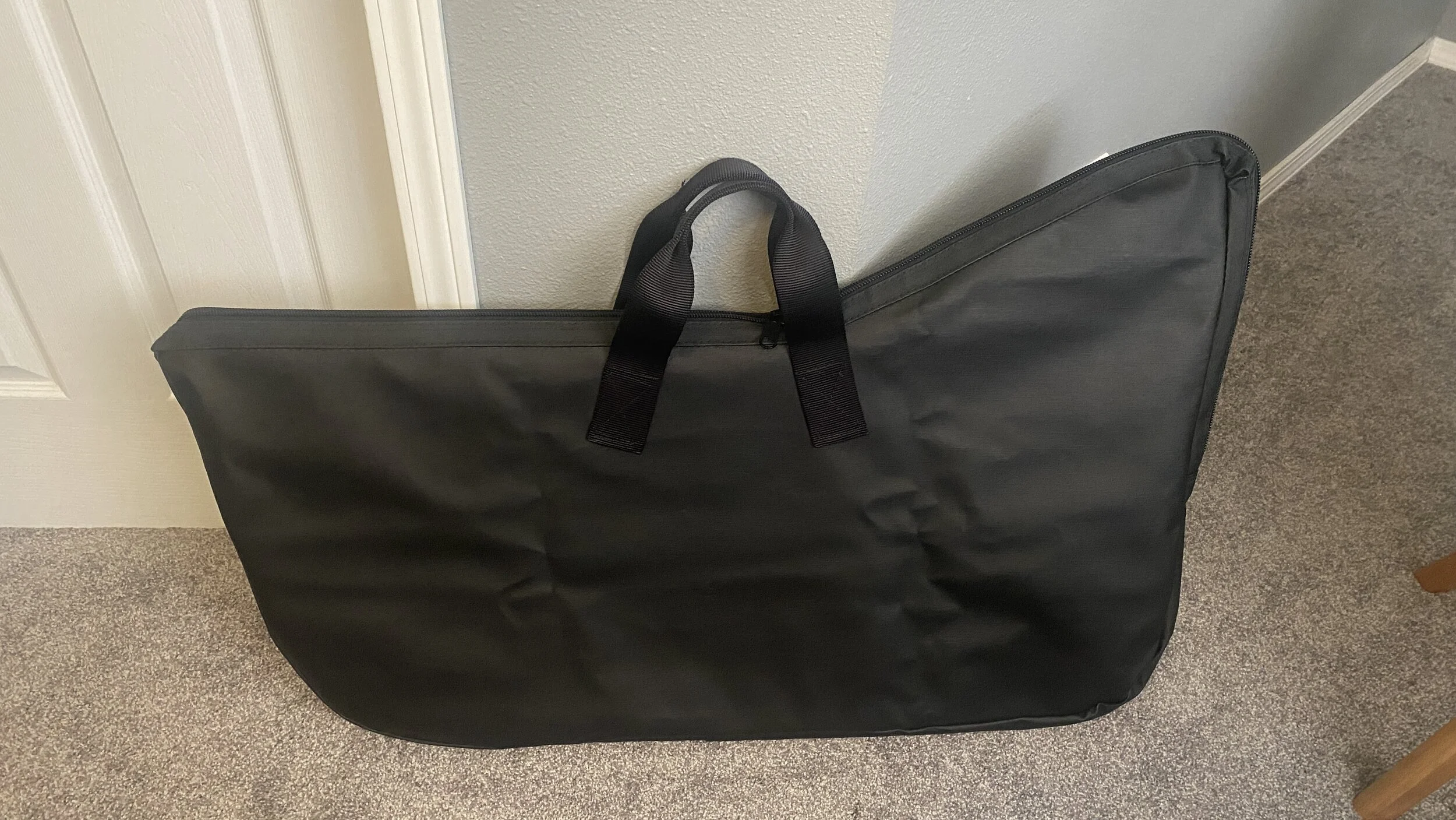

I got something really special today. These are just amazing. It's actually hard to believe. Jeff @NashvilleTJ went out of his way to make these. For those of you who know, Jeff took up a new aspect of the hobby this year; sewing. I'm still astonished every time I look at them. I gave him some measurements, and he asked for balance point and other small details. Out of that he designed and sewed these amazing half-door bags. I showed Kaleb and he was like, "What? That's crazy. Those are worth more than your doors!" I showed my other son Joshua and he said, "What? He made those? Those are better than professional. Those are sic!"
I was a little worried when I first tried to put the doors in the bag, but I really don't think if Jeff had the doors in hand he could have gotten a better fit. They're so beautiful and so perfect. I'm amazed at what a lot of you guys can do, the skills you develop in keeping with our diverse hobby. Tribute to Jeff. I hope it brought you as much joy to make them as it brings me to employ them. Cheers 🍻 !

Those look great. Jeff better be careful or he will be in the sewing business full time soon.

This worksmanship is ridiculously good. I wish these aftermarket suppliers put this care into the crap we buy.
NGL, when you said halfdoor bag I imagined storage for the door while it is installed. I am a little confused on why you need these doors to be portable lol
I will carry these doors wherever I wheel in good weather. I can’t wait to take them to Moab, the Rubicon, Fordyce, et. Al., They also allow me to store them during the cold, snowy winter months without worry. They are truly special. A perfect fit.

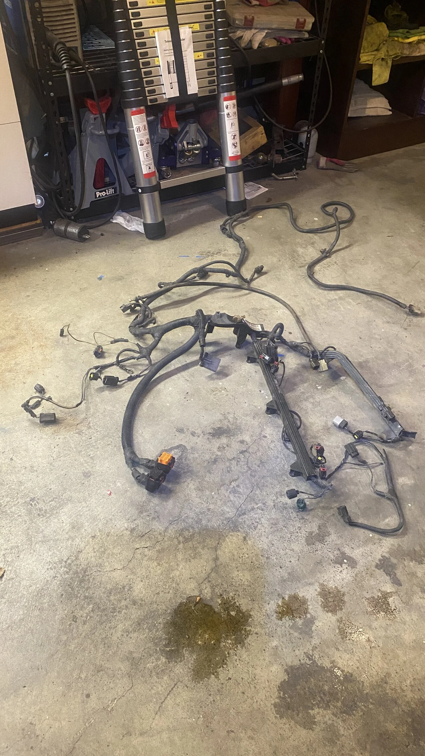

I’m taking the plunge. I ordered an entire engine and body harness from a 2005 42rle today. This was a major stepping stone toward the swap. It was kind of expensive, but I doubt these will be very common ten years from now. If I’m going to get the Jeep the way I want it, there’s no reason not to buy it.

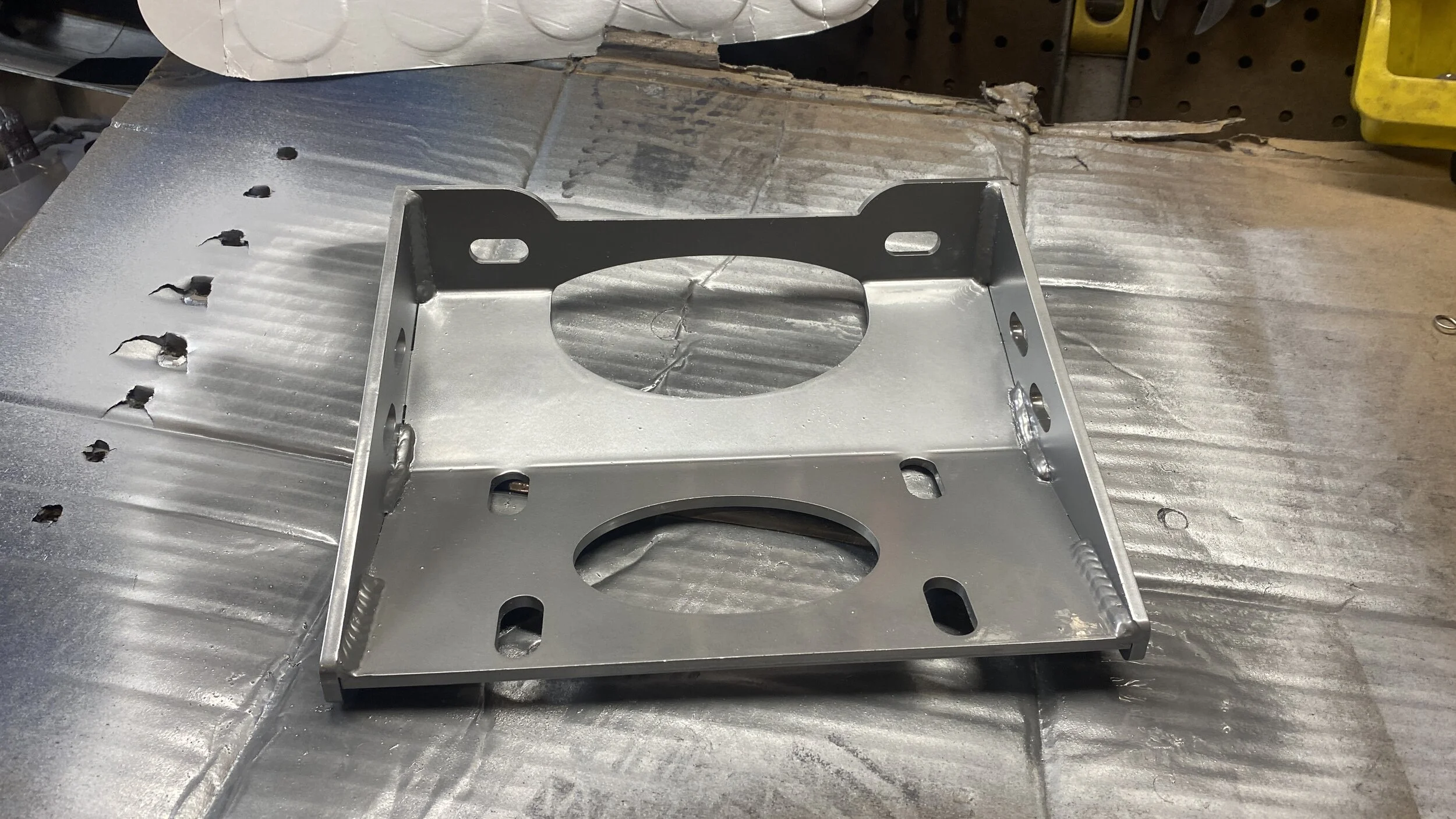

Also, I received the Savvy MUA auto transmission mount from Gerald. I gave it an extra weld and started painting it up. It will be several months before I need it, but at least it will be ready to go. Welds still suck. I‘d like to figure this out. It’s obvious which welds are mine.

You can't go wrong .. you have a 42RLE auto to use as a real time reference/guide!
  • Love
The other 42rle is my only hope. 🤣
I was whining to Blaine the other day about my fears. He was like, “Don’t you have an example in the driveway?” I looked over the example today. It gave me some peace of mind.
I’m also thinking that if this harness has all the connectors, I can go straight to Blaine’s 3/4” amber’s up front, and the new AL billets in the rear. It will be nice to clean things up. Lots to do.

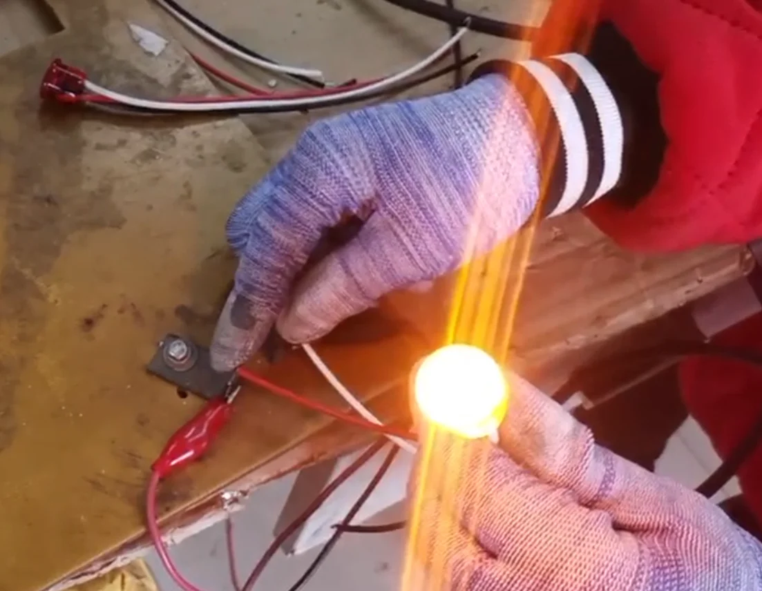

This is a friend testing a pre-production sample before @mrblaine decided to make them fully plug and play. Not sure what you are doing in your install, but this is a really very bright light for it's size. I think @rasband put a set in his Jeep, he can confirm how bright they are. The best part is with what's on the BMB website, you don't have to cut anything on the factory wiring side, they just plug right in.

Yeah mine don’t get as bright as in your pic.
I just did some playing around, and they get brighter if I plug in the small light bulbs for the side markers. I’m using the GCD flasher, going to try the Novita LM470

I must be doing something wrong, since mine are “just ok”. I hope it’s a flasher issue.
Just okay for anything I deal with is never acceptable. If these were not the brightest marker lights I'd ever seen and I had more samples here and have installed more than anyone I know, then I would not sell them, period.

It's difficult for me to quantify the brightness, as I haven't tried any other marker lights. They're brighter than the tinted stock-type turn signals I had, but not as bright as others' pics make them out to be.
^^ I mentioned this in my earlier reply. To me it seems counterintuitive that adding resistance (side markers), increases the power (brightness). Could this be flasher related?
