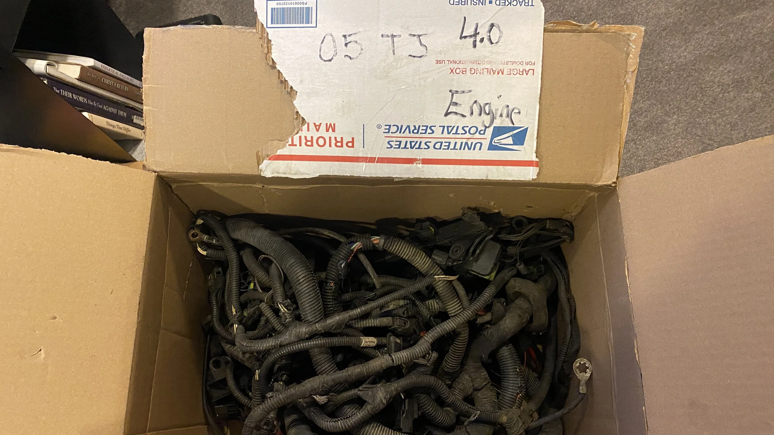

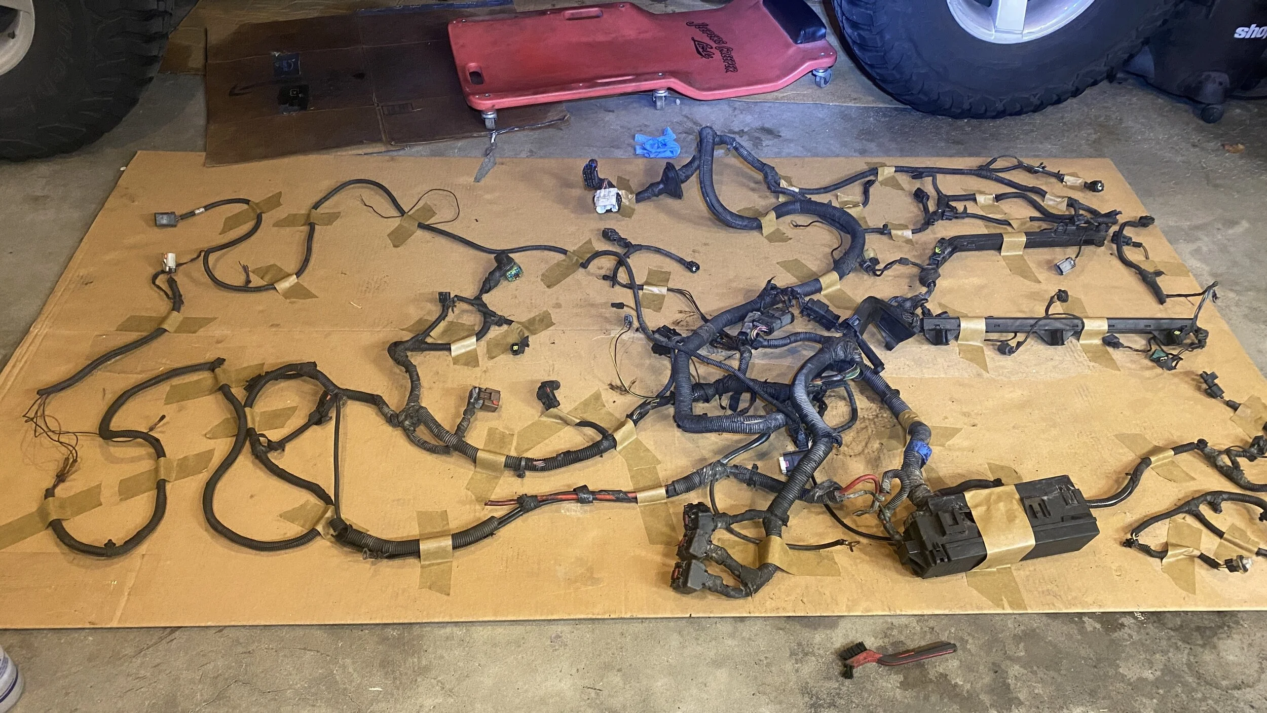

I need to get my harnesses delivered so I see if they have the original connectors. I’ll also be checking the rear for connectors so I can get a new set of the AL Billet rear tailights. Just a matter of time. I may need some more things. Hopefully it will all be there and I can order it all at once. My projects involved with the transmission swap are legion. It will be good to fix several things that I haven’t gotten too, but this is a good opportunity because I’ll be there anyway.

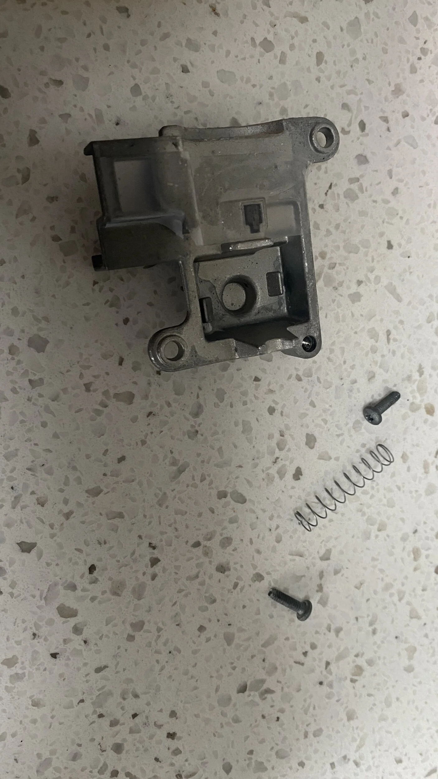

Thanks to @Mike_H for sending me these small parts for the shift interlock cable behind the ignition. 🙂

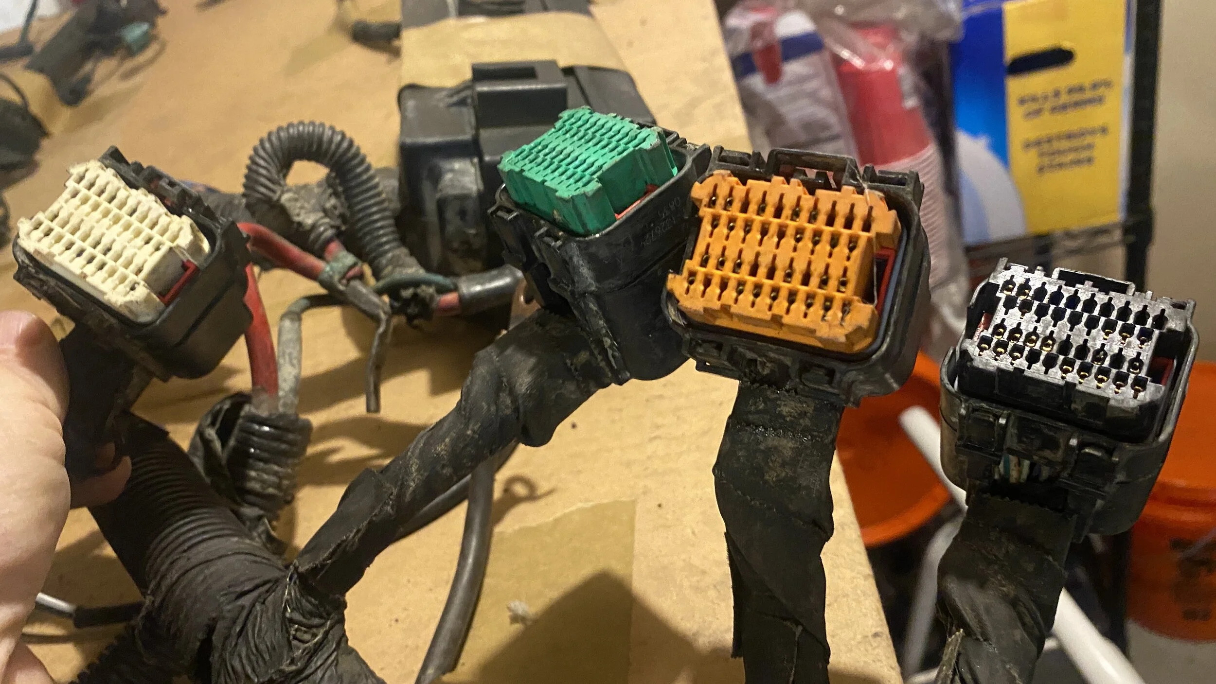

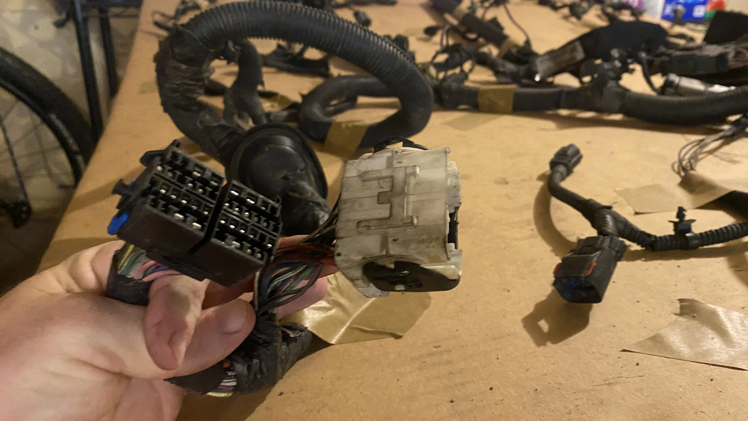

Got the harness all laid out.
Several connectors missing, one is not OEM. At least the transmission connectors are there.
What I’m confused about is the 2005 FSM lists C3 as Black/Natural, but mine is Black/White.
It looks like these go to the dash harness, but with no OD connector I still need that harness. 🙄 The description of the item sounded like it included that.
All laid out and identified some stuff.
Good luck. I did find a couple errors in the FSM in my project, with the differences between an 03 and an 04. What helped me think through those and figure them out was downloading the preceding and next year’s service manual and looking at the same connector in those manuals.
Thanks. I’m sure I’ll be asking for your insight.
For now identify the connectors I’m missing and get new loom and tape to fix everything that needs fixing.
A very helpful thing to do is label both ends of each connector on your existing harnesses as you unplug them. Then lay those harnesses next to the new ones and label those connectors using your code. The labels can be the device name or a number/letter/animal code. Anything that helps you quickly identify and match up each end of the connectors.
Pictures of the out of reach areas or odd routing will help by creating a check list. I lost track of one of the connectors in the engine bay and couldn't find it for a long time until I called Blaine, described the connector and what area it belonged to. It ended up being for the AC compressor which was out of sight and difficult to reach.
It will help if you can find a copy of your TJ year's wiring manual in book form. Or atleast print it. The book is nicer to use than stapled printouts. PDFs kinda suck for this type of stuff.
I got the entire set of books on ebay a few years ago for not too much.
