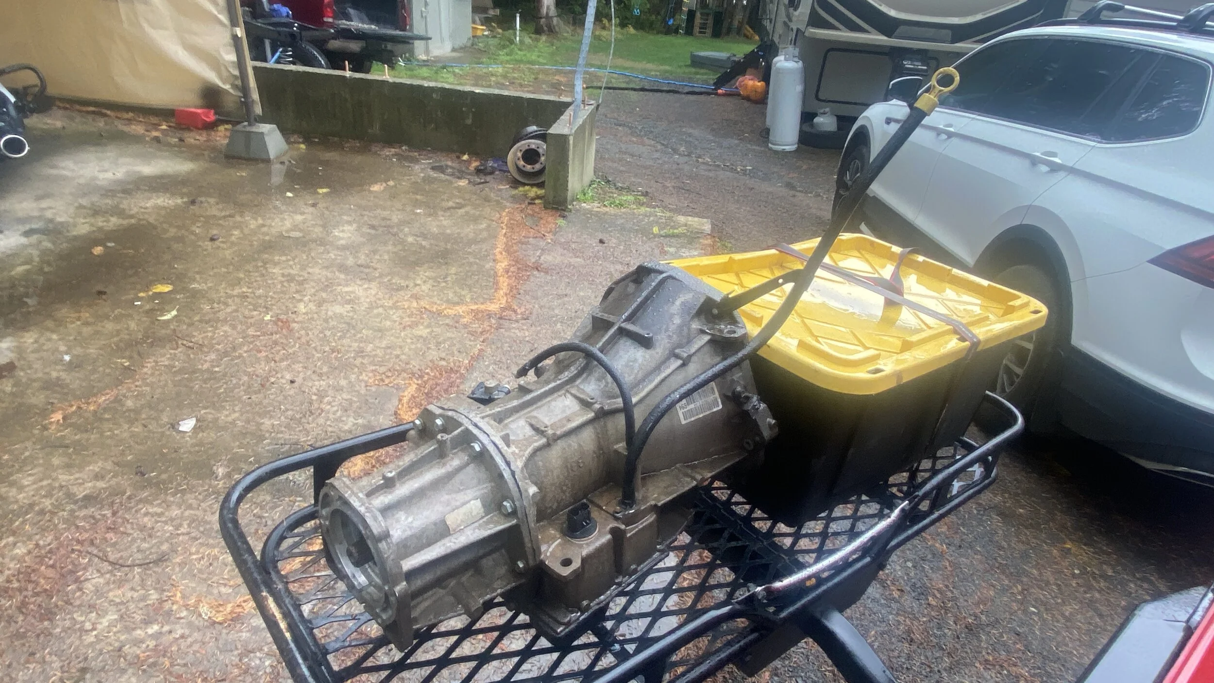

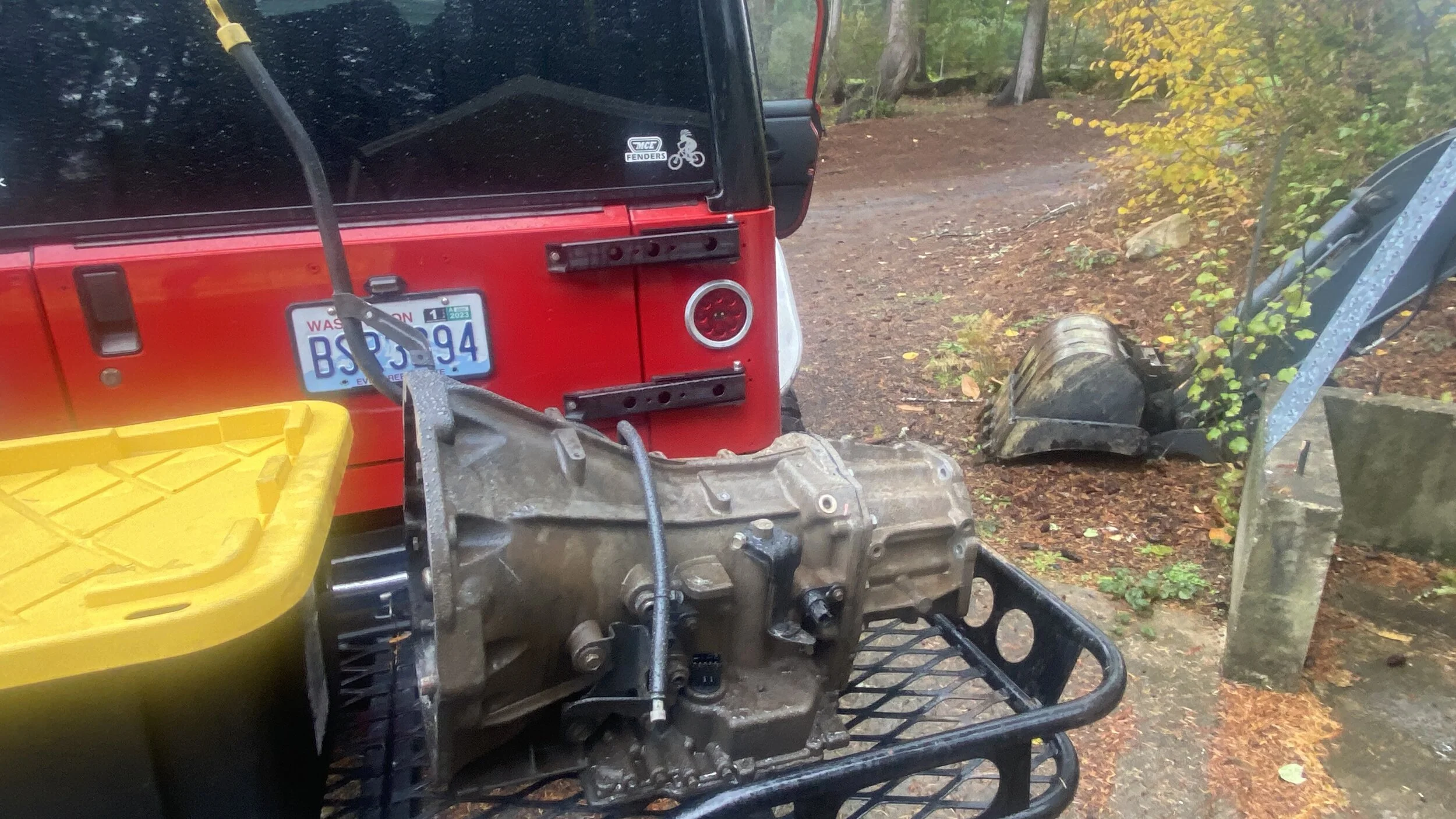

I’m off to pick up the 42rle and do a little wheelin at Walker.
