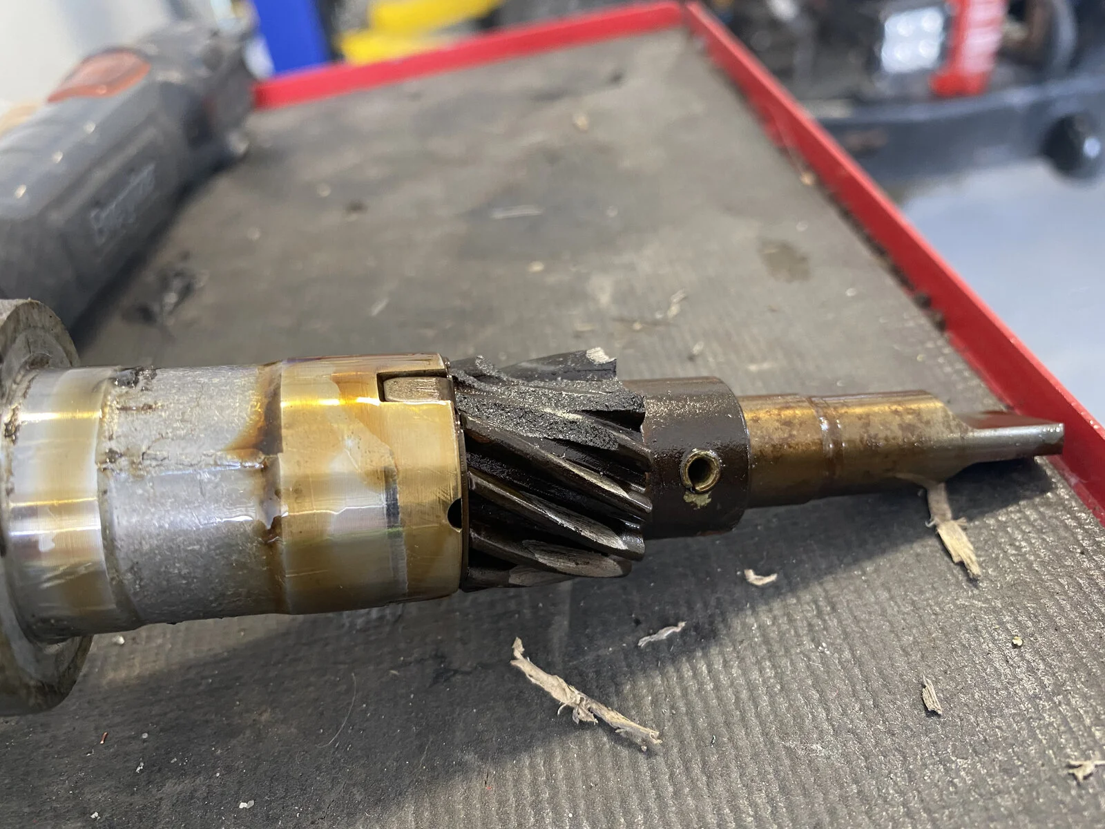

@Daz7 @JKP Thank you both for your input/tips. I already knew that the OPDA did not spin so I took it off and my suspicion was confirmed. The corresponding gear on the camshaft wasn't as bad as the OPDA but it is toast. I had already drained the oil and still have it and the filter. I will check both for particles.
I am somewhat hopeful that because the OPDA shaft "froze" before the gear detonated, it did not continue to turn the oil pump. Obviously my minimum is a new camshaft. I'm severely bummed but..... I've always been curious about pulling a motor. 🥺
At a minimum you'll need a new: cam, lifters, OPDA, timing set.
Unfortunately you have to pull the head to get the lifters in/out.
All the above can be done with the engine in the Jeep.
Check out the FSM under Resources for R&R procedures and for proper cam/lifter break in procedure.
Drop the oil pan to get the pieces out of it. You can also inspect the bearings by pulling a cap or two.

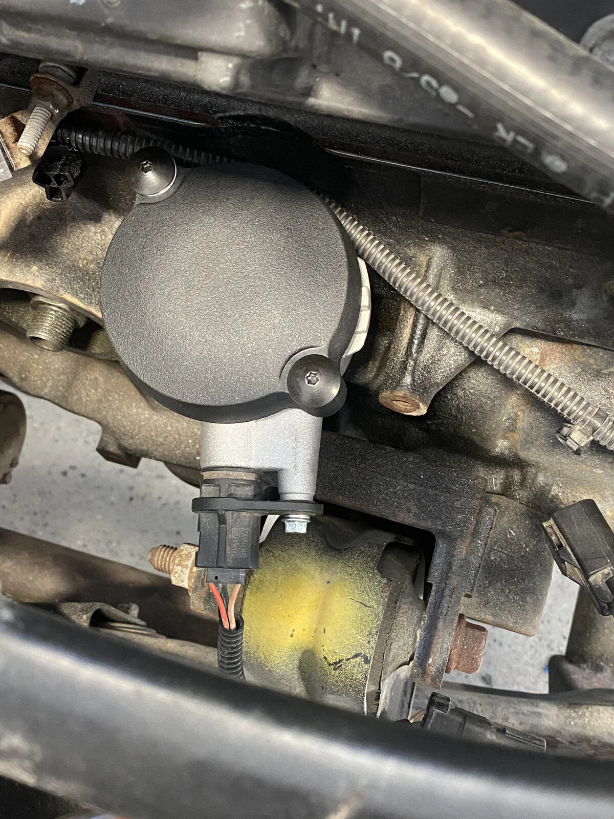

I've set the engine to TDC (compression on #1) and installed the new Crown OPDA but using the original timing sensor. I've got the flange at the end of the OPDA shaft seated in the "receiver" for the oil pump but am wondering about the positioning of the OPDA. I don't recall how it was positioned when removed. As long as the timing is correct, does it matter? Can anyone confirm that the position in the photo seems correct?
Many thanks again!
Can't tell anything from that pic. Take the cover off. There are alignment holes in the disk and the housing that need to be aligned with #1 @ TDC.
Thanks @g.hayduke I know that the holes are aligned because the plastic pin is still in place. I was told I could leave it in and it would just shear off when I start the engine the first time
The OPDA should be clocked to about 4 o’clock when fully seated. When installing, it will rotate as the teeth engage. Take it out, rotate a bit and put it back in until it is closer to 4 o’clock.
Once you have the OPDA installed and the retainer bolt tight, it's not going to rotate so there is no point to leaving the alignment pin in after that.

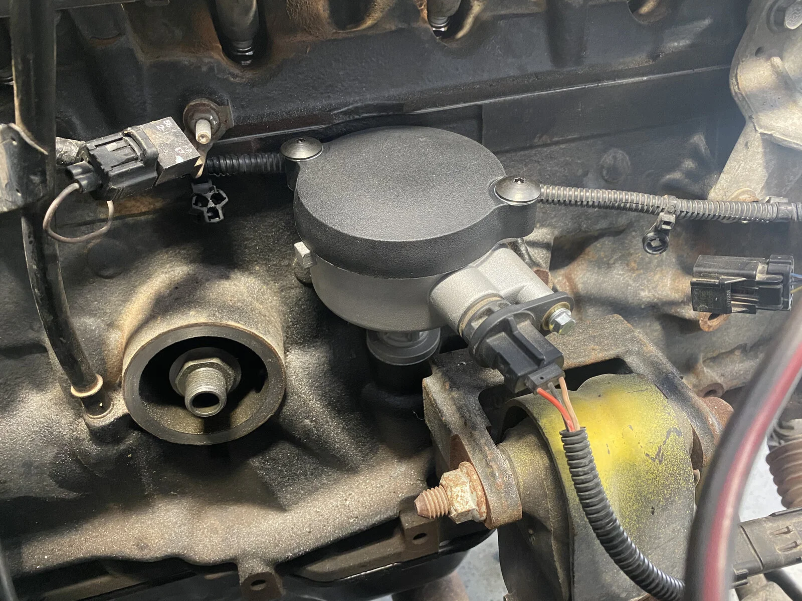

@AjRagno I agree with 4 o’clock because the retaining bolt was nearly impossible to reach when I removed it because of the “arm” of the OPDA. My concern is that the shaft now drops easily into the oil pump because of how the slot is aligned. Does it make sense to try to turn the oil pump manually before installing so that I can get closer to the 4 o’clock position?
Thanks for your insight!
Yes, turn the oil pump. If you get P0016 after after it’s up and running, you can loosen the retaining bolt and slightly rotate the body to get it synched.

I’d replace it. Pretty cheap insurance to install the Crown unit. I did it and it was a super easy job. I did use a marker to mark the old housing to the block. Pulled the old unit, laid it next to the new one, put a mark on the new one with a marker that matched the old one, then dropped it in. I did need to turn the oil pump a little with a long screw driver so it would drop in and align properly. Extremely easy job. Taking my time I was still done in 30 mins.
A distributor hold down tool makes it a lot easier to remove and tighten the bolt.
